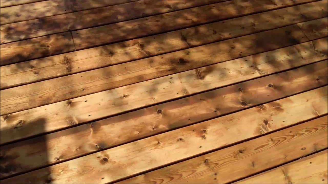

Type of wood: Pressure treated lumber (?)
Chemicals used: 2.5% SH, Citric acid (1 cup per gallon).
Process: Pre wet wood, apply SH using a 12v pump, dwell for about 10 minutes, medium pressure rinse (1000psi), applied SH again, dwell for about 5 minutes, medium pressure rinse again, post treat with Citric acid, low pressure rinse off Citric acid (no pressure required).
Note This deck was bad, applying SH and medium pressure rinsing twice is not the usual process. It was however necessary to clean this deck.
Time: About 3 hours including set up and packing up.
Cost: I only ended up quoting my minimum charge of $189.00+ after meeting this customer. Though he lived in a nice house and area, he was going through some very unfortunate times with his son being sick and explained how he didn’t have time to do it himself and his wife wanted it done. At that point I just told him my minimum charge and set up a date.
Area: Southwestern Ontario, Canada.
