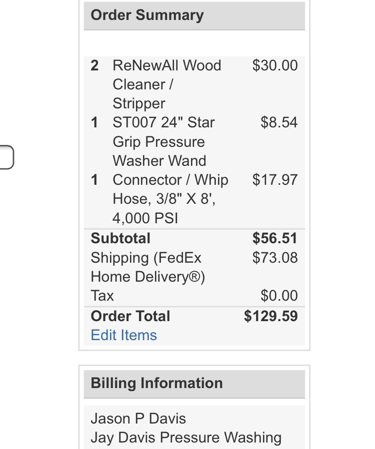

$73 for shipping? Is this right, still newbie when it comes to getting chems shipped
Haha, the other day I wanted to order some stuff from there and shipping was $184
I called and they ran the order, 2 gallon jugs of Snotmenade was like $35 shipping. Still high but way better than $184.
I would give them a call

Haha thanks! Thought it was weird just got 5gal of Red Raider delivered today from them & the shipping was around $25
Yes shipping is high but after I placed order they took $16.00 off my shipping said I over paid on shipping

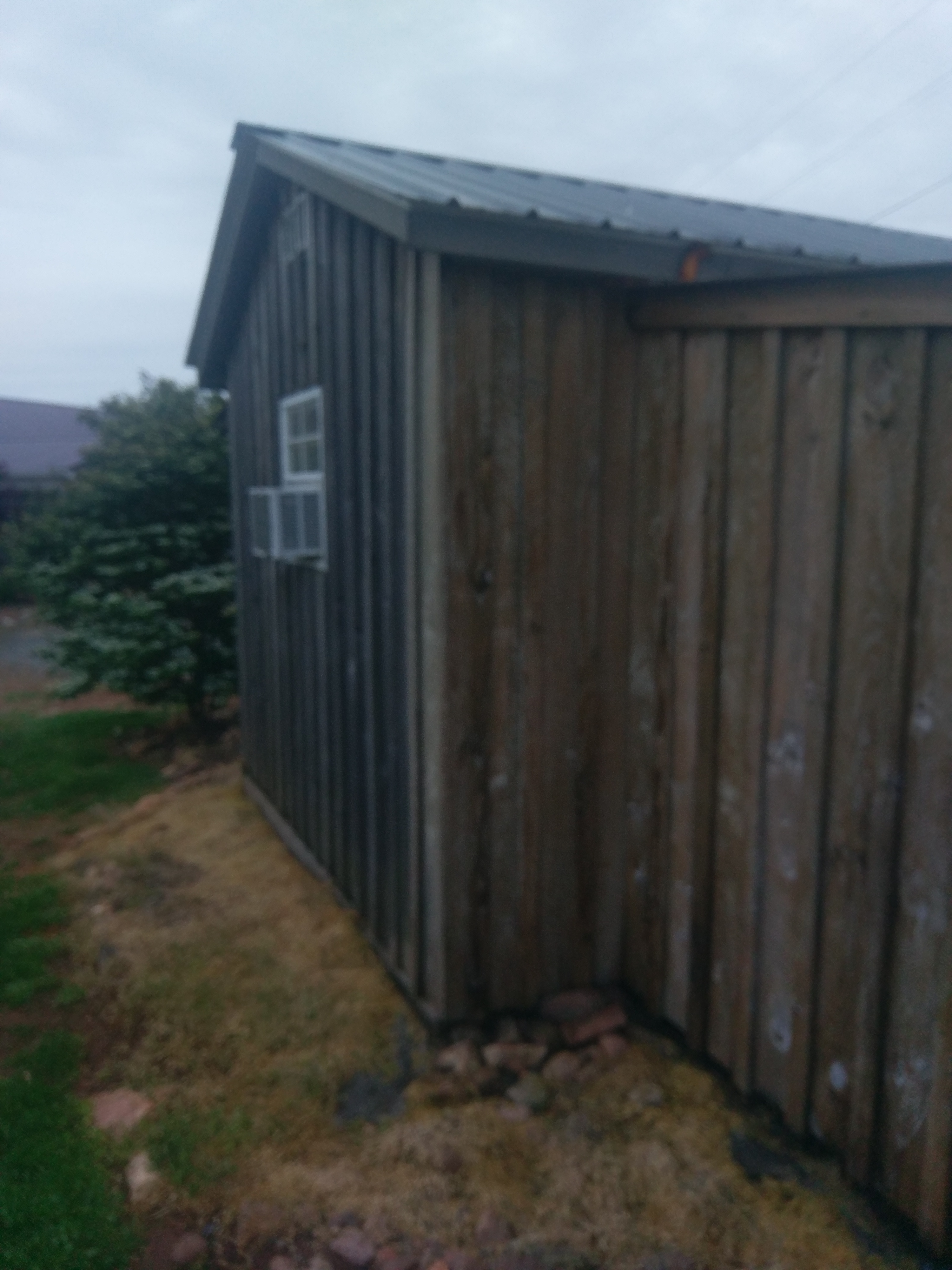

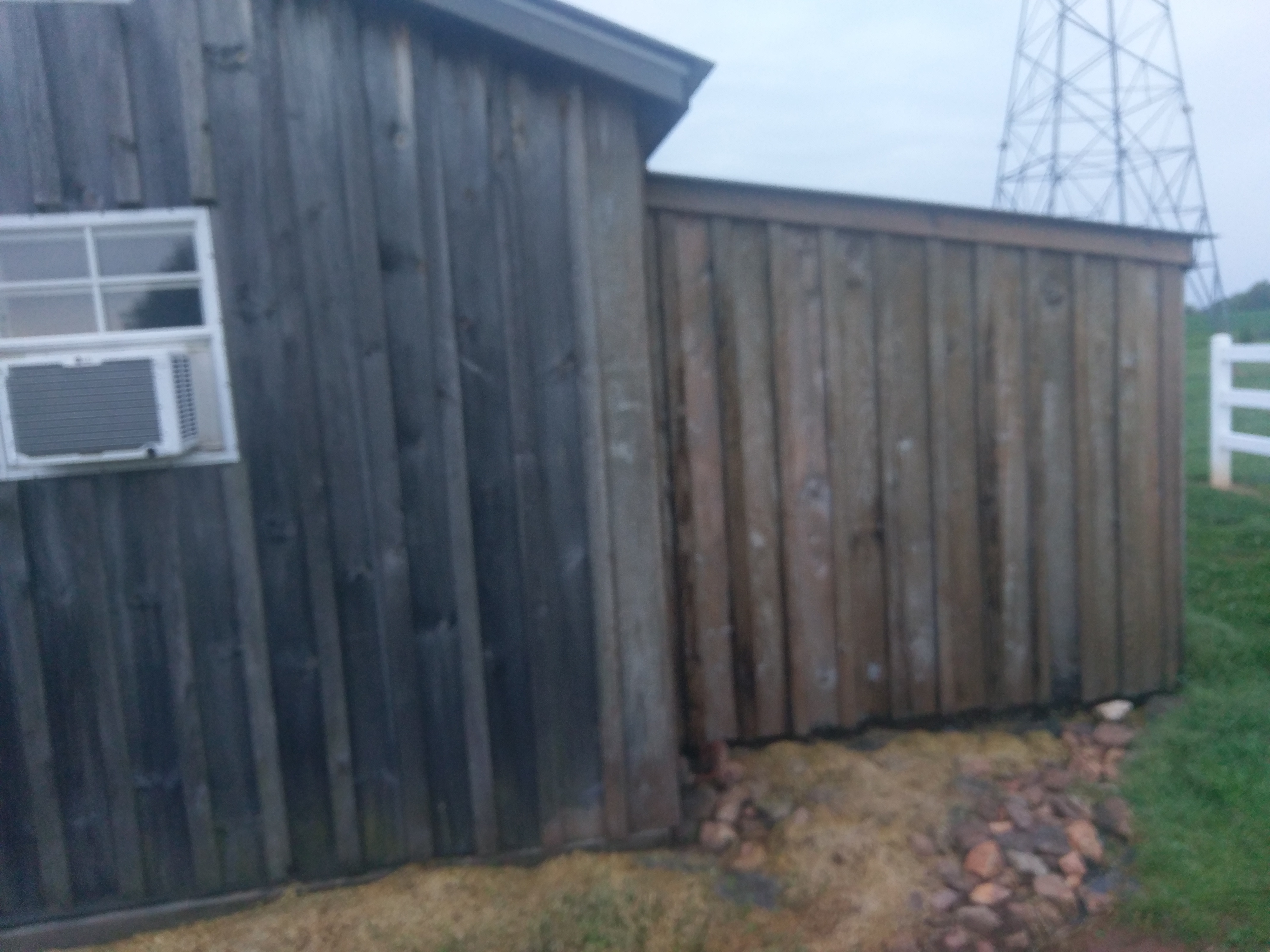

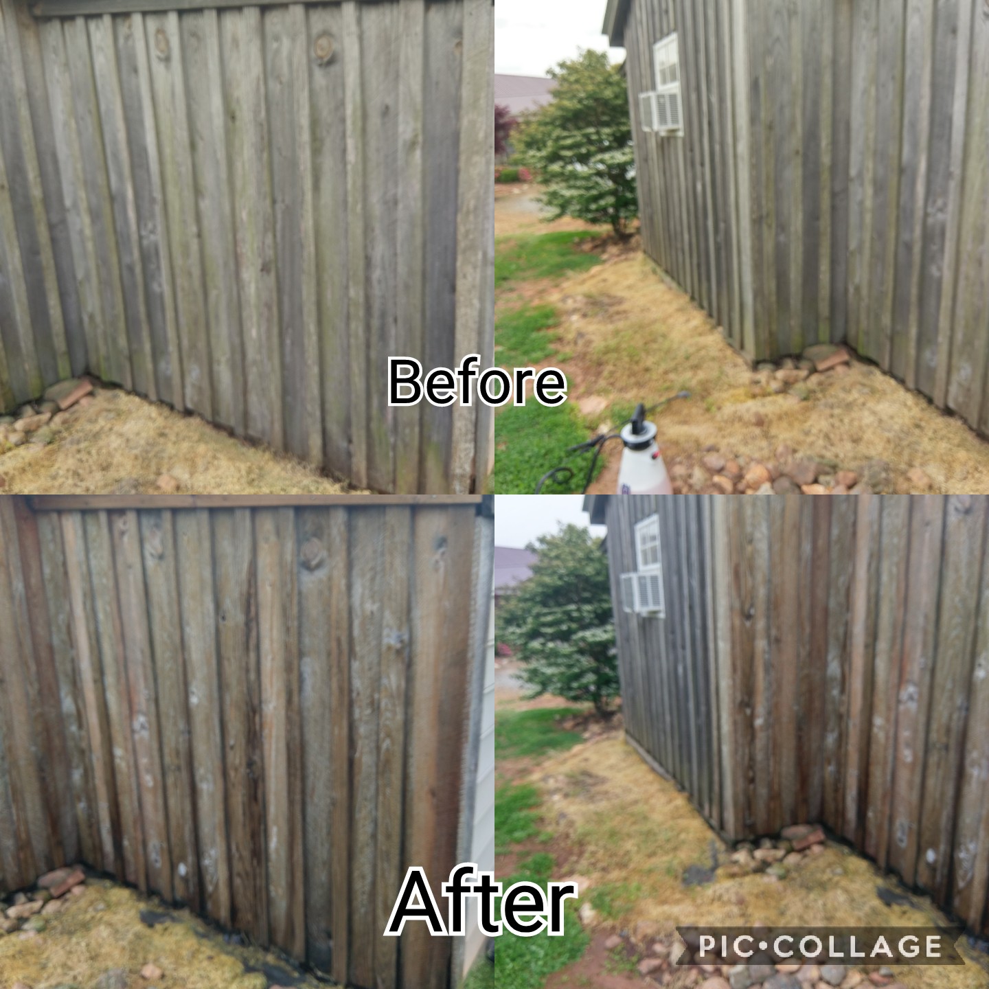

OK so I did a Lil test on my building today with the renewall I mixed 10:1 dwell time 10mins. Rinsed with 1000 psi rinse tip. @Steve do u think I need to try stronger mix?

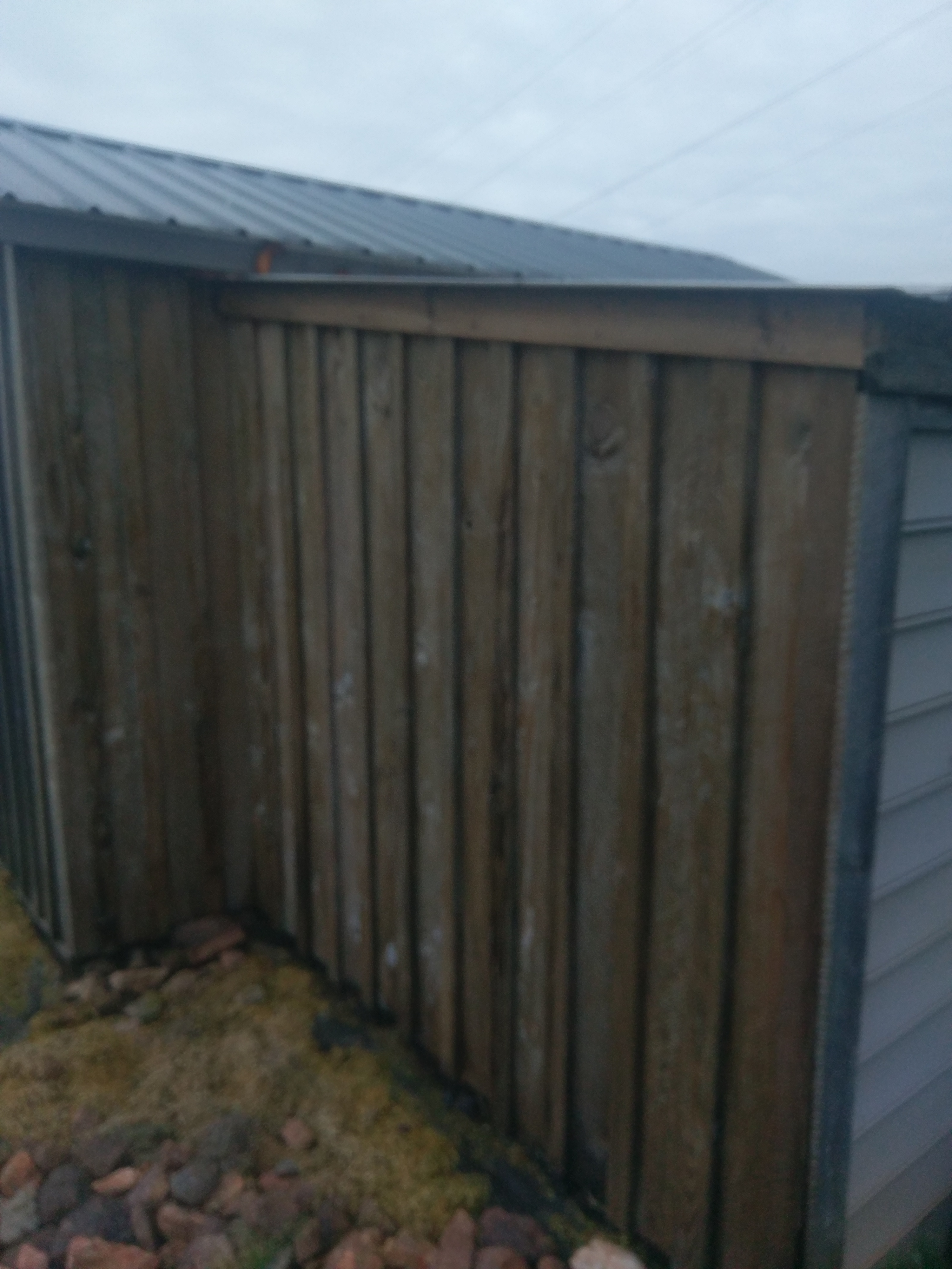

Them white spots are furry looking up close. I have not clue what is up never seen this before. Could it be because it’s rough cut wood? This is y I hate wood

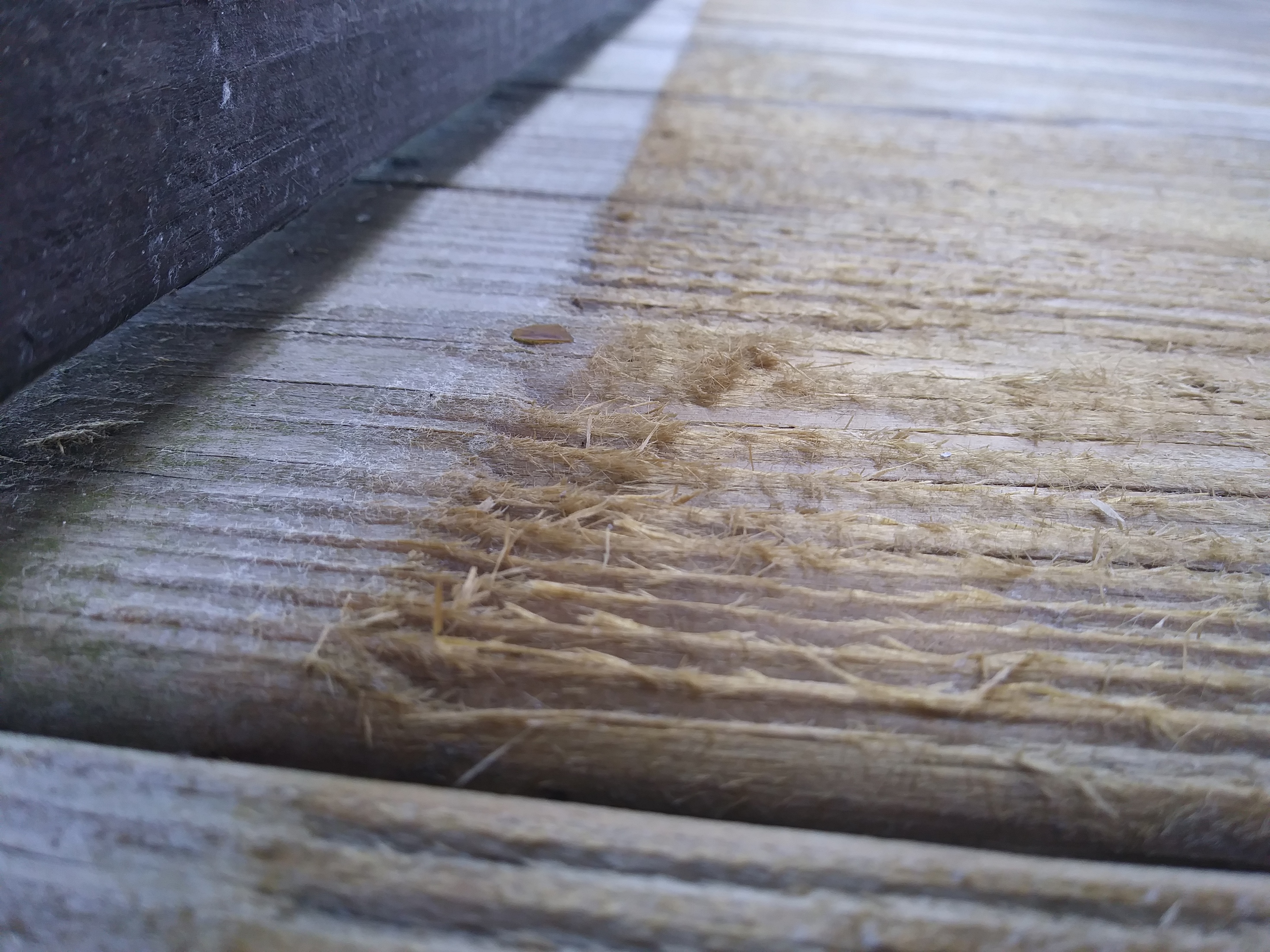

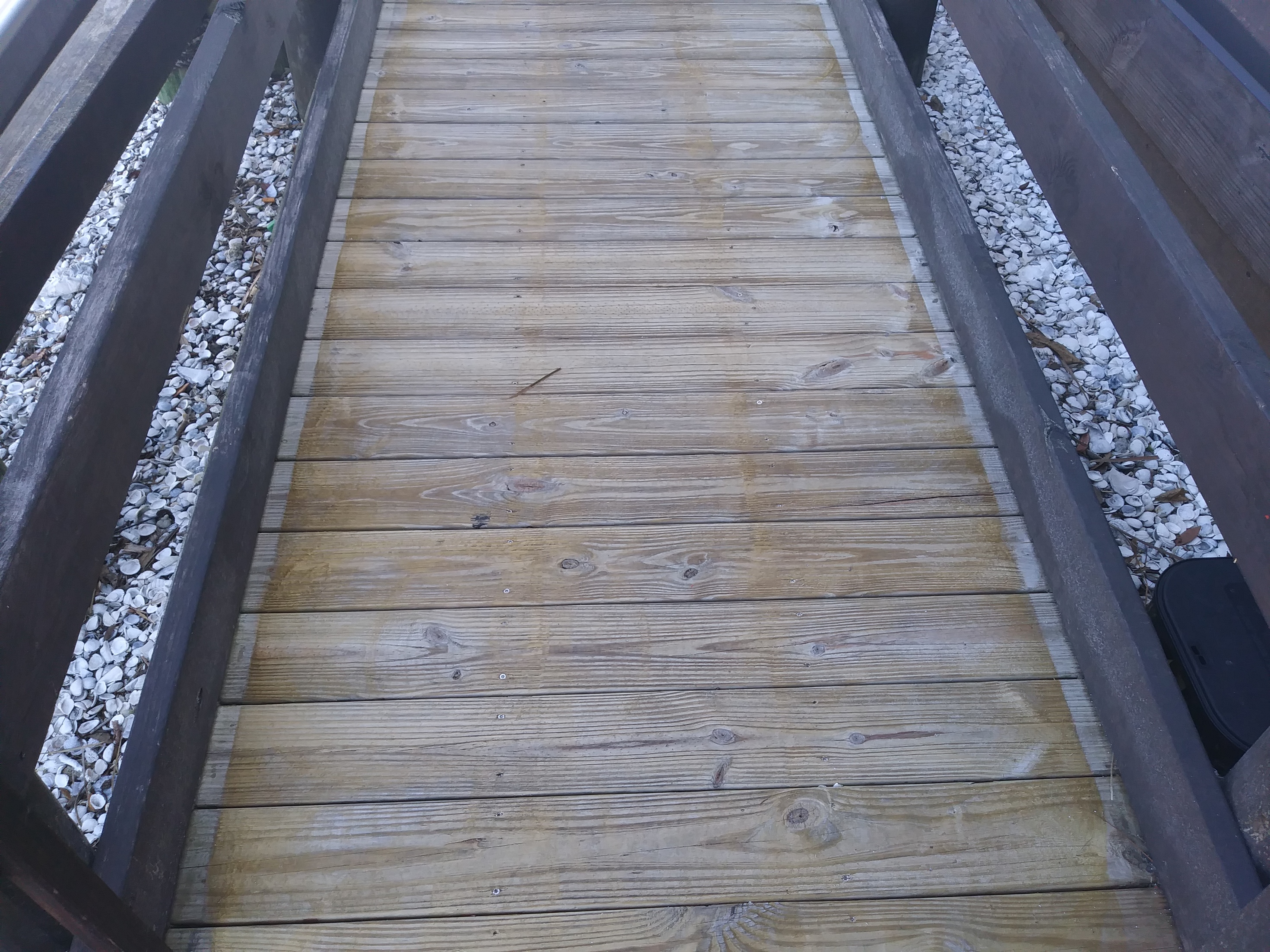

OK so I went out this morning to look at results
It looks pretty decent but 10 minutes might not be long enough and you might not have applied enough re-new-all to the wood. Hard to say, you have to just keep experimenting.
Thanks Steve I will keep experimenting. Just wasn’t sure on it
Try a small section, and soak it pretty good and let it dwell for at least 15 min before you rinse.
Gotcha I forgot to mention I also pre wet that area I did
I would probably not pre-wet wood that’s that grey unless it’s super hot out and the cleaner will flash dry. If you need to pre-wet because the sun is beating down then up the strength of the wood cleaner. Pre-wet will dilute it.

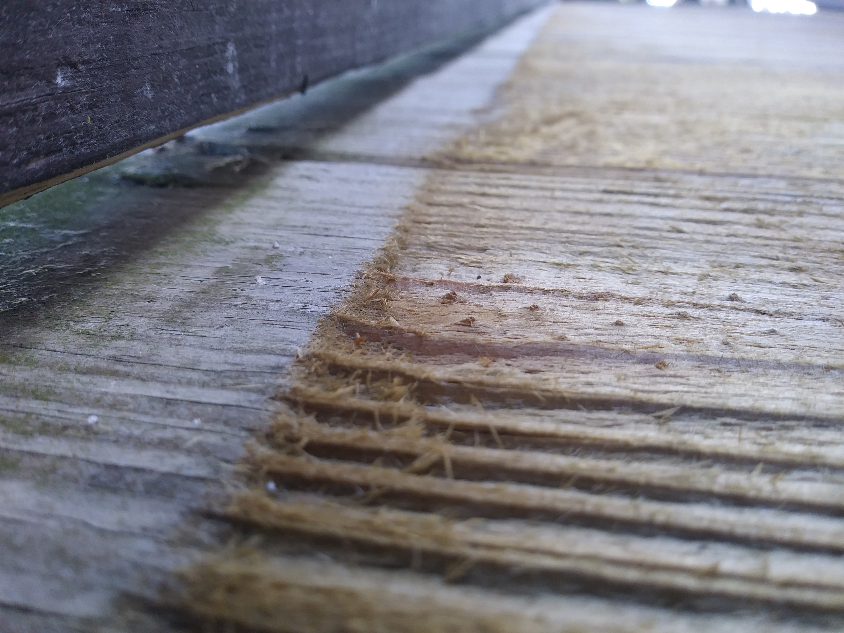

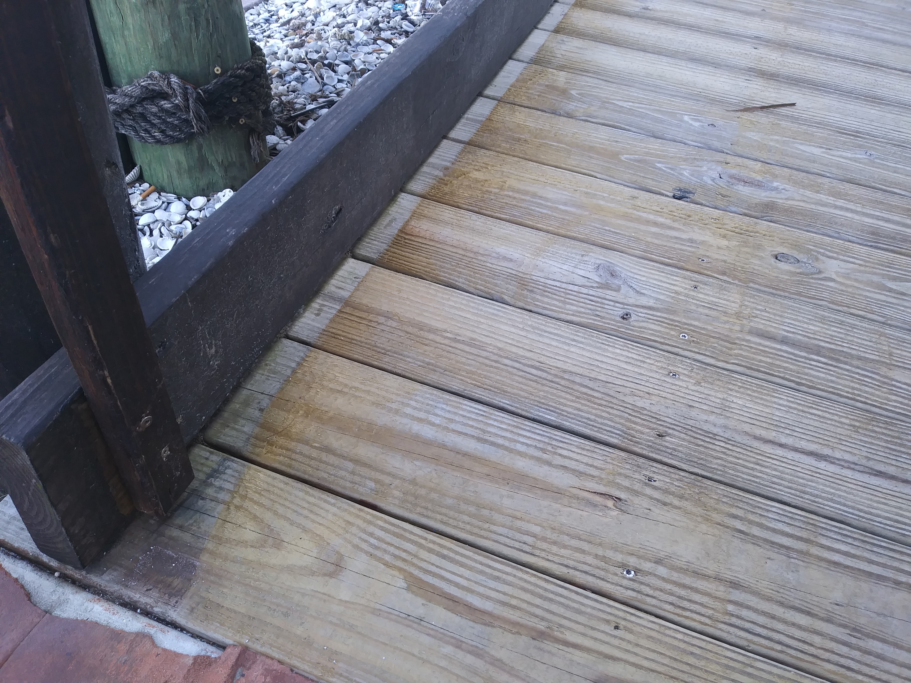

Found this damage done on a deck at a restaurant in downtown, apparently they used a sc on wood

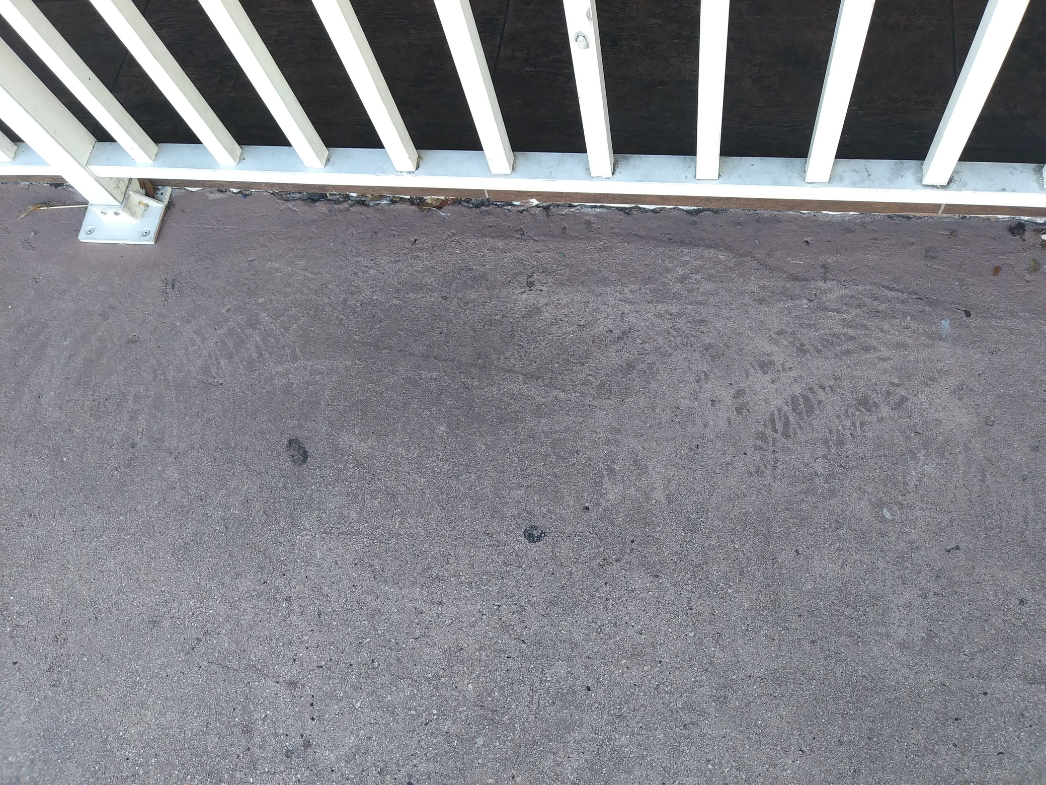

Looks like someone used a surface cleaner on a painted sidewalk also
Nice closeup pics of the damage that can be done when using the wrong tool for the job. Thanks for sharing!
No prob.
It’s etched, I bet if they could have done the edge you wouldn’t be able to tell how etched it is.
