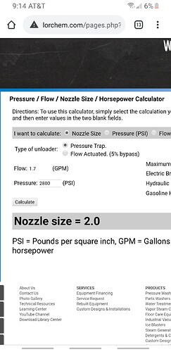

I gave you the answer, here’s a screenshot
25025 tips (two of them) will put you at 2560 psi from each tip
2502 tips (two of them) will put you at 4000psi from each tip
*Edit: see below post. This was calculated for a 4gpm machine
Wait, I did that calculator at 2gpm because I thought you had a 4gpm machine (2 nozzles). Here’s a screenshot recalculated at 1.7gpm giving you 2800psi at each of your 2 nozzles. That was my mistake. Buy a set of 2502s
