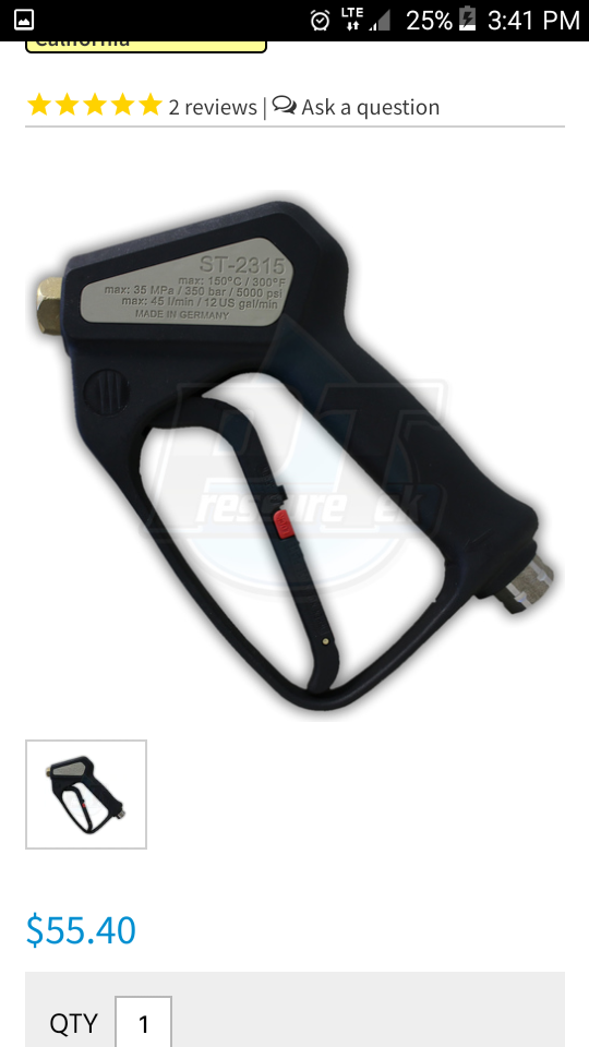

In my opinion, it’s the best gun out there,holds up to hf for a long while,I gotta use ss lance’s because the aluminum one’s disintegrates after a month or so with heavy acid use @GeorgeNicholson,I run a 36" dual lance from legacy,2315 suttner gun, for my close up work ,engine bays etc, couldn’t imagine hauling around a 72" dual lance ,way to heavy, just get a black soap tip and DS

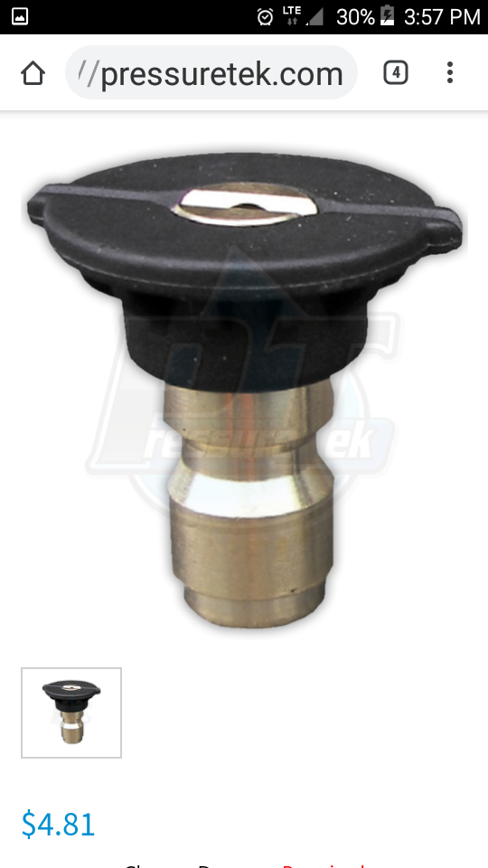

Nope…you don’t really need a dual lance to DS. Just us a single lance and apply the black tip to acid and soap,then switch back to yellow or white to rince,same concept, just a heck of a lot lighter @GeorgeNicholson,if your wanting to get over top of cabs and hoods ,get a 45 degree elbow on the end,or just bend the end with a pipe bender from harbor freight, to your exact liking ,and skip the elbow an extra weight and Teflon tape
I never thought about a soap tip. You’ve held out on me for almost 2 months now with that tidbit of info…haha
You use the 25 or 65 degree soap tip? Does it really matter if you are just soaping? I use the 15 degree to do my rinsing.
