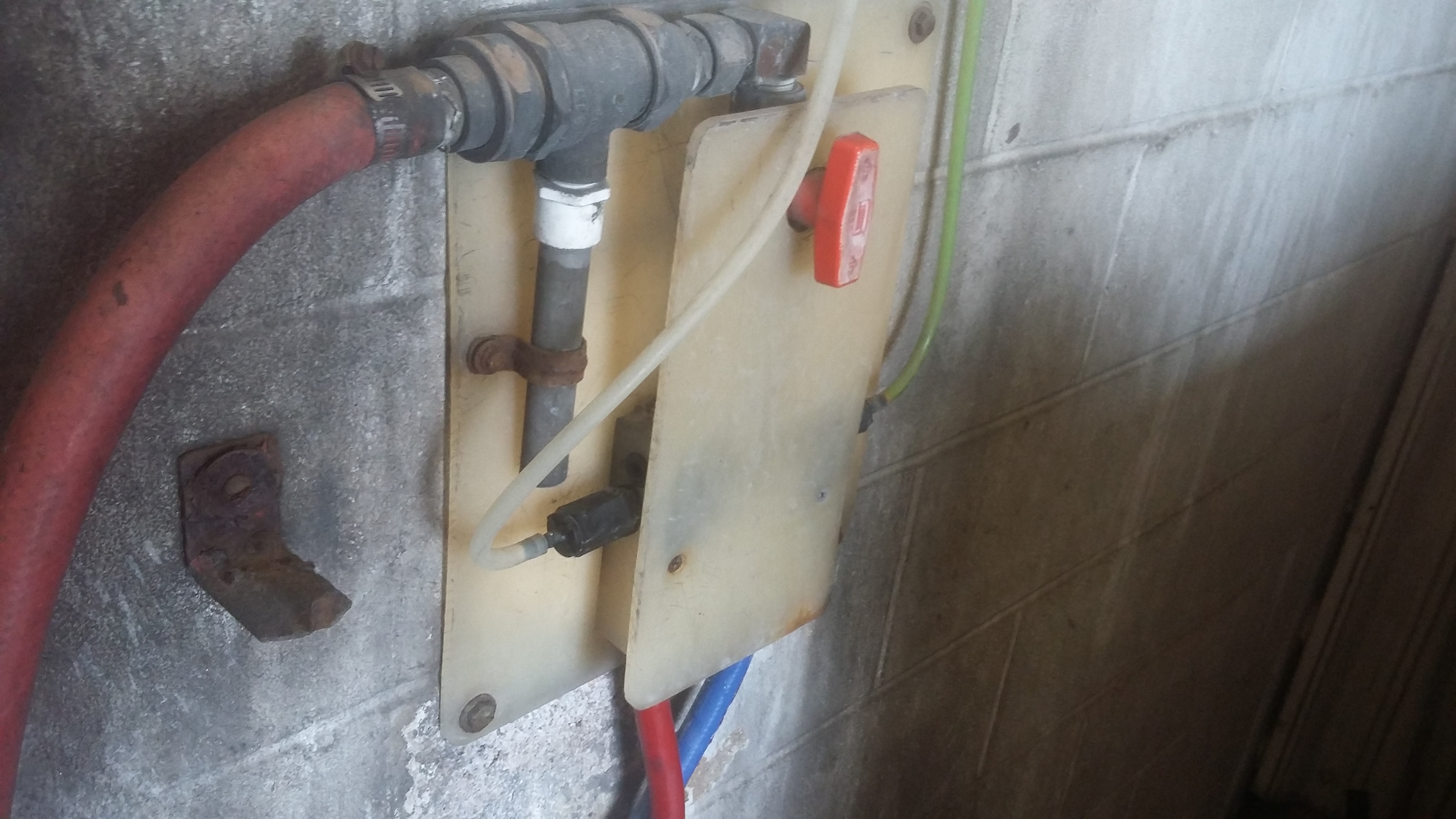

I gotta travel to the GIANT city of Little Rock tomorrow to meet my acid pimp 1/2 way to collect 6 drums of hf and what nots. I’m meeting him at OAKLEY trucking. Big outfit with there own wash bay. I’m invited to come in and meet the manager, who is willing to give me an educational tour. PS… He likes smoked, cured hams and bacon. Which is my hobby. Lol. So I’m gonna take notes and pics of their 2 gun set up. Supposed to be twice as light and twice as durable, with a $800 dollar price tag. And cheaper to run soap and acid wise. We shall see,I’ll report back tomorrow…

Went to Oakley trucking yesterday, it was a bust,there using the Lafferty system, low psi down streamed on a gun with 2 lines. Other gun just rinses @2000 psi
