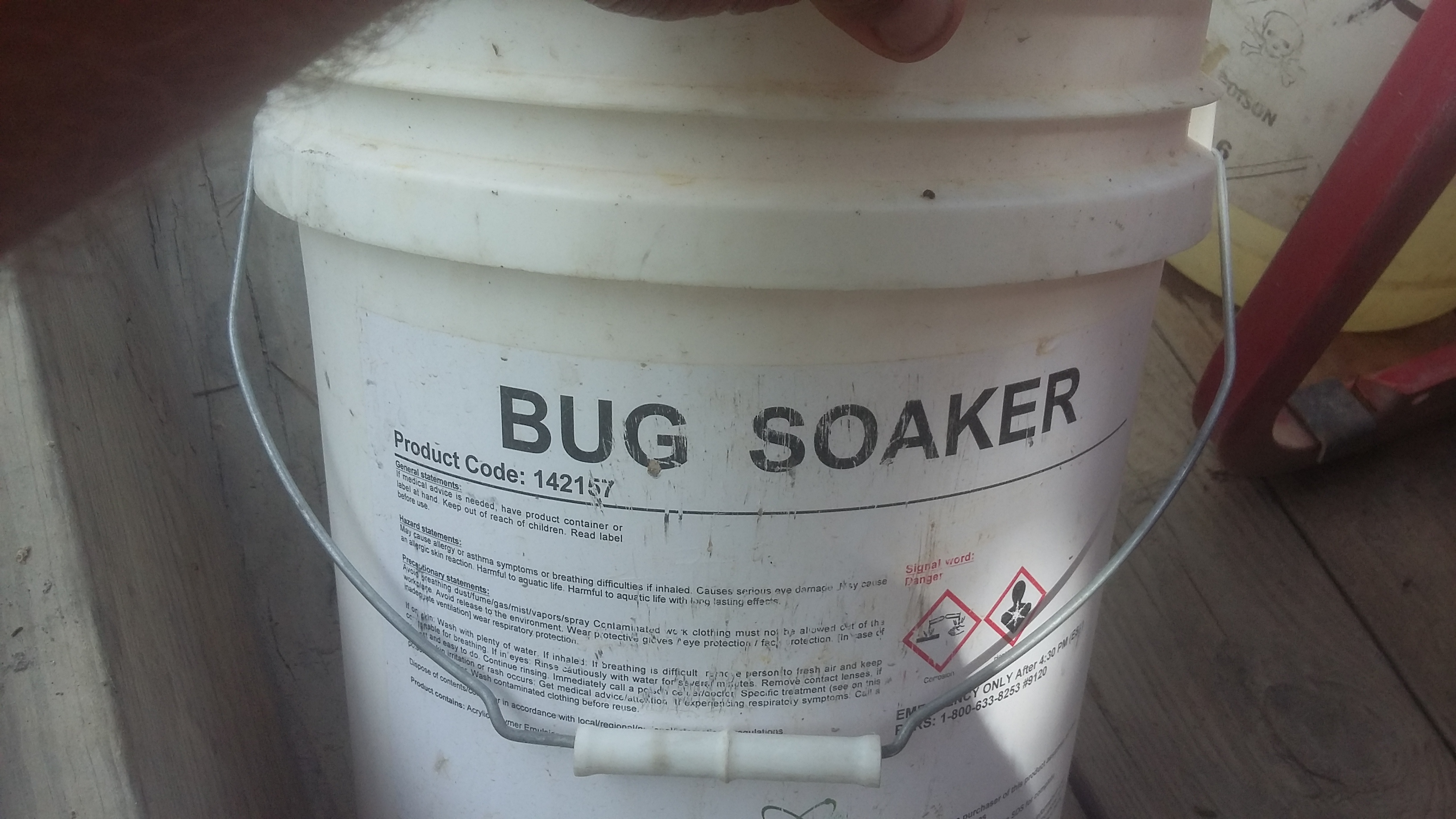

Gotta pic @GeorgeNicholson ? Some times there stainless, I think @pressureguy did or does some. If there stainless you’re good for the soaps you have,if it’s polished aluminum, you have to get citric acid as your #1 and pro wash for #2 step. If you use super sonic and dyna clean on polished aluminum, your gonna learn how to polish for free ,on a tanker. No fun man. Ps…that bug soaker you got is caustic as well. Not good for polished aluminum. Gotta get the SOP bug stuff like I got.

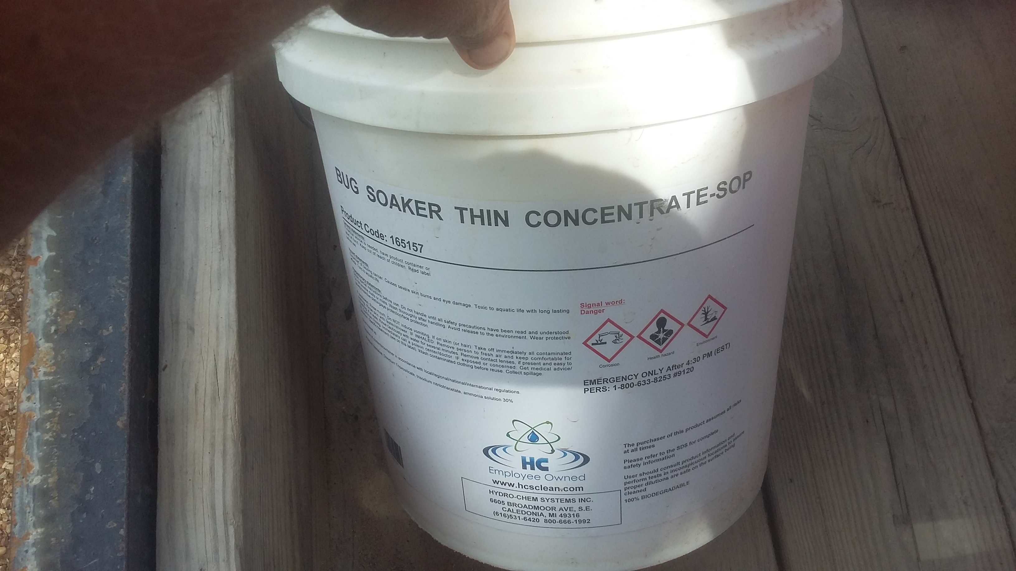

“SOP” safe on polish. Both of these are. 1 is thicker cant dilute as much but sticks better for better dwell time. Go 1:1. The thin I haven’t tried yet. It’s there new stuff Chad sent us
I’ve used the Thin and it works wonders on bugs.
That’s odd. Chad said he gave you the caustic non SOP thin.
I did not know there were two different ones. Yea, I’m using the non SOP. I haven’t worried about aluminum as my fleets are all straight trucks and day cabs that don’t have polished aluminum
Lol. I swear it all windex,smells like ammonia.
Yea, don’t stand too close when applying that is for sure. We foam it on straight from the 5 gallon jug at 15:1. I’m a huge fan of it, bugs melt off
That’s what I’m trying to tell ya. You’ll fuzz polished aluminum with your stuff if it sits to long.
