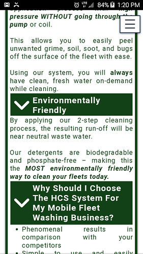

Also your hydrochem chemicals are environmentally safe,with a near neutral ph when used properly ,maybe take your MDS sheets to the water authority for further investigation.

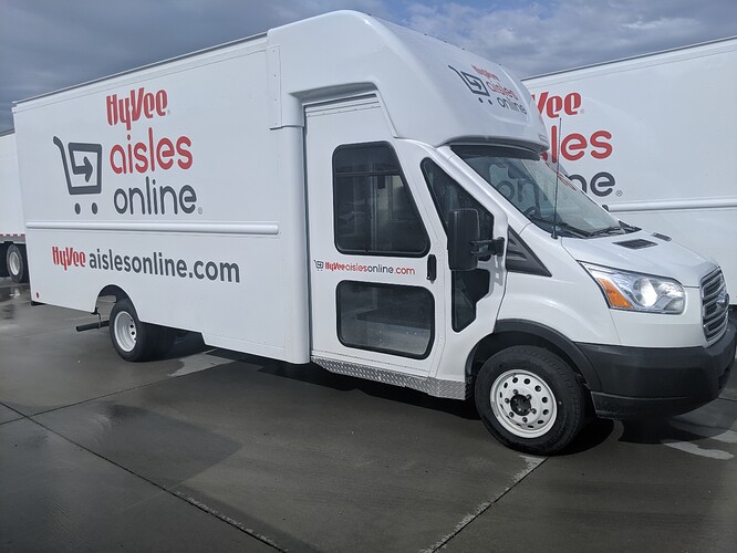

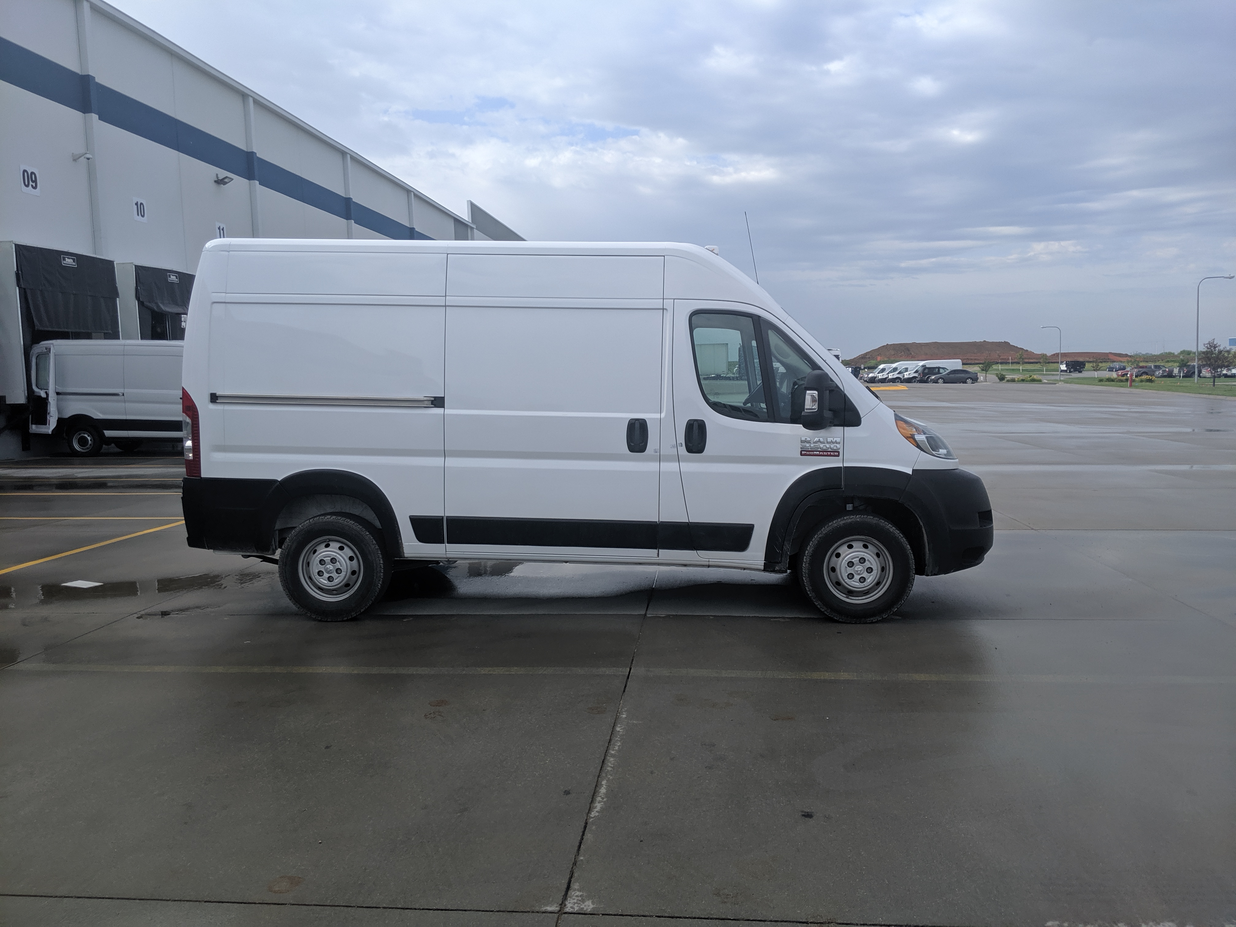

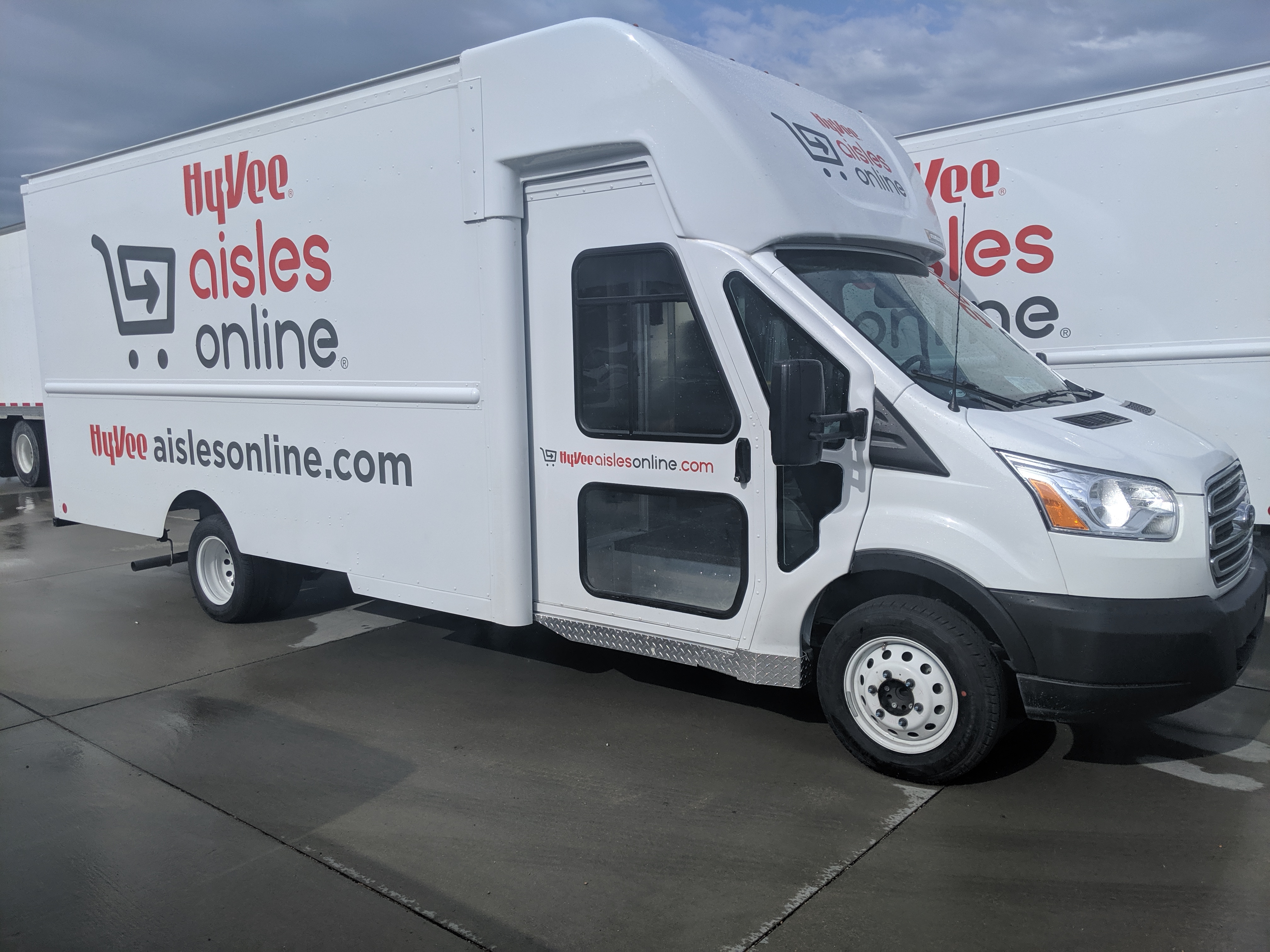

How many units ?
9 straight trucks
10 sprinter vans
16 box vans (not as big as a UPS truck)
I only stopped there because I was at the other end of the building giving a guy a quote that contacted me. He only had 6 of those sprinter vans. Told him I’d do them for $12 a piece (he only wanted to do monthly) but I had a minimum charge of $125 to come out and clean. So I told him to get 4 more and he can get the same price as his 6. He said he still wanted me to clean and that he would email me, we shall see.

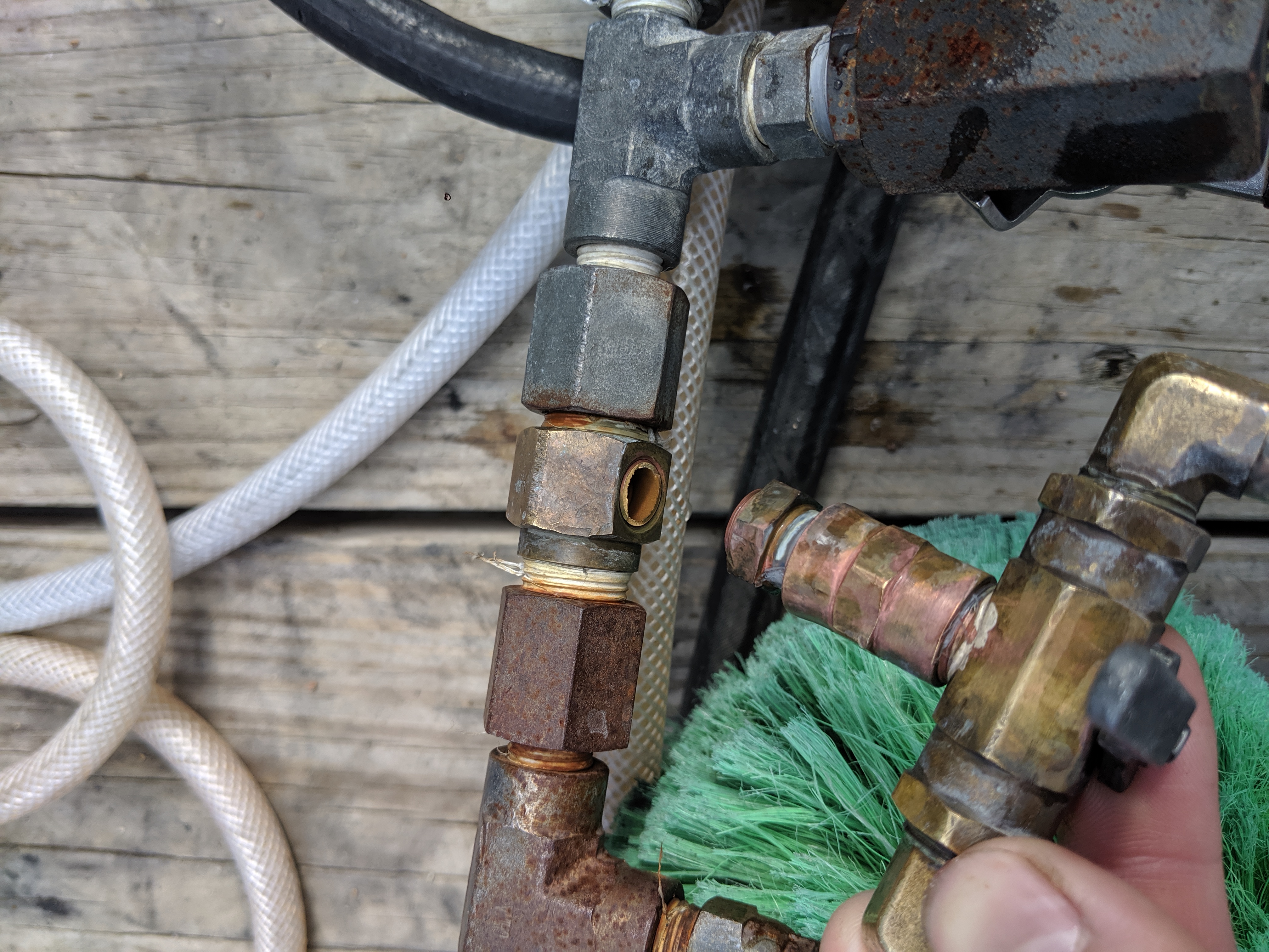

PSA for anyone thinking about getting a two step system: pieces will break. I’m assuming due to the high concentration. A few weeks ago the ball valve cracked and I had to replace that. Today the injector snapped
To fix it you have to unscrew the barb from an adjustable Adams injector and use a 1/4" connector.
