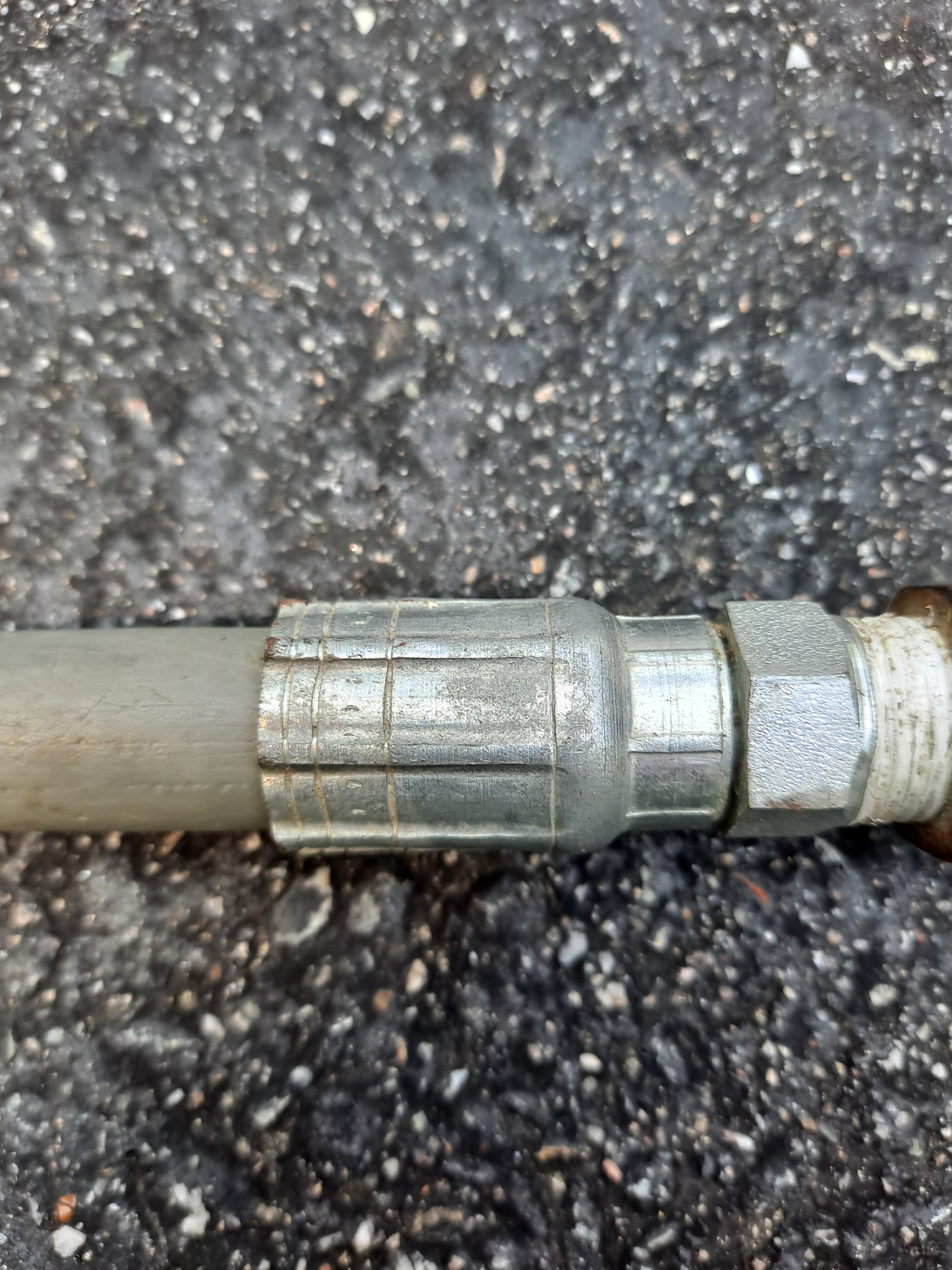

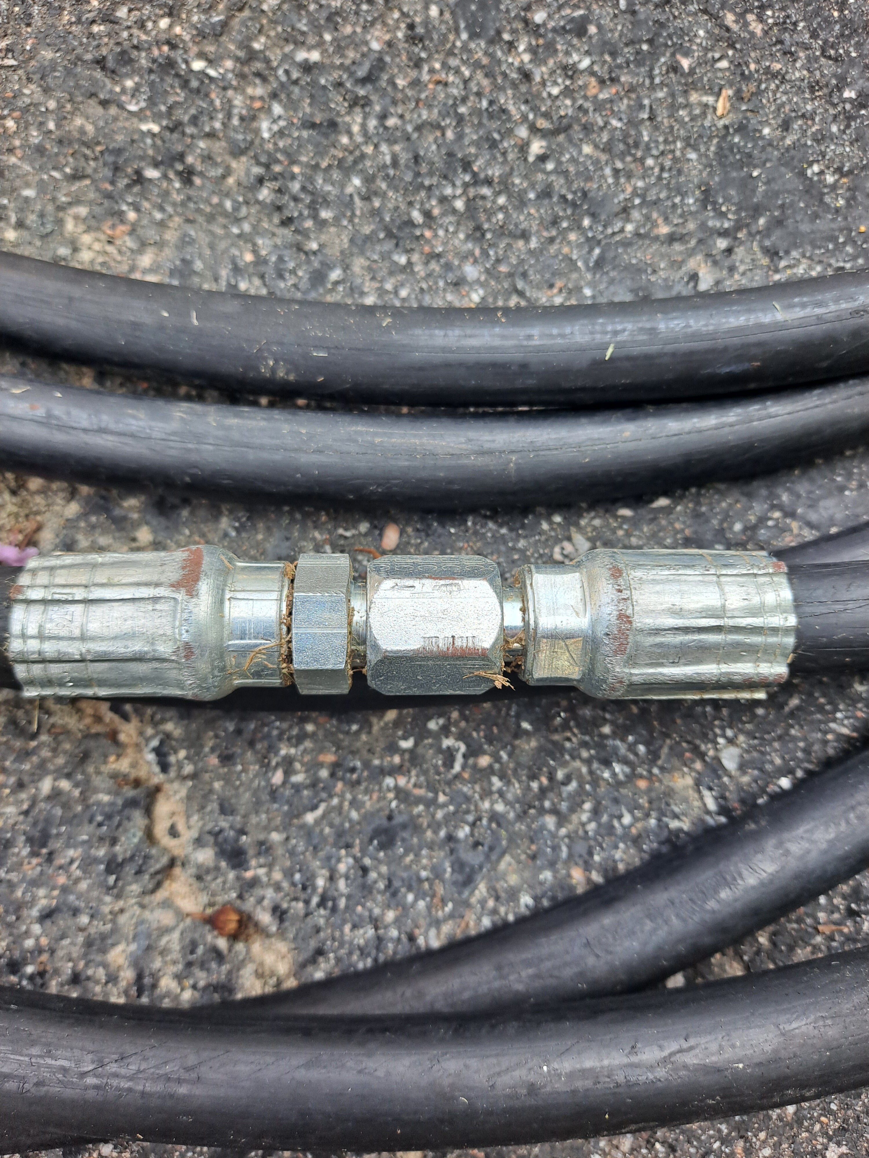

I usually repair hose once, then trash it. I’ve gotten pretty good longevity from repaired hose over the years. I’ve got a TIPCO about 5 mins from my house, luckily. A new end is about $13 installed and a mid-hose repair is about $22. Several other guys use them, and we’ve never had one fail. They also sell Hansen 3/8 couplers for $3.98 a piece
Are you talking about the kevlar hose?
Yeppers

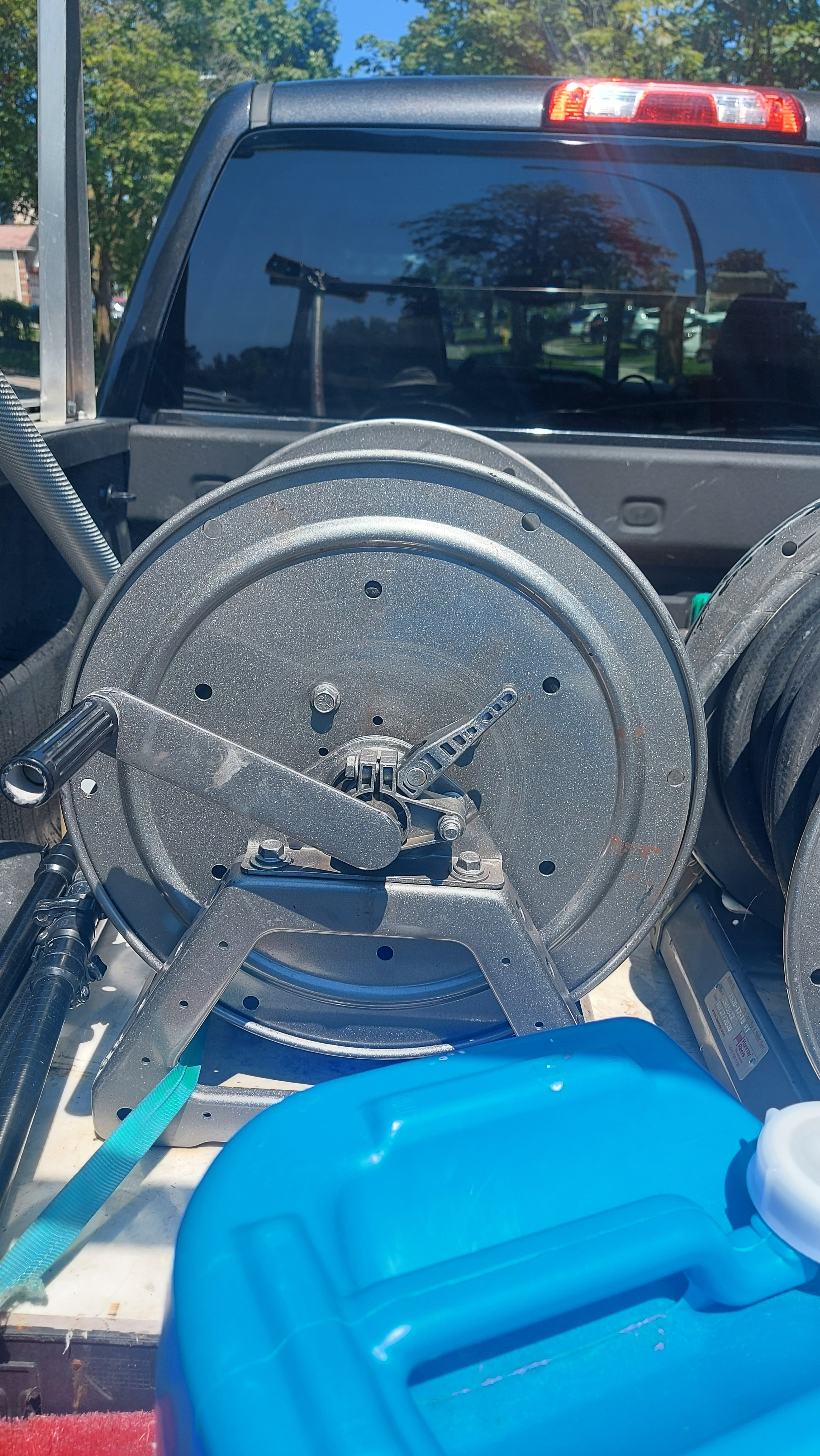

I will test it for you tomorrow @Innocentbystander my expectation is that you can leave it on as long as the brake is engaged. I don’t have super long length so I always pull it all out. Will report back…
No brake on electric reels
Oh you fancy huh?
Very nice, I loosen my brakes completely so there is no friction when unrolling or rolling up. I do leave 2 wraps on and set lock though. Lot of times I only need 20ft or so though when cleaning mailbox kiosks or smaller structures.

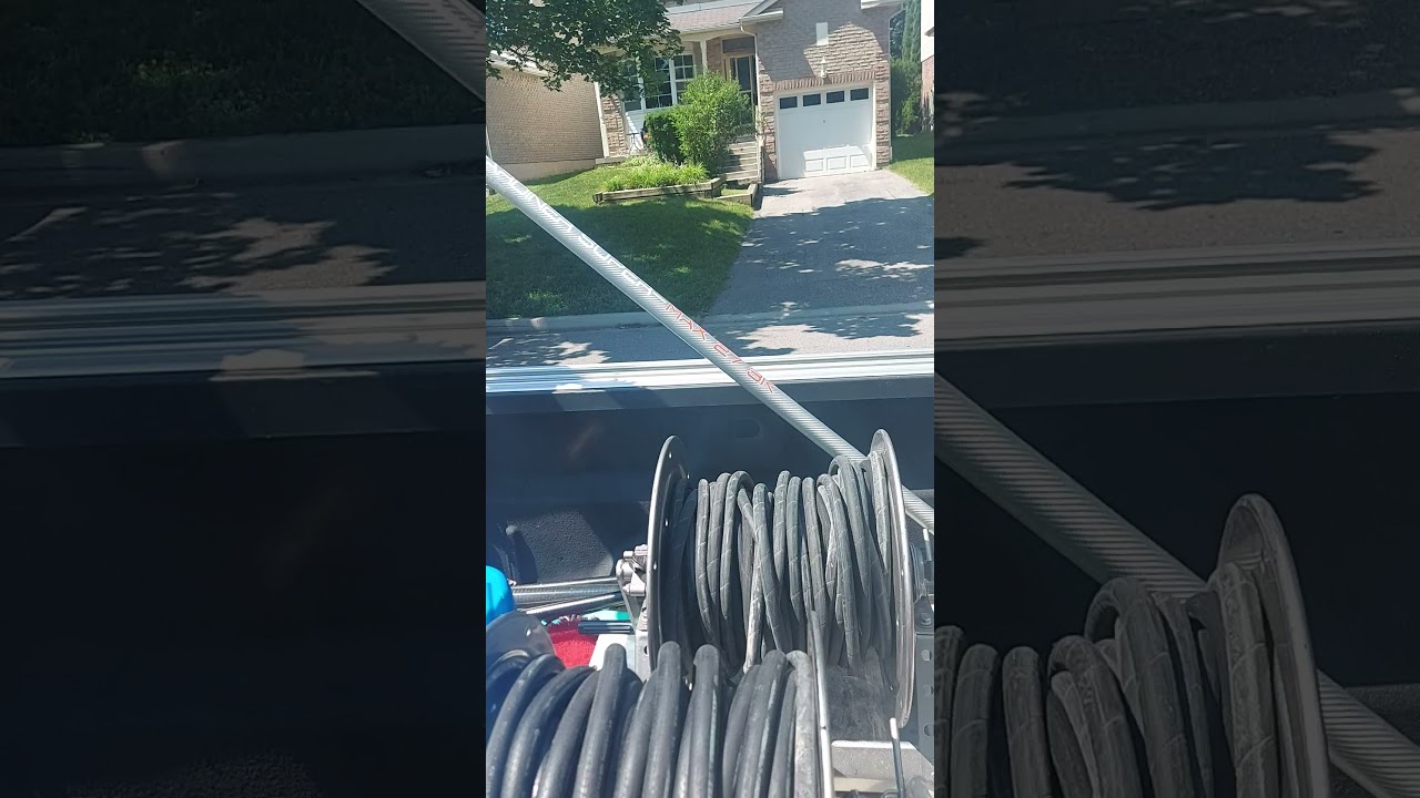

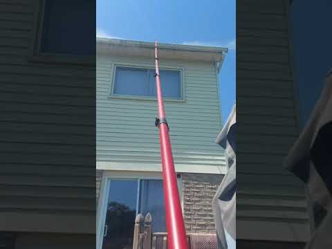

Man get rid of that extension pole. My back is hurting just looking at that thing
It’s for gutter cleaning only, not house washing, and it makes me $250/hr, so…
It’s also custom made carbon fiber, not that crap aluminum/fiber glass garbage sold by suppliers.
I can only imagine the water shooting under the shingles

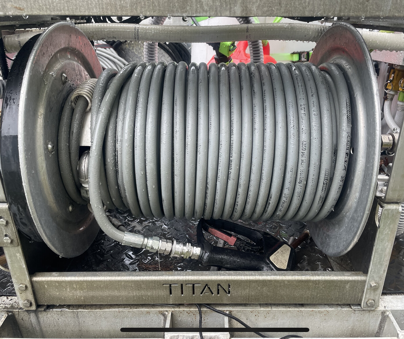

No offense, but this here is what I’d call a rat’s nest. I realize that it’s probably how you reeled it in to begin with. All the extra space between wraps might have some influence on how it behaves under pressure on the reel.
I’d like to see how the hose behaves under pressure when it’s reeled up OCD style. I could never bring myself to wrap hose the way you do ![]()
Pretty don’t make money. If it’s on the reel, it’s on the reel.
