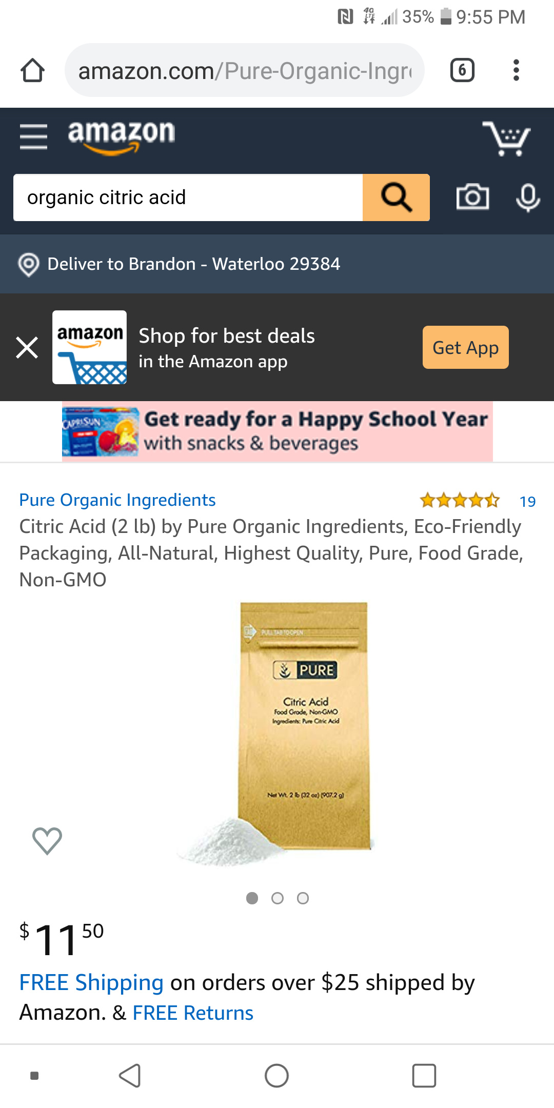

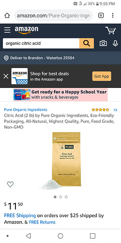

Hmmm i guess a new age rust calls for a new age acid.
Going to try gluten free no GMO organic citrus acid next time.
Might as well rub a lemon on it. Well, an organic, gluten free, non-gmo lemon.
