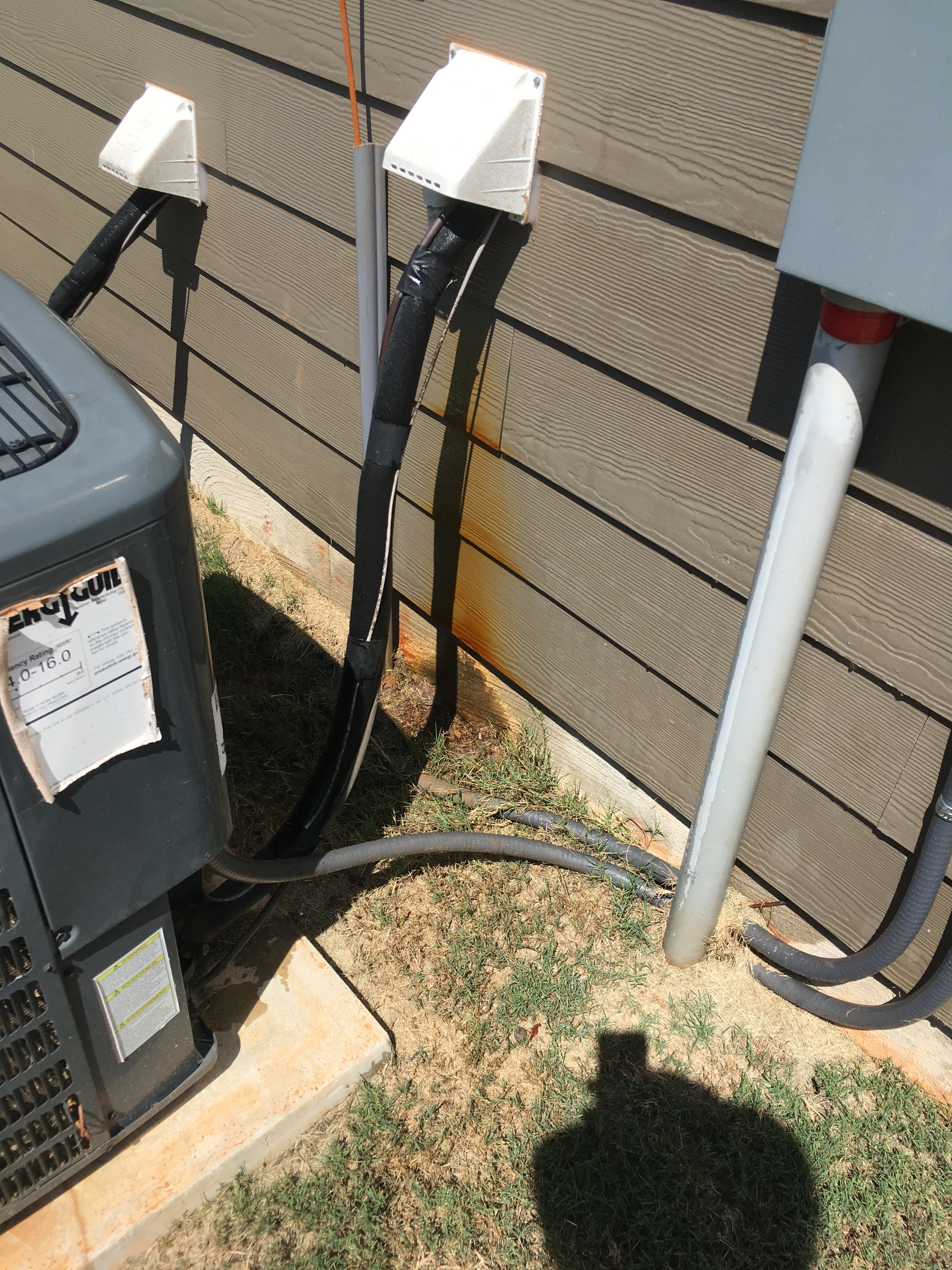

Speaking of oxalic. Ive hit some rust spots on painted brick with it with no results…when i just got off the phone with rick he said he had the same problem today he hit some painted hardi board under a AC today with it 5 times with no results. Do we have some different rust down here or something? He normally uses F9 and said that toom it off quick…

Are you sure its rust and not a lime or iron deposit

How are you guys mixing your oxalic? I had this rust stain yesterday and had some oxalic left over from the deck I’d just done. I rinsed it first since it was painted Hardie board and didn’t want to take a chance of it messing it up. Then hit with Ox 3 times with about 2 min in between. Drain vent from HVAC unit. Didn’t touch it. So I let it dry while working on drive and after it was dry, hit it 3 more times with the Ox and still didn’t touch it. So rinsed it again, walked to my trailer got some F9 and lightly sprayed it on and it was gone completely in like 2 min. My oxalic was 10oz per gal mixed well.
Oh no I mix 3/4 cup per gallon
