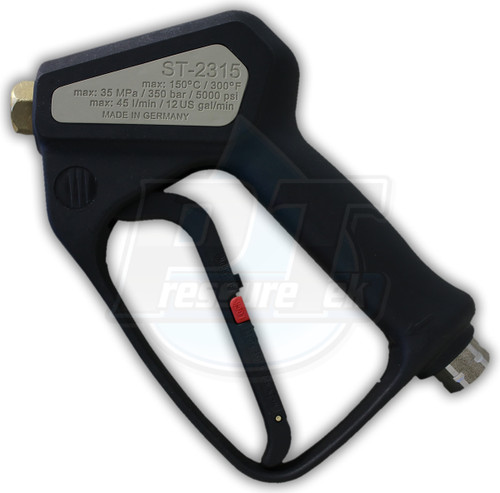

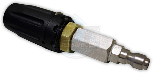

Thank you @Grizz I do plan to get more hose, the M5 and that Suttner 2315 gun. The pressure washer I bought came with a 125 gallon tank and I have a 50 gallon and two 30 gallons I will find out how I need them. Thank you @Racer I will definitely have questions as I am very green in this. I appreciate your offer! @anon26752184 thank you. I tried to get it all out there!
