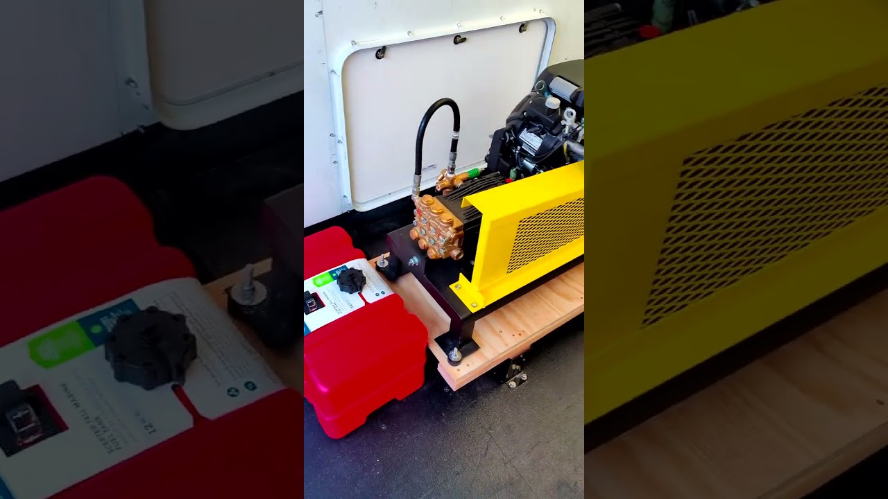

The hockey puck looking rubbers is what I’ve used the most. I’ve used the square ones you linked but they flattened out after a couple of years. You don’t need them until you get to Alaska and add to the feet to mount the machine. Diego switched to 3/4 bypass hose a couple of years ago. He said it’s better than 1/2 I was using. I don’t have any other data than that. I definitely wouldn’t use anything smaller than 1/2. When you mount the machine it’s a lot easier to run the bolts thru the top and lay a box end wrench on them while you tighten underneath if you are by yourself. I’ll take a lock washer any day over those annoying nylon nut things
Nylon nuts wouldn’t be so bad if they weren’t going on halfway and welding on there. Probably my fault as bolts were a bit longer than they should be but trying to make sure with what was available locally.
Cut the bolts next time if it makes it easier. I keep threaded rod around because it’s easier to make your own lengths sometimes.

Here’s my planned layout with stuff blocked out. What are your thoughts because I’m sure y’all can organize this stuff better than me :joy:
Fuel tank needs to go behind the machine, or someplace where the exhaust isn’t blowing over the top of it.

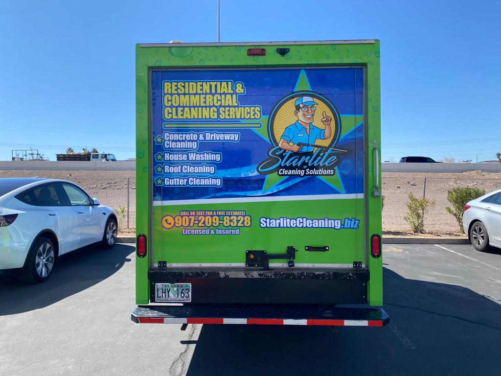

Wrap is complete. Doing a 2 week hitch starting tomorrow and flying straight to Las Vegas to grab the truck afterwards and start heading to Washington to get it on the ferry.
Fought with Penske because they had given me a truck with 4 dry rotted tires and a windshield with a few cracks as well as some other odds and ends that they were contractually obligated to fix.
They ended up cutting me a check for 2200 dollars so that I could replace tires, windshield, etc. I’d call that a win, especially before a road trip.

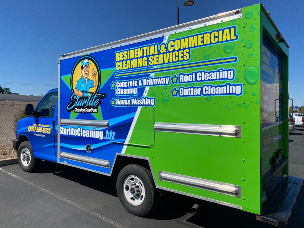

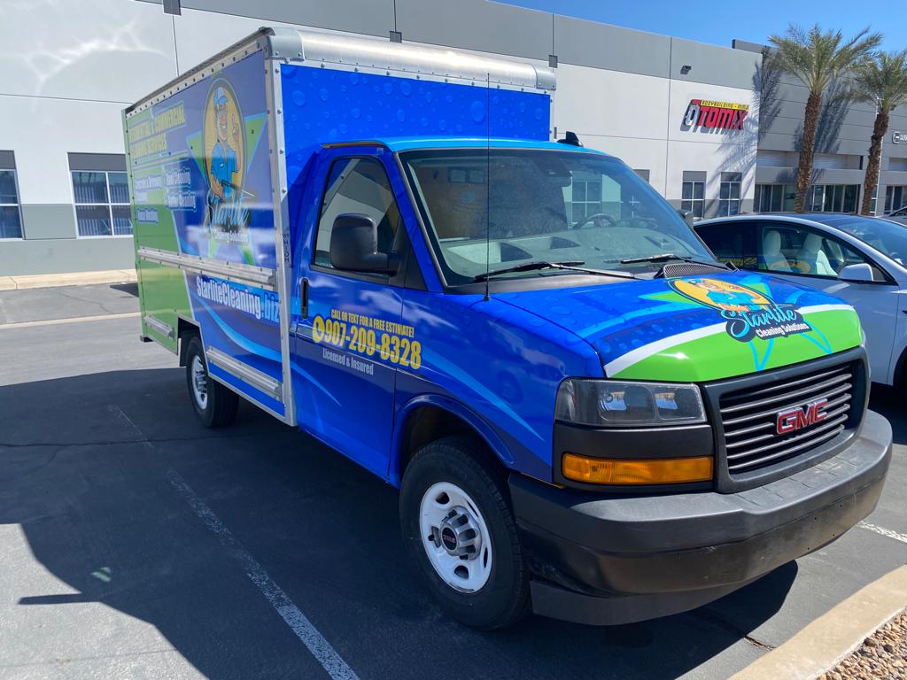

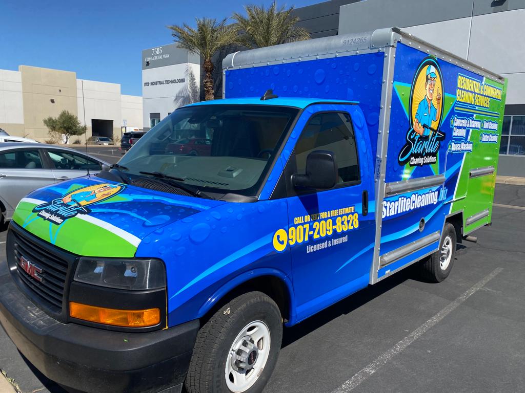

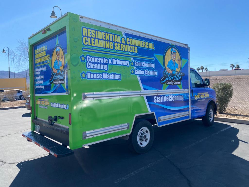

Took me much longer than expected, but I have a 2019 GMC Savana 3500 with 80k miles that’s wrapped and just about set up for business up here! I have a day or two to be in Arizona to put as big a dent into plumbing as I can, and then the next pictures will be of me road tripping!
Coming along nicely, sir! Love to see it.
