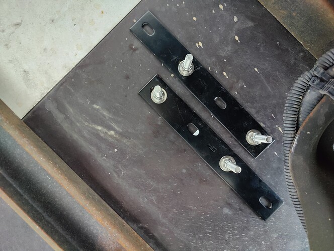

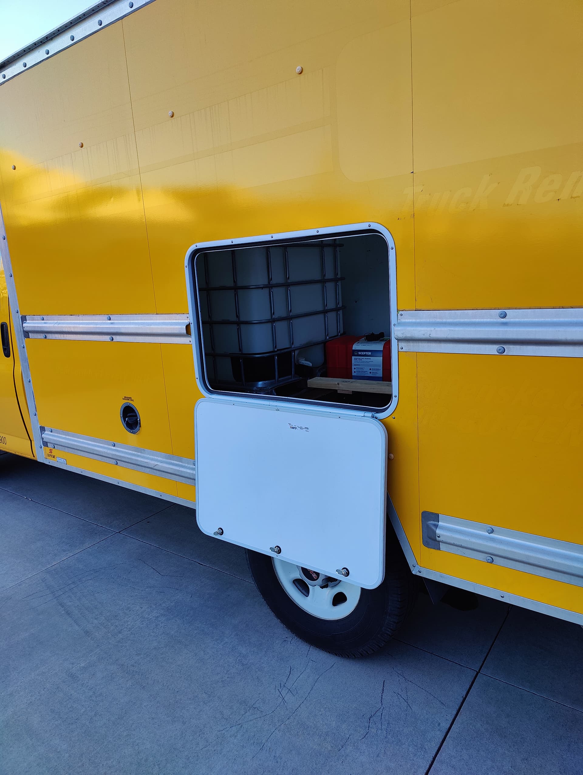

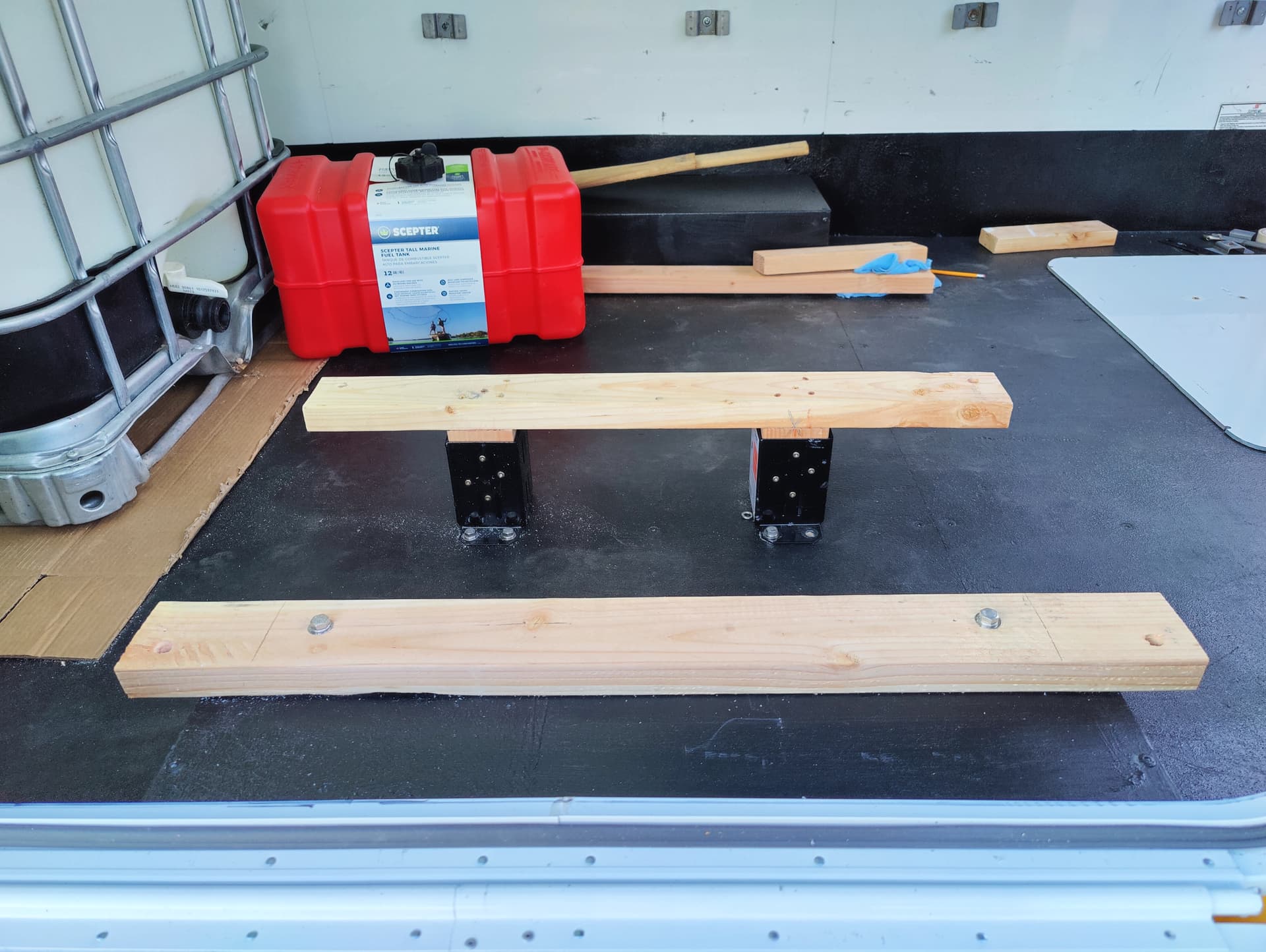

Took a break from through bolting the frame for the pressure washer as my buddy cross threaded the last but for it and must have sent that thing. Was a real pain to break with his fisher price tool set.
Today I put that door in and hoping to finish and mount pressure washer tonight. Will update with pics if I do.
That last bolt got stuck again tonight :joy: I used new hardware as well and am at a loss. Pulled the PW up into bed and tried mounting it but with the bushings the bolts were too small and wouldn’t fit and hardware store was closed. So… tomorrow it is… Running out of days this trip for work. Was really hoping to get that thing installed finally but it’s been giving me fits. Once it’s in I think everything else will pretty much fall into place though

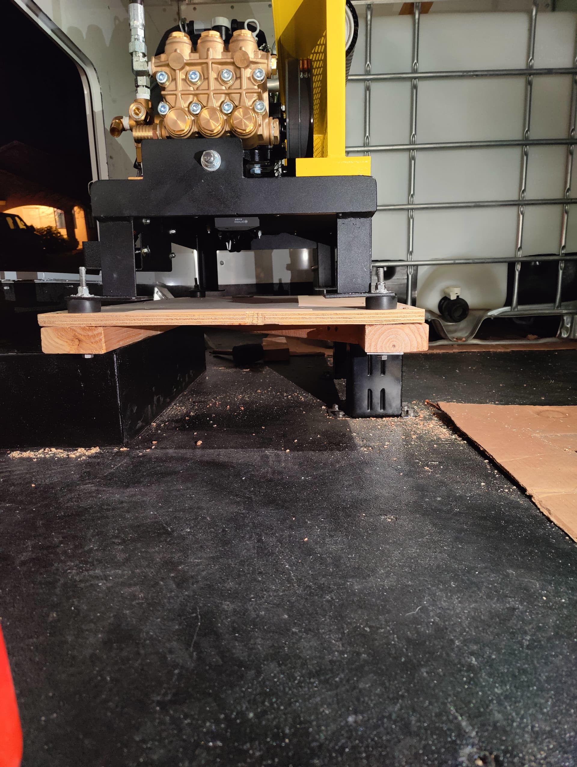

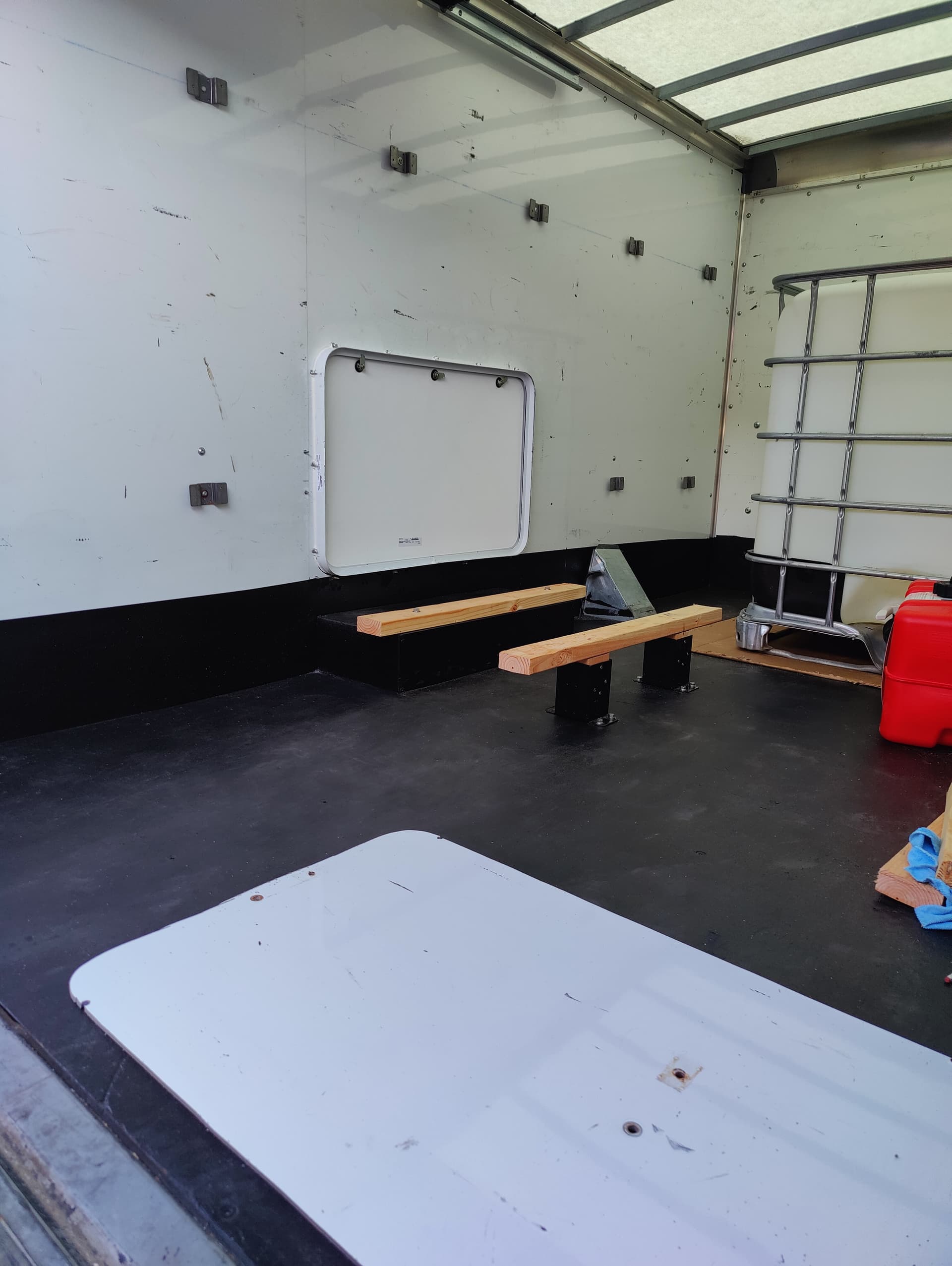

I like everything but the 2x4’s that I assume you plan on mounting the skid to. If it makes it to Seattle I’ll send you 20 bucks. I think you’re gonna have a busted board or two after the first bump. nice job on the rv door and fasteners underneath.
Was hoping someone would give feedback like this. What would you do differently to beef up the 2x4 area? Extra bracing? Larger wood than 2x4? I wish metal was an option but it isn’t really until I get up to Alaska where I have friends who can laugh at what I’ve done so far and probably fix/beef up and weld.
Set it on the floor against the wall and run one bolt thru one of the feet. It will be sitting there when you get to Alaska.

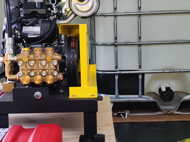

I kinda wanted to see what this looked like and since I had nothing better to do, check out the way it all sat because I had a feeling that those rubber feet would sit funny.
What are your thoughts on this? It looks wonky to me. I am wondering if it’s good with that huge gap on all the feet and if not I’m kind of perplexed at why the skid feet would be like this. I am by no means an expert though so would love some input.

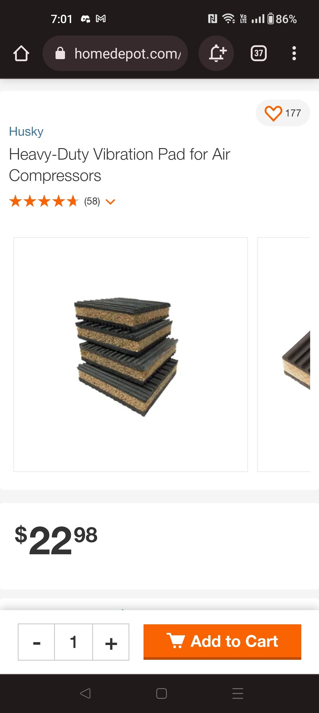

I could use something like this to more evenly out it on the feet but maybe I’m being a little too rediculous?

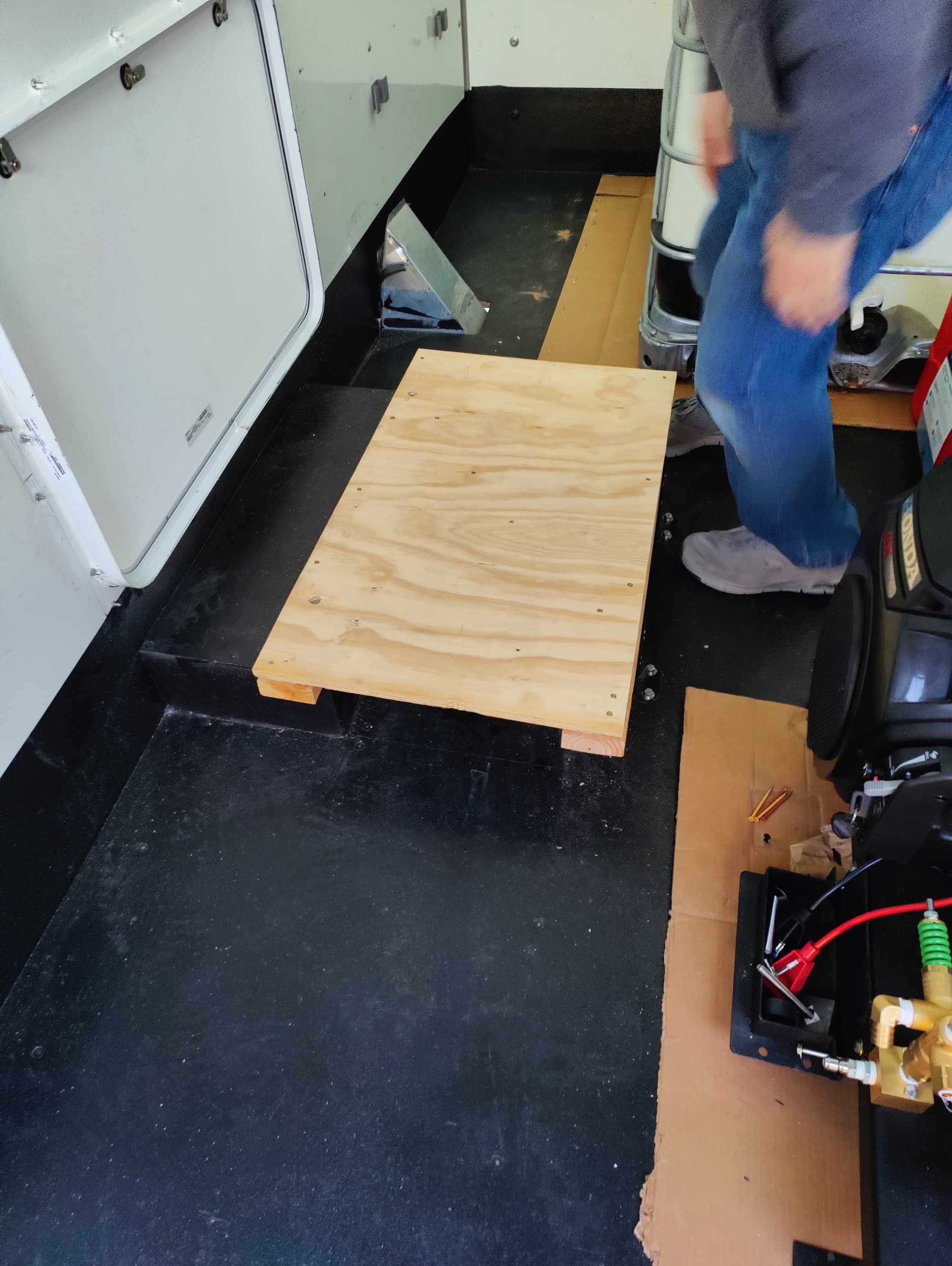

Here’s some more pictures. I finally got smart and started waxing the stainless screws and nylon bolts because it was getting really old using a Dremel on galled nuts… I learned all about that AFTER I bought them of course.

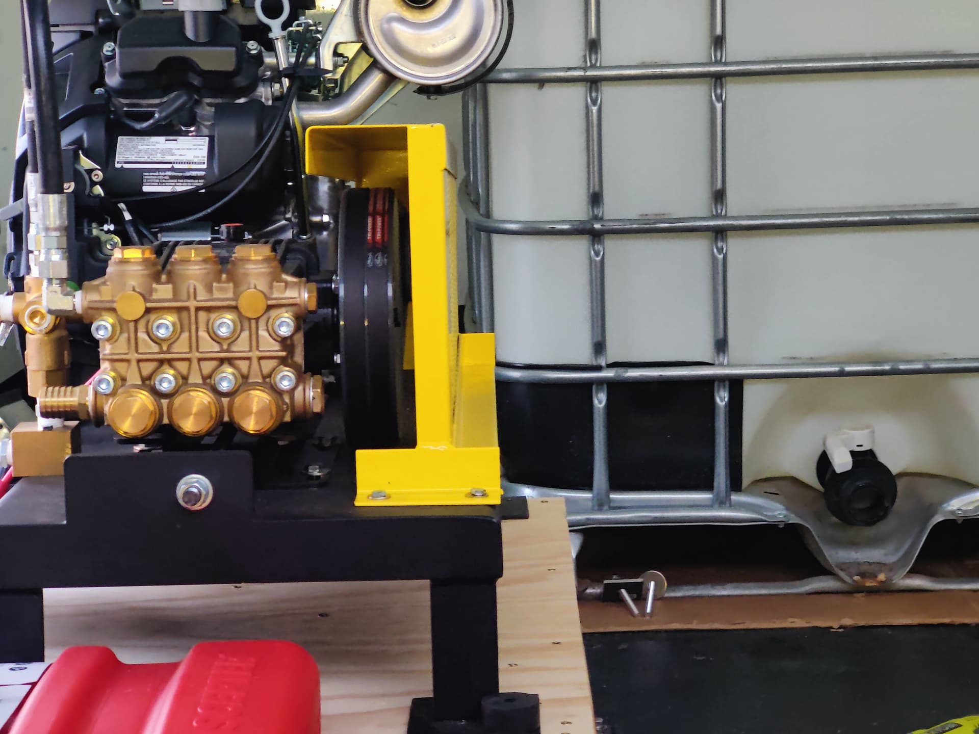

One other thing @Innocentbystander . I’m assuming the 1in barb is water in, the quick connect looks like for the whip line to the reel, the 3/4 barb looks like it’s for the return back to water tank but I’m not sure. What is that for and if it’s for the return to water tank why is it 3/4? Seems a bit big but like I said I’m not expert and would love to know!
No expert either, but I’d say you done figured that one out :crazy_face:
Just second guessing because idk why the return line would be that big. Also because I’m gonna have to buy some 3/4 hose
or a smaller barb :man_shrugging:
Stop making sense. What are you using? …logic… reasoning? Psh.
Ill probably swap it to 1/2 then if that’s not going to make this blow up. I’m new to this nice equipment. Afraid I’m gonna kill it. Never even seen one in real life before this.
I just checked our standard plumbing schematic and that’s the one hose in the entire systems they didn’t label :joy: I’m relatively sure it’s about the size of my pinky though, so 3/8, maybe even 1/4, IDK I mean, if it goes into bypass and you’re getting 3kpsi into the water tank, you may want to stick with the larger barb & hose…
