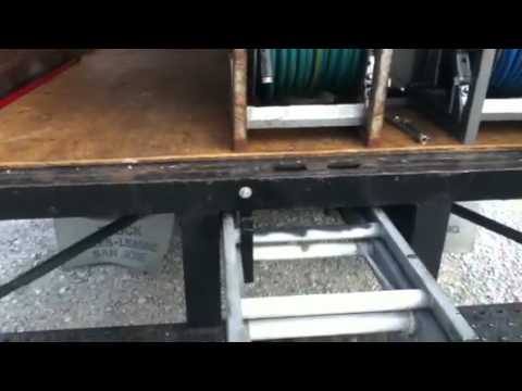

These are a decade old but the info is still about the same
