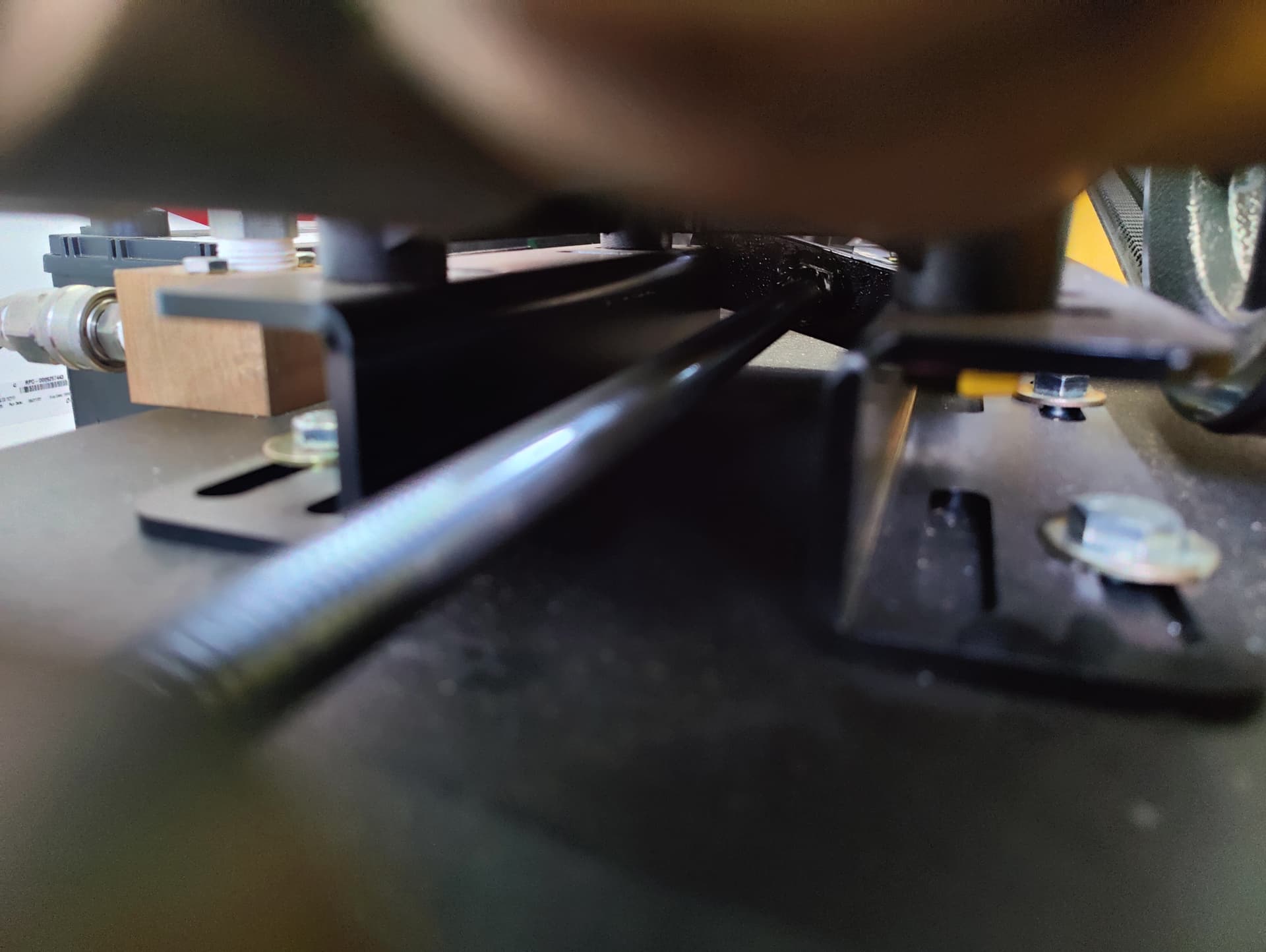

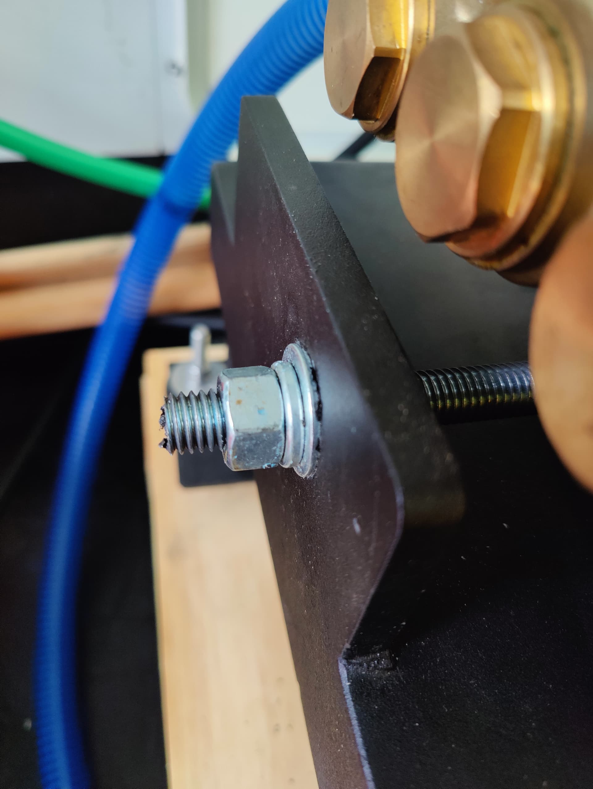

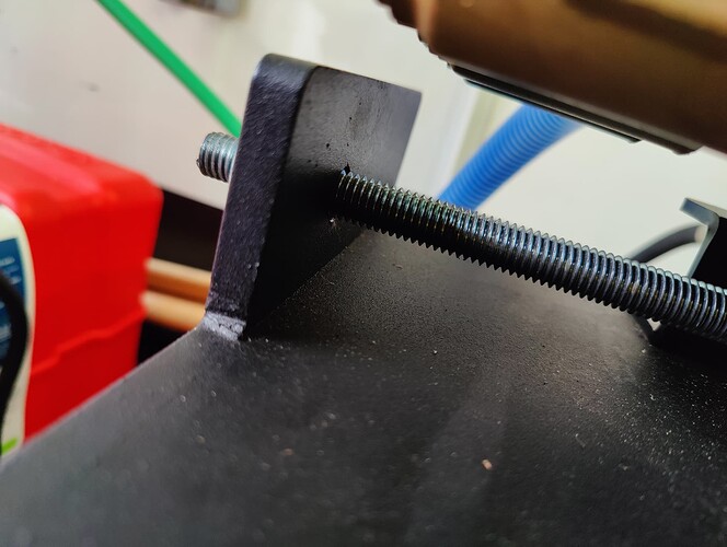

thanks id appreciate it. on the other end is this which is the only but I’m seeing. Not seeing another or a double to add more space so what I did was loosen the 4 bolts below pump like you said, then gave the main bigger nut a couple turns and then tightened the 4 underneath the pump back up.
I DID use a wrench to hold up top while loosening them down below :joy:
