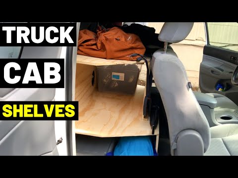

It’ll be mostly window cleaning stuff (including my rectangular Pulex bucket), with some space for spare parts and fittings for the power washer. I think my toolkit will also stay in the cab. I’ve gotta spend some time paring down what I really need. I find myself carrying around a lot of junk and chemicals that I never really use. Stuff that just seemed to migrate from the Toaster, into 4-Slice, and now Chuck.
Very good suggestions. I’m thinking of trying to keep the space right on the floor (in front of the built in storage) open for longer items like extension poles.
I really like that first pic @MuscleMyHustle posted, with the full bulkhead barrier.
Whatever I build, I plan on enclosing it enough so at least the heavier items can’t fly forward in a collision. For the top shelf, I’m thinking of storing only soft goods like towels and ladder bonnets, so anything unsecured couldn’t really hurt me in an accident.
A small trash receptacle that can be easily reached from the driver’s seat is a definite must.
A utility bed for the truly vain. I love it
I think once I have a working installation with plywood, and I’ve ironed out all the kinks and pain points, I’ll bring it to the fab shop I use and have them rebuild it in aluminum. That might be another year or two from now

This thread is about to become (even more of) a brain-dump, as I try and workout my design for the shelving.
I’m going to try and keep it as simple as possible to start with, so I can allow it to evolve naturally as I begin to use it and see what works and what doesn’t. I made the mistake with 4-slice of spending a bunch of time making some nice drawers, before realizing that, “drawers are where things go to die”… especially when they’re too deep.
One thing I need to account for: being able to partially recline the driver’s seat for the occasional jobsite nap.

I’ll have my traditional window cleaning tools (bucket, squeegees, towels, etc.), some spare parts and fittings for equipment, and my toolbag/box.
Also need room for a small trash receptacle, spare clothing, and other odds and ends that I need to keep out of the elements.
What are you using under seat storage for now?
Passenger side has the jack and lug wrench. Driver’s side currently has an unloader, a hudson valve, and a couple cans of silicone lubricant. There’s not much room to speak of in there.
Whatever I build, I know it’s gonna make getting into those compartments a little more difficult. So I’d prefer to have things that I use very infrequently put in there.

I think some plywood and 1x and you can surely have enough space to do whatever you need.
Keep a tool box and heavy stuff on floor for sure.

This is where my mind’s at, right now. But I’d use angle brackets bolted to the existing mounting points. No self tapping screws in my rig ![]()
I might do an L-shape to allow the driver seat to recline a bit. With slanted front walls, kinda like this (drew it on my phone in 2 minutes; hopefully you get the idea):
