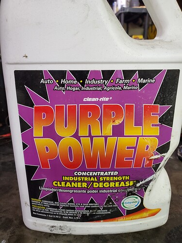

There must be a couple different kinds. I have a gallon of one that only has Diethylene glycol monobutyl ether. Maybe it’s just not listed in the ingredients. Before I washed Buffalo Wild Wings I picked some up that had hydroxide in it to have just in case I needed it. The Purple Power concrete and driveway has hydroxide listed in the ingredients. I ended up getting a brand called Super Clean that had it listed.

I don’t know much about Purple Power. I was just going off of what’s listed on the ingredients on the gallon I have. Maybe they can sell us watered down stuff here since we can’t drive down the road and molotov cocktail them. :grin:
Here’s what the bottle looks like that I have.
