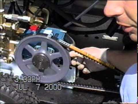

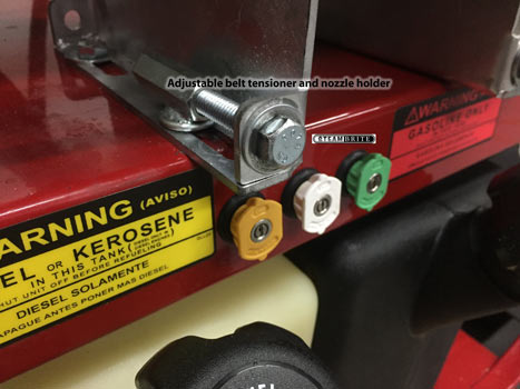

Spent the last hour digging up all the pics and vids I could find on it. You’re missing half the tensioner, it must have vibrated out or it was misplaced and never made it back on. They call it Hydro Tek’s EZ Align belt tensioner. The carriage bolt needs to be run the opposite direction which provides the stand off for the custom hex rod the tensioner bolt pushes off of. Just tension it another way.
I realize the pump frame in the pic is not exactly like yours but they used that style of tensioner all over the place. This video shows it well also but it’s of poor quality but you can make it out pretty good.
