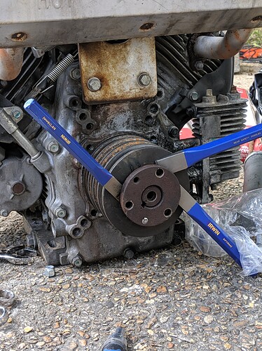

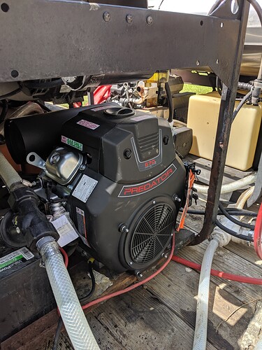

After spending hours yesterday morning trying to get the pulley off the Honda I called it and made a 3 hour round trip to buy a new pulley. Got it on the predator and realize that it doesn’t line up exactly right on the skid so I spent an hour trying to get the alternator belt to fit while also lining up the bolt holes. Wasn’t happening but then I realized I didn’t need to run the alternator if I don’t use the generator or burner. So I get the predator all hooked up and go to tighten the belts and the pump won’t budge. Spent an hour trying to fix it then called it a night. This morning I realized that there’s a jam nut on the other side of the tensioner bolt. Put a wrench on that and I was able to unscrew the bolt all the way. Turns out it the tip had worn down so it wouldn’t catch. Put in a new bolt and boom, belts tighten. Ran the predator for an hour and it works just fine!
If it lasts me a month while I get the Honda fixed I’ll be happy lol.
Big thanks to @Innocentbystander and his Landa dealer Nick. Both very friendly and helpful guys. Also thanks to @SchertzServicesLLC for taking my call and answering a question about the predator. And thanks to @dperez for those videos and @Hotshot and everyone else who chipped in with suggestions and advice.
Was a very frustrating few days and I’m sure if I try to fix the governor it’ll be a frustrating few weeks but I’m back in action now.
For future reference:
  1. the hydro-tek ez tensioner system has a jam nut that you have to hold to unscrew the tensioner bolt
  2. if you can’t tighten your belts you probably just need to replace the tensioner bolt
  3. a predator will fit in the spot your Honda is on a hydro-tek hot water skid, but you have to take the throttle lever off and let it hang on the side, and you’ll probably need a slightly bigger 5l belt for your alternator.
  4. you can run the machine without a belt on the alternator if you only need cold water
That’s about it!
A very stuck pulley:

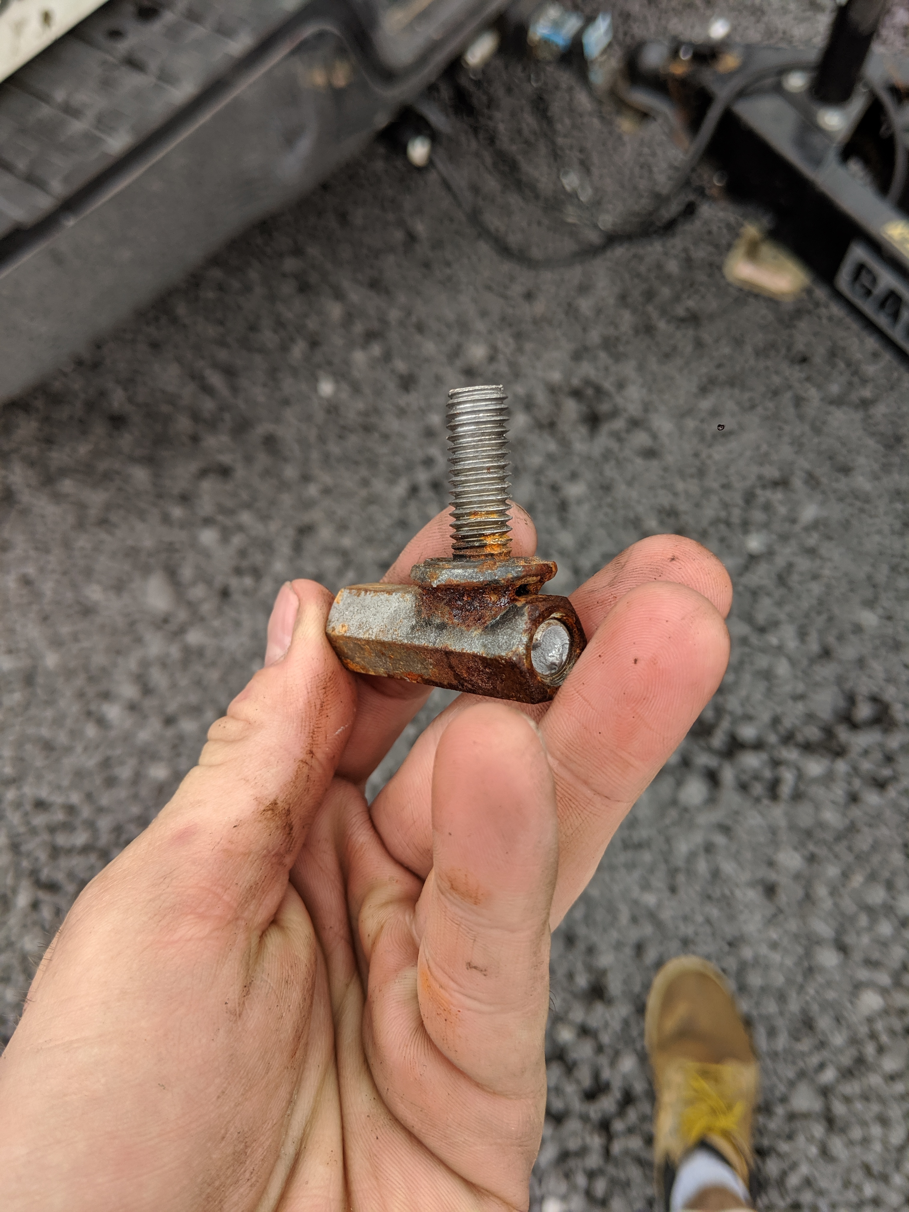

Related question: how would you go about removing the tensioner bolt if you snapped it in half?
Pic
Well I managed to get the whole deal off so it shouldn’t be as hard as I thought. Burner’s not firing and I’m getting no power at the plugs so I was trying to move the alternator to tighten the belt. Snapped the tensioner rod.
Would be great if I could just buy a replacement and not have to worry about removing the bolt.
That looked inadequate anyway. Replace it with better. Use a 5/8 threaded rod and weld a plate with hole in it in front of pump for rod to go thru
