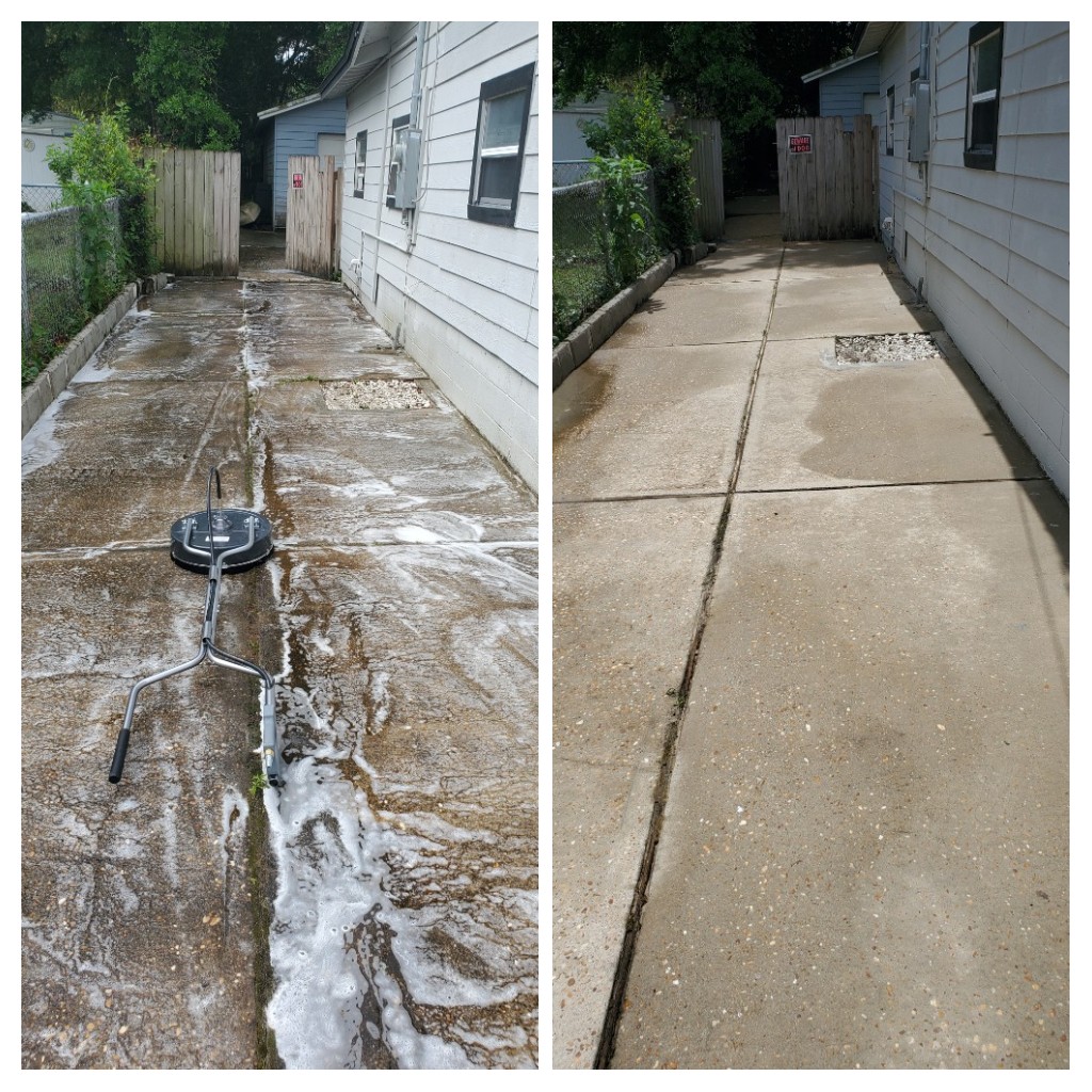

I got so many pics wuere ive soaped and been like well i messed up and ruk around real quick to snap em haha 1 of my easter jobs lol

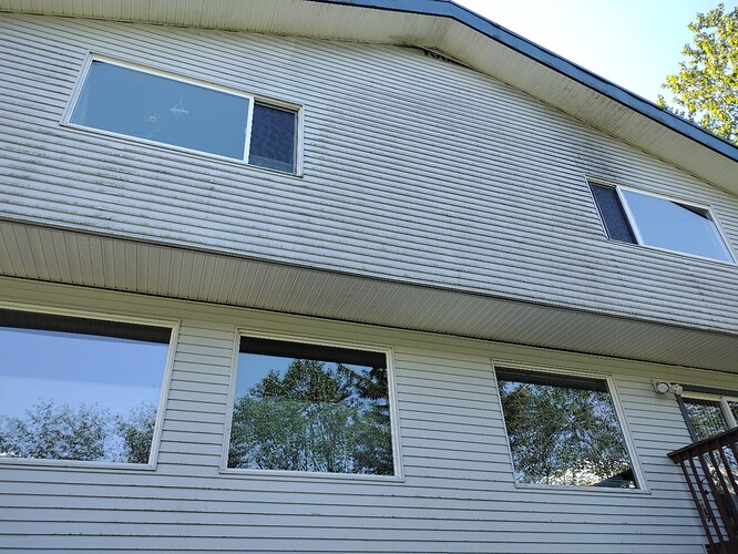

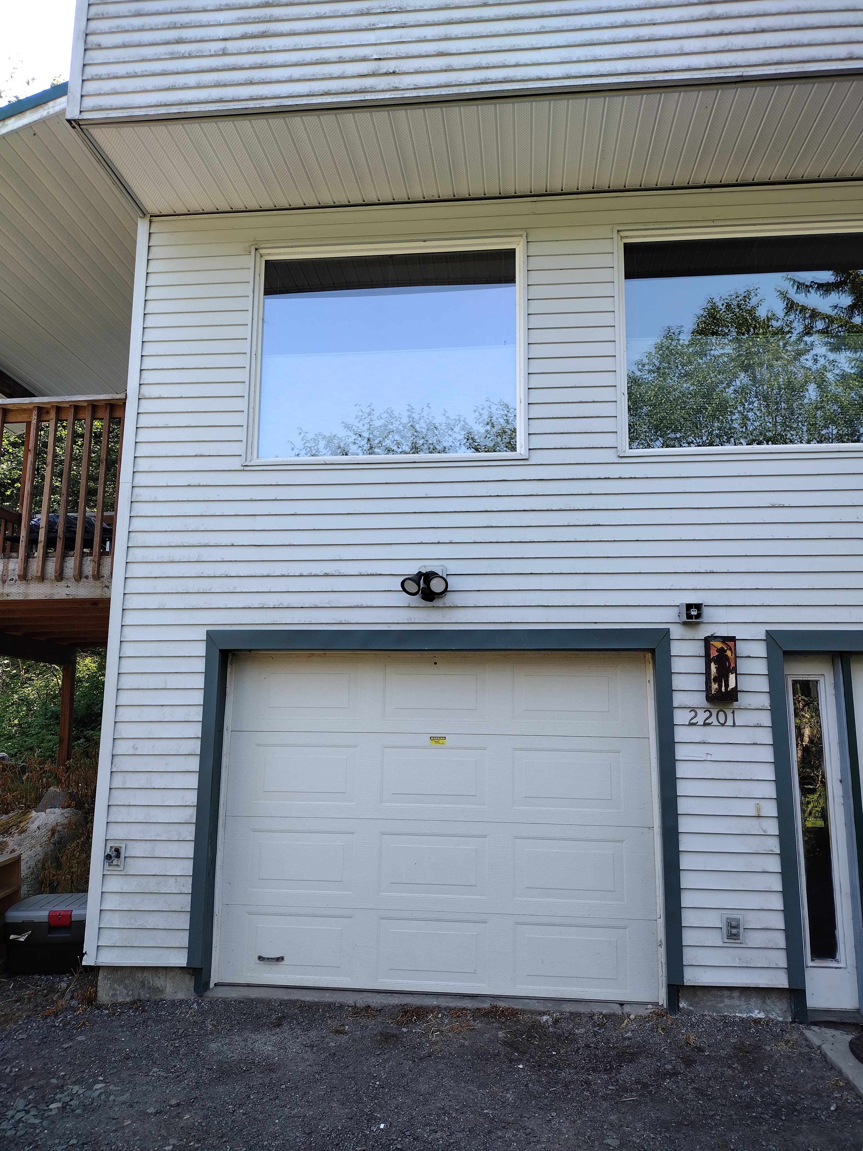

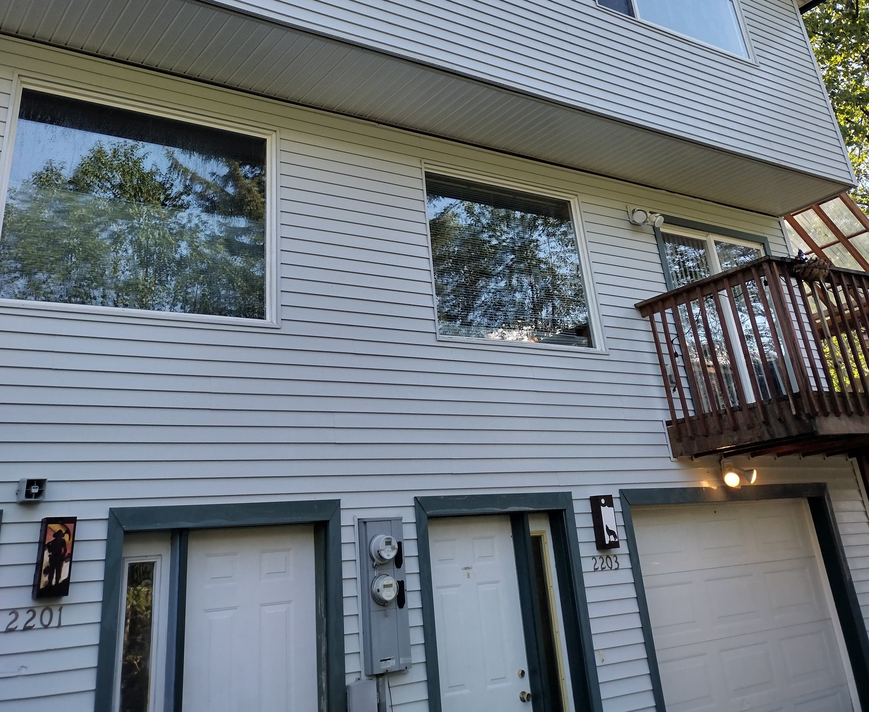

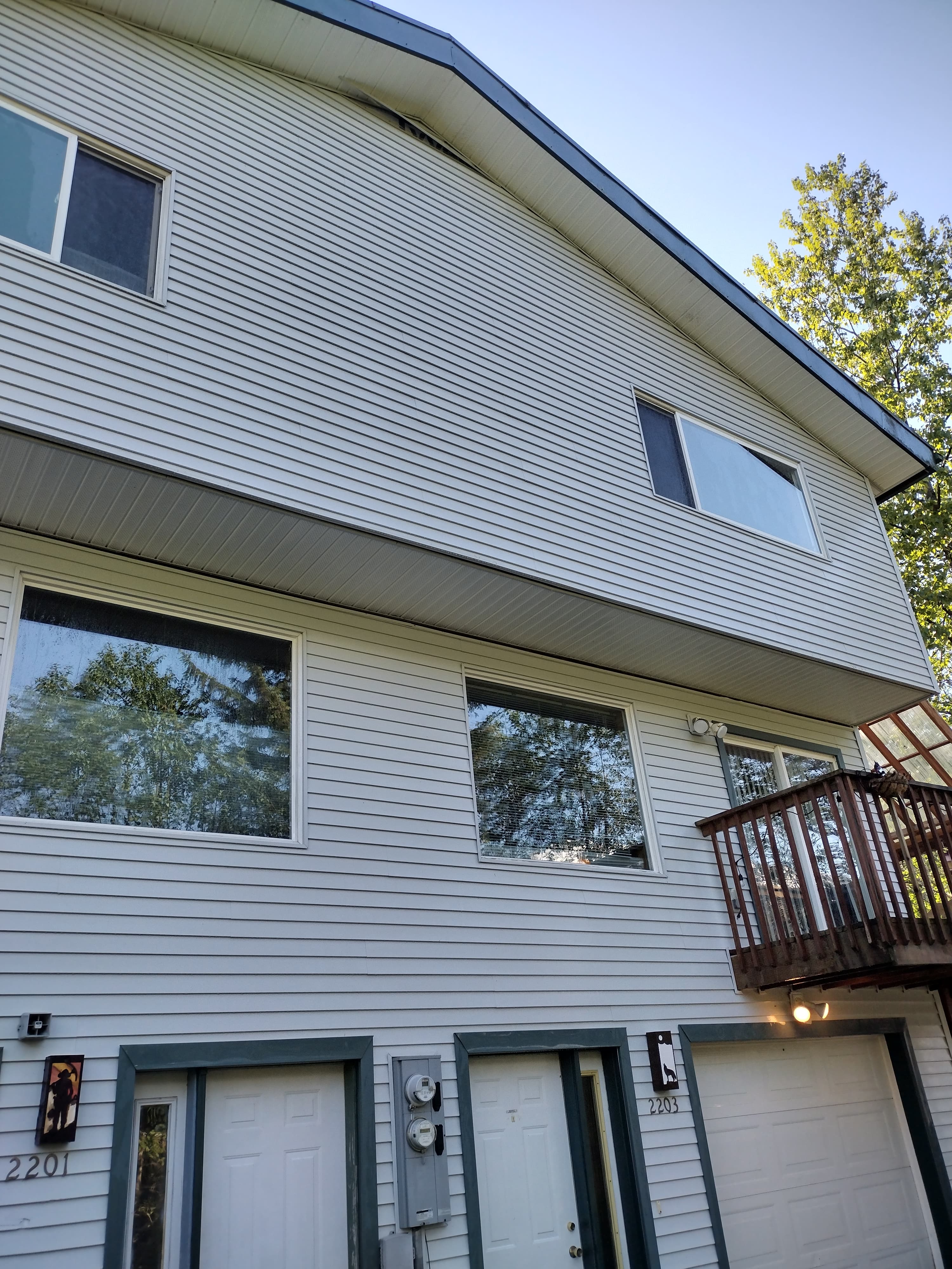

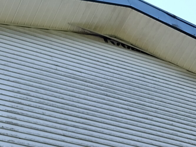

In my defense these guys left a buncha windows open and I had to work around that on their 3 story attached home that also had a gaping hole right at the peak. Just getting that out there

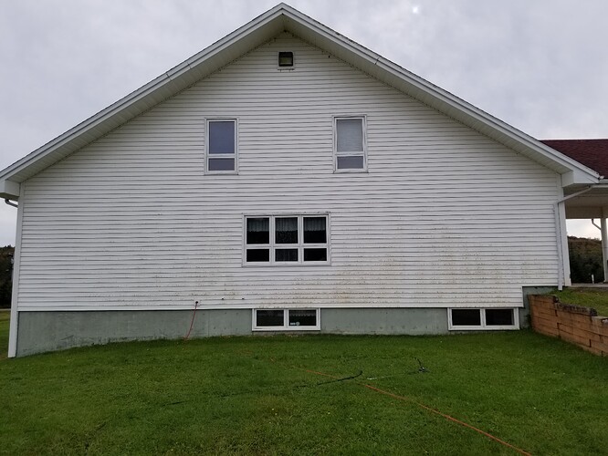

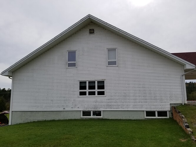

Downstreamed with 7.5 SH and arm and hammer with oxiclean inna 5 gallon bucket. Approx 2 ounces per gallon. Worked like a charm. Would hit a couple sides and then come back and rinse.
Looks good. You had to stretch that 4gpm to rinse that backside I bet. I remember those days.
This was after I did that deck from hell. It was like dessert after a meal you had to force down. Took me 2 hours flat from start to finish for both attached homes and they were very pleased with the results
Hasn’t been cleaned since it was built 30 years ago. All of the dark areas are lichen, wish I’d taken close ups. Window frames had yellow and red fungus looking stuff on them. Not sure what that was.
4GPM that pulls 9-1 with 150’. I parked close and only used 50’ to try to get the draw rate up. Used 10.8%. Put the soap on, let it dwell while I broke all of the lichen off with a brush. Probably 20 minutes. Rinsed and soaped again with another 5 minute dwell. Came out pretty good but there are still some small bits of lichen and anywhere it was growing there is light staining underneath.
