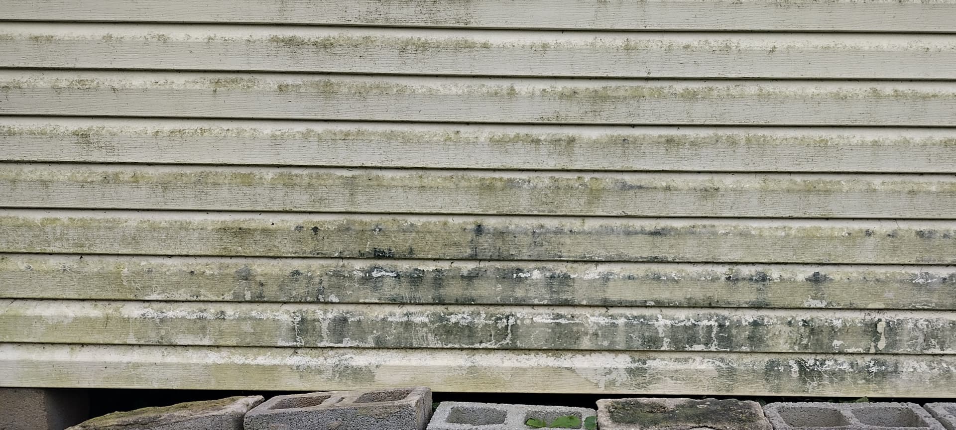

Here’s one I did last week. 2.1 injector on 8gpm machine. Straight SH with elemonator. Hit it twice with about 5 min dwell in between. It was a full basement house - the downhill side of that chimney was at least 50’. Standing on my toes with the shooter tip, lol.

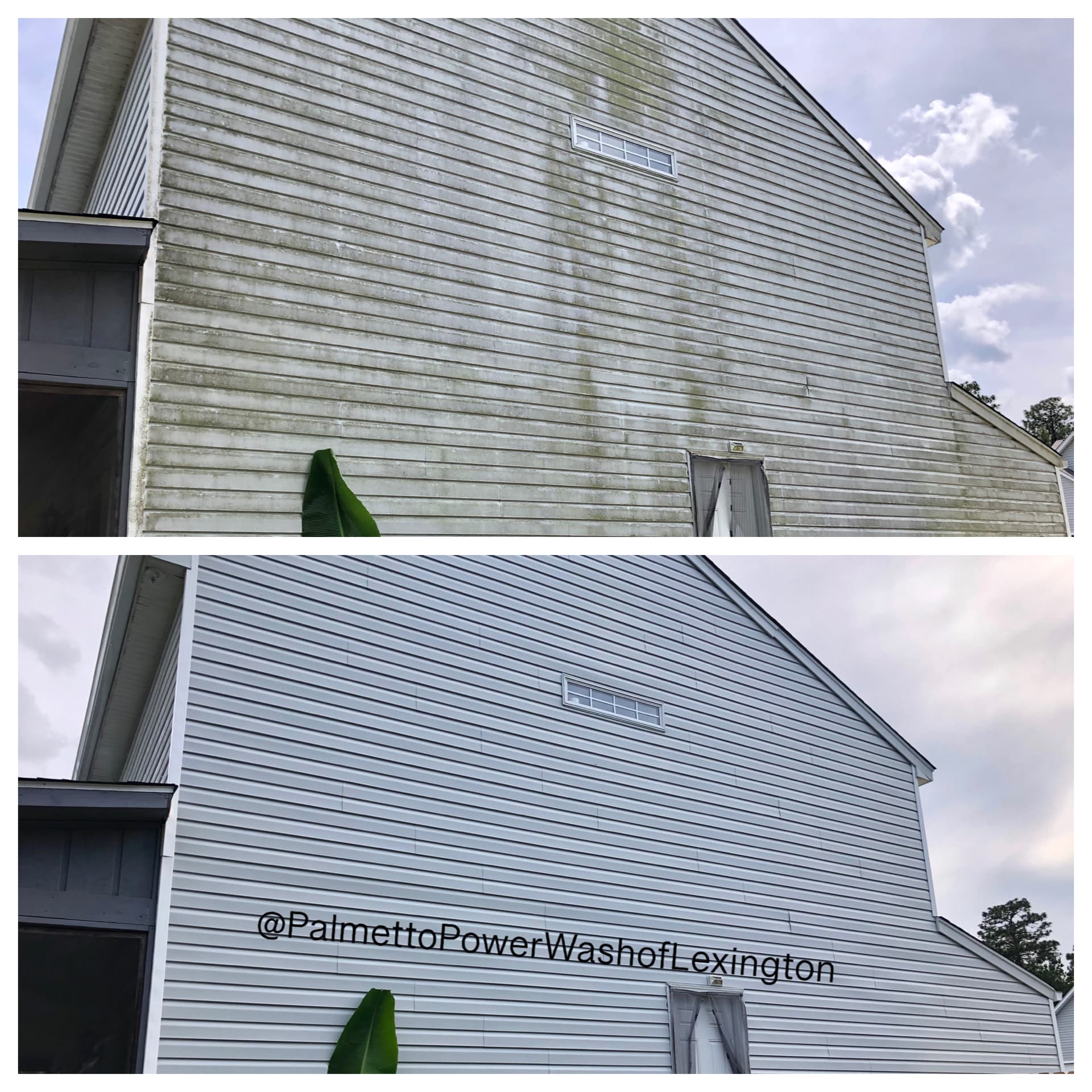

One that I did yesterday:
Equipment used: 8/3500 w/ M5DS
Solution: ~1.5% via 2.1 injector (12.5% SH) used my suppliers surfactant called “super bubble”
Process: apply solution via DS, dwell for about 2-3min, and rinse.
House hadn’t been washed since it was built in 06’ homeowner tried to do it with there own electric washer and decided that wasn’t going to work.
Putting this one up because it was a steel-sided house
(no, not aluminum).
Kinda fun. Still drying in the clean pic.
The second pic is just for fun. That’s not dirt. That’s all mold. As soon as I hit it with HW mix, it turned brown in about 20 seconds. The material was like beadboard.
Applied regular house wash mix. Waited a few minutes. Rinsed.
