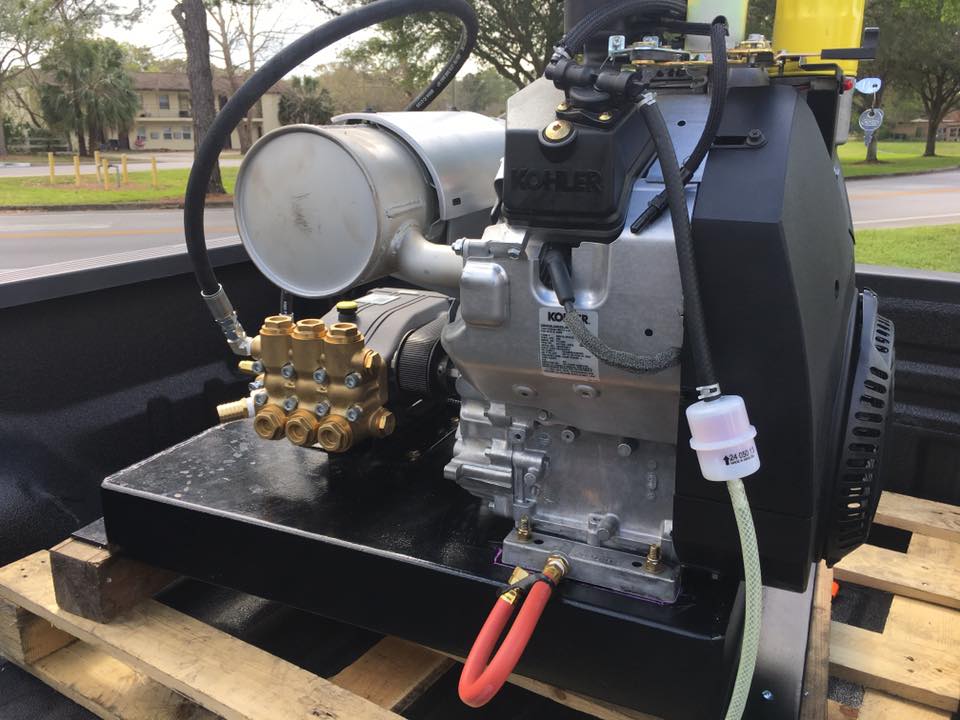

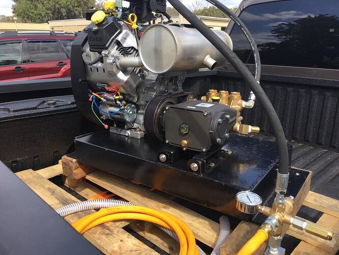

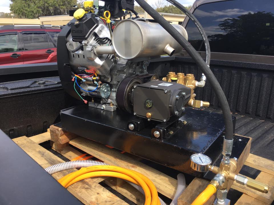

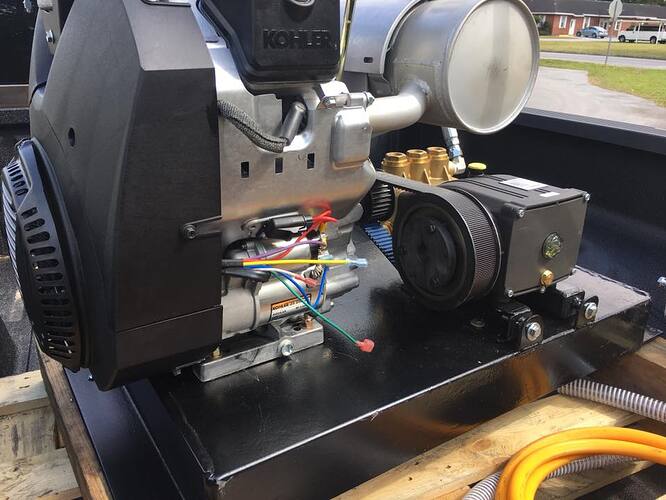

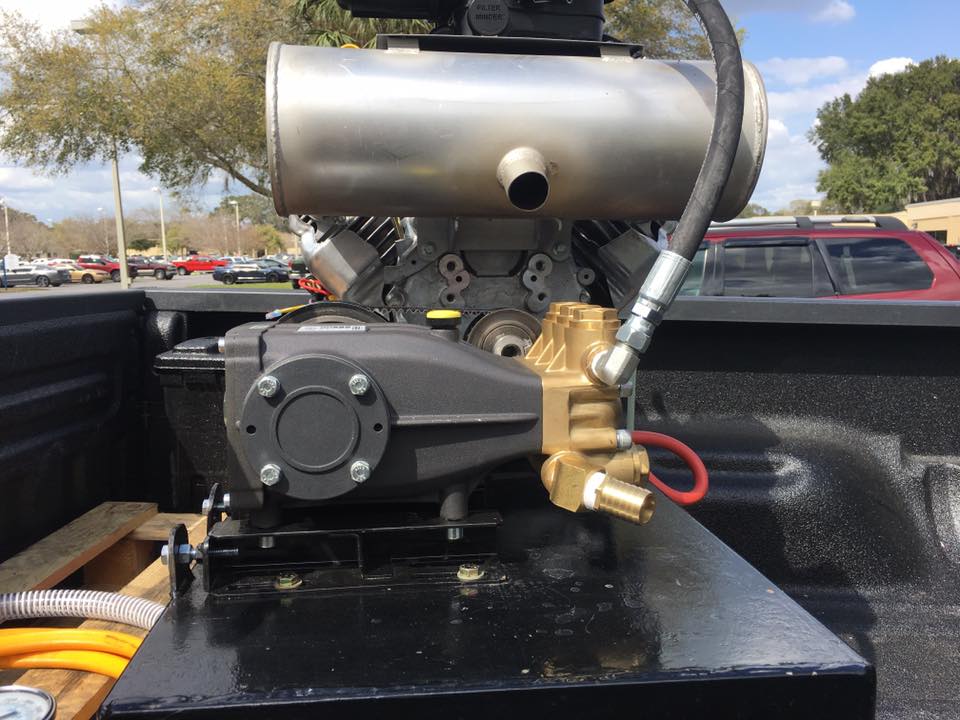

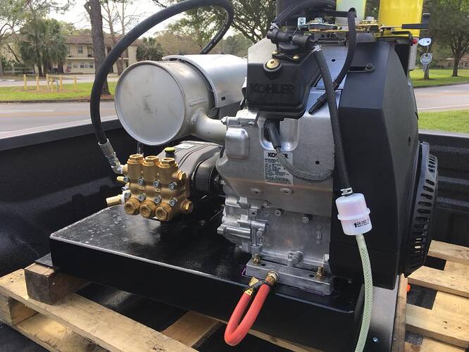

@FATJOE you have any photos of your 8 gpm machine? Ive seen the photos the power wash store has online but I’d like to see some with the steel skid.
I will get some this afternoon
Thanks!

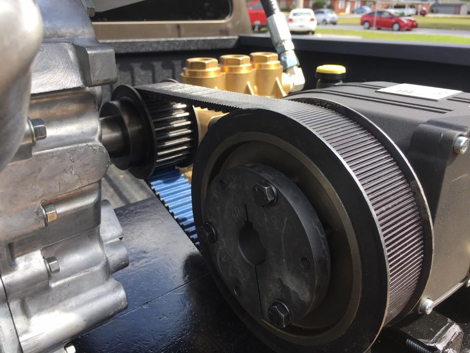

1 screw on the top of the belt housing and it comes right off
I talked with bill at pressure wash store today and the 8gpm 3500 psi belt drive water dragon comes on a steel skid and he offered free freight for what it’s worth.
Very nice lookin machine. Thanks for sending the pictures.

I have about $4300ish into this build… Its a Kohler 37hp, Legacy 10.4gpm/3625psi pump, Poly Chain driven. I promise you it will run circles around ANY “commercial” brand with a little Honda 690 engine that claims 3500/8gpm.
As some have mentioned on here, you cant get around physics and math when you compute your pump specs to get a desired HP. Any Flex in the frame will cause wear and tear. These thin cheap aluminum skids do flex!
My skid is a solid steel 18" wide C Channel that is 3/8" thick. The ends are capped off and welded with 3" angle iron. Skid alone weighs 143lbs. How do I know? I got it from scrap yard and they weigh it for sale. Skid cost me about $70.
You want bad ■■■? Build it! This entire washer weighs about 350lbs and it aint flexing one bit!
Legacy pumps are built to last. Look on their website. Clearly states that they ran their pumps several times DRY for 24hrs at a time and the pump had NO wear and tear. Try running a AR, GP, CAT etc pump dry for a few seconds and see what happens.

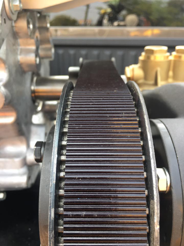

I notice in your pictures some kind of jig under your pump, which looks like a belt-tensioning mechanism. Am I right? Did you come up with that yourself? Nice work!
The pump is sitting on pump base. The 2 bolts on the side is a belt tensioner. I wanna redo it though.
