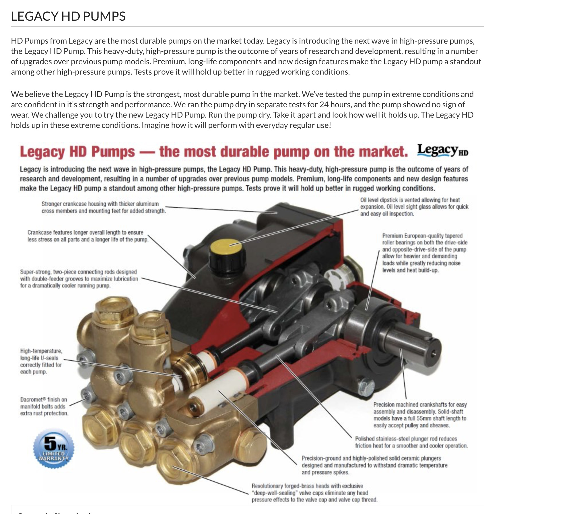

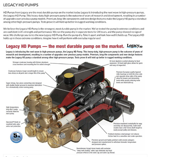

I’m not knocking you. Legacy has improved by leaps and bounds and are great pumps. They are almost on par or equal to udor. Udor did their run dry test about 10 years before legacy did. I completely agree that general, ar, cat and the others are junk pumps. Best thing legacy and karcher did was follow udors lead in 2009 and switch to u packs. You have a nice set up
Are Legacy and Udor pumps similar in price for similar spec pumps?
Free freight shows you what the markup is if they’re willing to give up $150+ off the bottom line.
Roughly same price and same pump. Legacy is a good pump. They have only recently stepped up their game and Udor has taken care of me so I’m sticking with them. It also helps that I got 6 nice hats from them for Christmas lol
