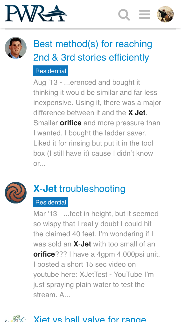

Search terms:
X-jet orifice
X-jet too small
X-jet step down
X-jet orifice replacement

@Innocentbystander I feel like this is one of your funny answers. Lol. I guess that could work tho if you figure out how big the hole needs to be… cant just go in there like a cowboy and ruin a perfectly good orifice. I’ll use the search bar to see if anyone else has done this. And squids even tho your being witty those search terms are legit, I’ll use them. Seriously. Thanks.
And btw squids. I already read the one about the orifice replacement. The topic started about the original question and ended with you guys talking about soaking tools in vinegar to remove rust. See what I mean? This is why people post new topics and ask for direct answers man.
