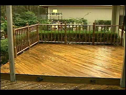

Conventional wisdom is that if any pressure is used on wood, it should be 1000psi or less, sprayed with the grain of the wood. Under 1000psi is achievable if you swap out the tips in the surface cleaner (though I’m betting that a lot of guys using SC’s on decks don’t know to do this). But there’s no way to go with the grain using a SC. How important that part is, I have no idea. I hate working on wood.
I would never use a surface cleaner on a deck and I would bet you money I could clean a deck faster with my wand and the right chemicals that you could with a surface cleaner.
This deck only took me 30 minutes from start to finish with Re-New-All from Russ at Southside. Pre wet, spray on, let sit, and rinse with low pressure. Like soft washing but for a deck.

What ratio did you use with the Re-new-all? That deck looks great!
@Steve did you reseal that deck when you’re done?
I used it at 10:1 with a 10 minute dwell time. Pre wet the wood and apply the renew all with a pump sprayer.
No that one but I have done others. I no longer offer a refinishing service, but I will prep decks for others who do it, or for the homeowner if they are going to stain it.
Same. It’s a hard no for me.
It looks great! I don’t have much wood deck experience sonI am going to practice on my in-laws at the end of June that looks similar to that one (maybe a little worse). I would be very interested in more info on how you treated that and what you would use to reseal.
After cleaning, I hit it with a brightener. The brightener restores the wood’s pH balance to a more neutral or acidic state so the wood “accepts” the stain better. It also enhances the wood’s grain. When the deck is dry according to a moisture meter, I would sand all the hand rails, blow it off with a leaf blower and apply the stain with a pump sprayer, and back roll it with a roller to remove puddles. I always used Baker’s Grey Away Stain from http://www.southernstainandseal.com/

Oxalic based?
I’m pretty sure that’s what it is. I’m no Walter White, lol, I just buy it and spray it… :sunglasses:
