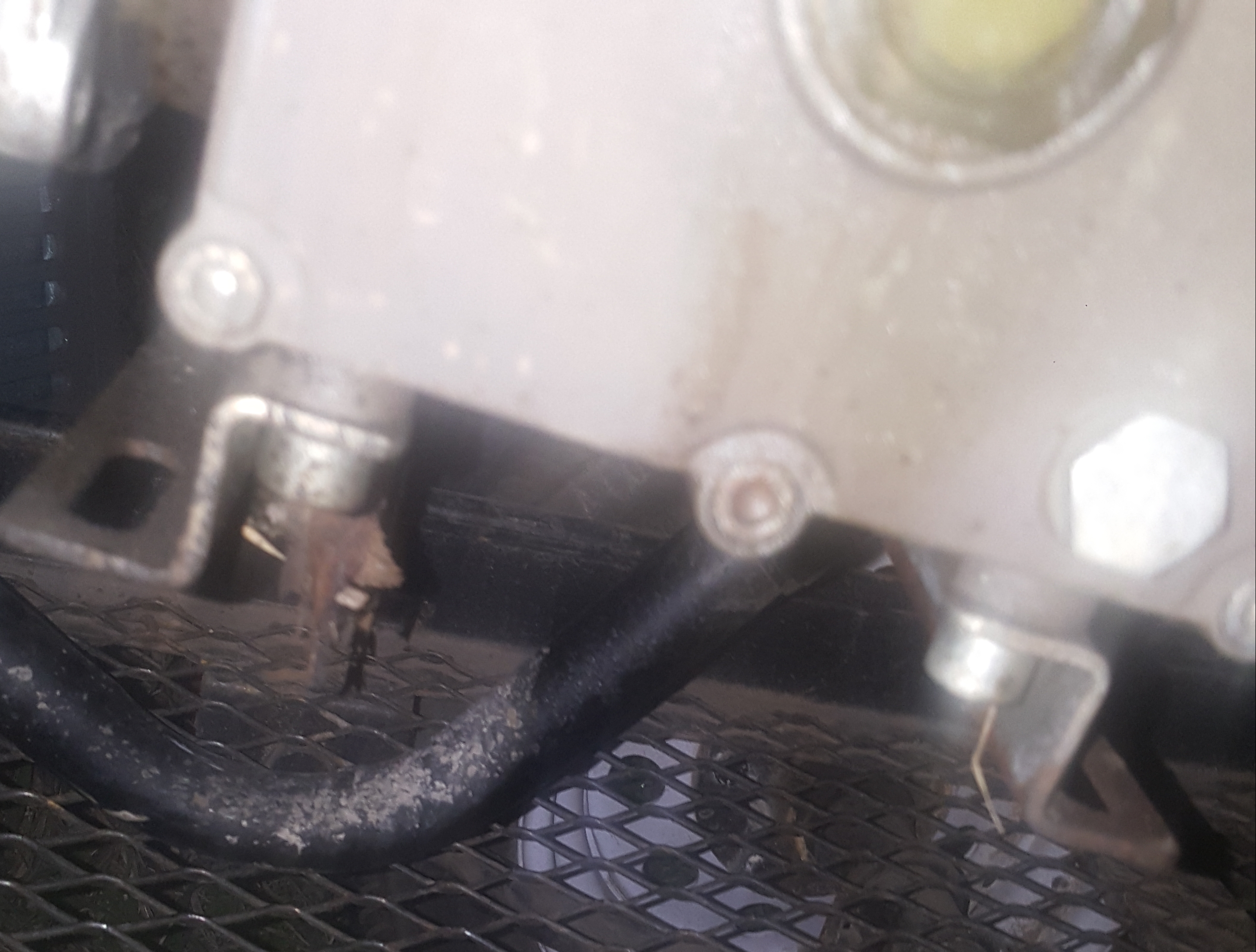

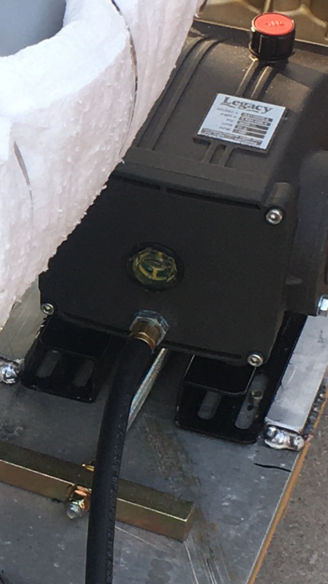

Ive only seen rails mounted in this orientation is all. Wider on bottom (these arent mounted to anything as its a geardrive, but rails still on pump)
My rails look completely different. They appear to be “boxed” in or a C Channel type.
Seems too flexy. I did notice some play/movement when you played the 1st vid. But the slomo reallly looks flexy. I would consider strong square tubing with bolt acess and holes in all the right places to go with the rest of all that HD skid.

sprockets are lined up perfectly. these poly chain belts move from one side to the other while running. Base as in the AL skid or pump brackets? I think the culprit is the pump brackets after looking at how much they give while under load. After all they are cheap a*s metal that is bent to form a bracket. Im going weld some square pieces inside the channels to lock it all up and make it “one” piece.

There shouldn’t be any movement in the poly chain especially side to side . Your brackets are probably causing that as well. Instead of welding up brackets. Have a machine shop put slots in two 1x1 squares aluminum bars. Will probably cost less than $50 and will be much more solid and last forever. That’s what I did on mine to clear 9” pulleys .
can you post a pic of your brackets?
Yah but not until this weekend. I’m working in Venice FL all week and that truck is working in palm harbor FL all week.
No problem. I’ll wait lol
I watched your video. Your probably right about just welding a plate on the side of those flimsy brackets
Was thinking of capping all 4 ends and maybe welding a piece or two inside the bracket itself

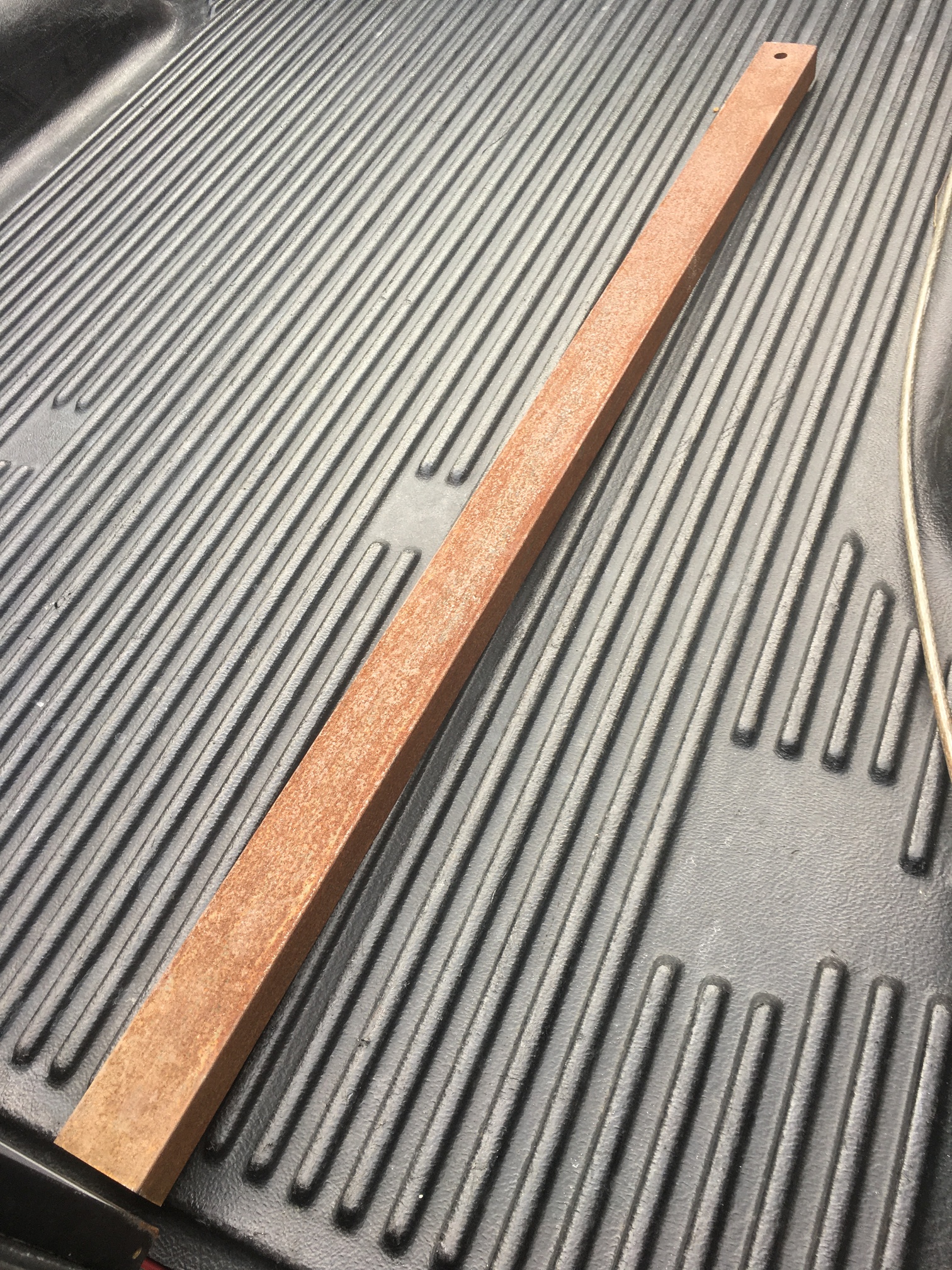

new mounts will be made. 1.5" X 2.5" steel
