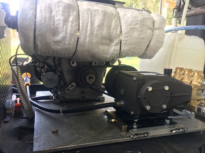

Whats the squealing noise?
Thoughts on where this squealing noise is coming from?
Only happens when i am squirting water. Doesn’t matter if engine is idling or at full rpm. When you get off the trigger, noise goes away.
I still get the noise when the engine is idling and I have water coming out of the trigger with no nozzle. Free flowing
Im thinking a bad bearing… But the pump is brand new

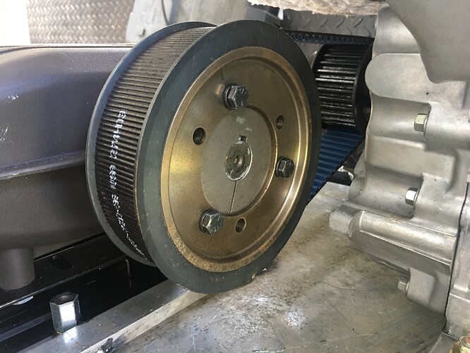

Frank if you take the belt off do you get the noise?

Sounds like the belt is way to tight
its not. its set to spec. I even loosened it up to make sure and same issue.
That’s sound to me like it’s coming from inside the pump under load. Check oil for metallic matter.
Then the shaft bearing is bad
I just put oil in pump… Not sure if I mentioned, but the pump is brand new. Not even 1 hour of use on it. Started this issue about 10 minutes after testing it.
