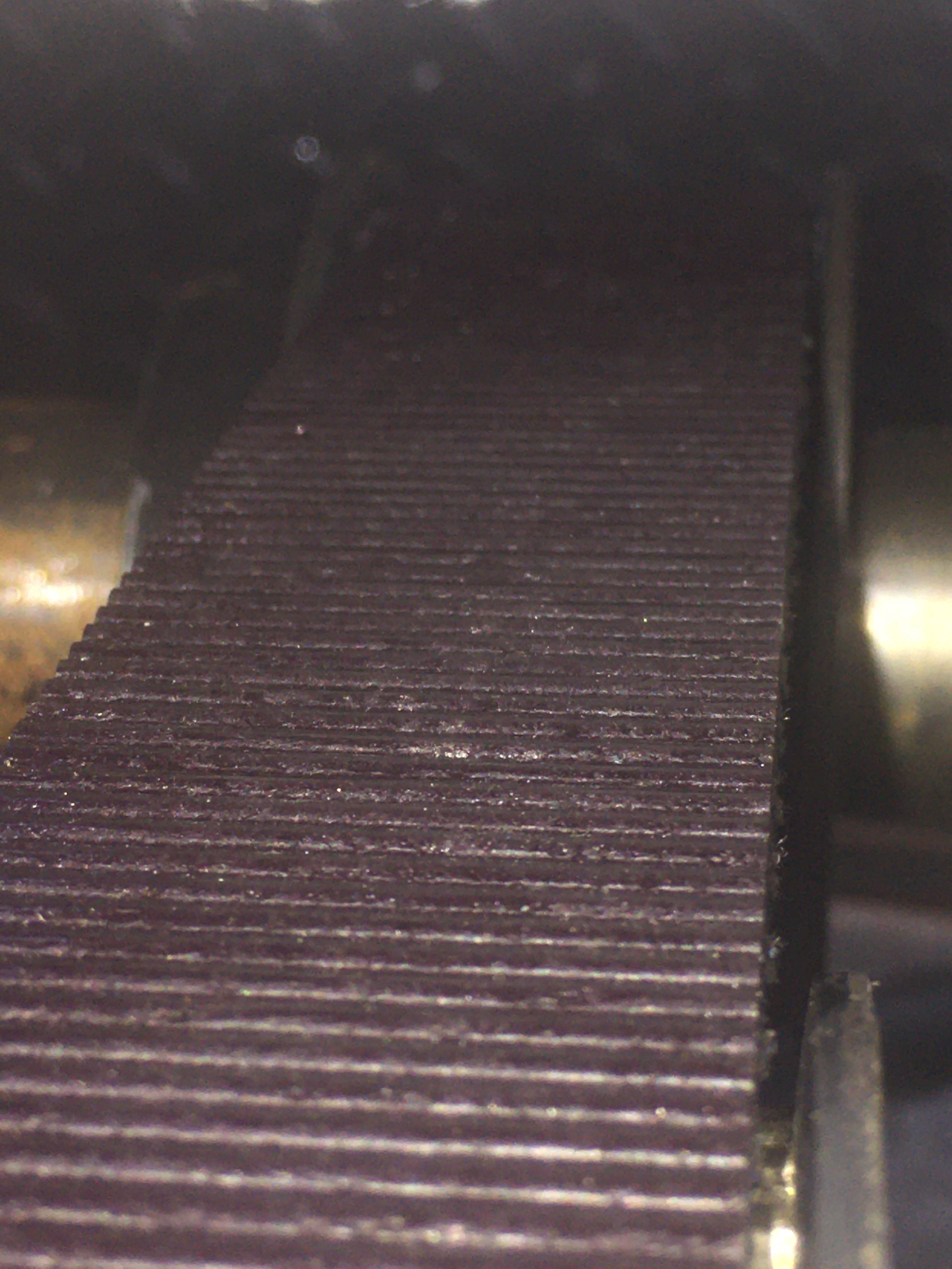

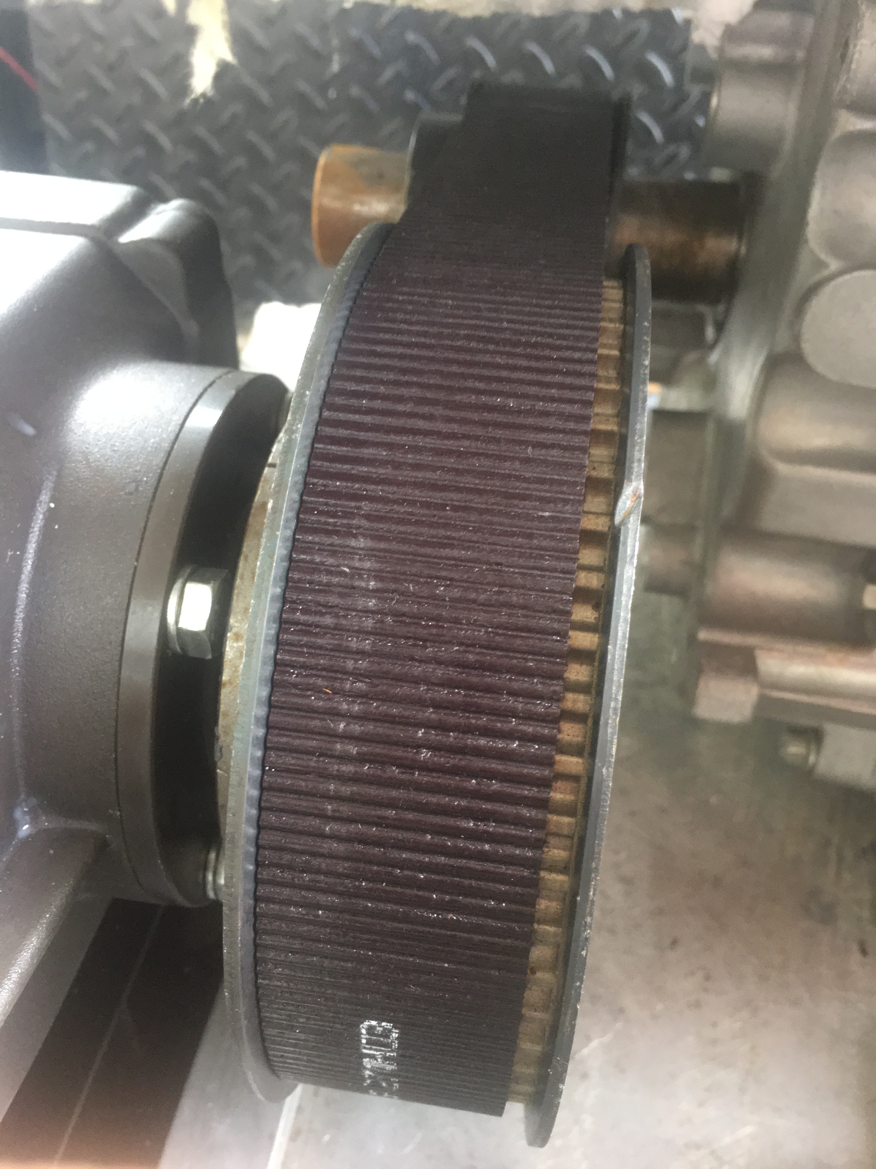

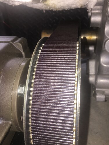

It sounds like metal to metal contact? Did you check the sides of the belt for wear.
I hope that fixes it but I dont think that’s your only problem.
Yes. Belt is good. no wear. when I re set the belt in middle of sprockets, these belts tend to slip to one side or another. But its not binding or rubbing
