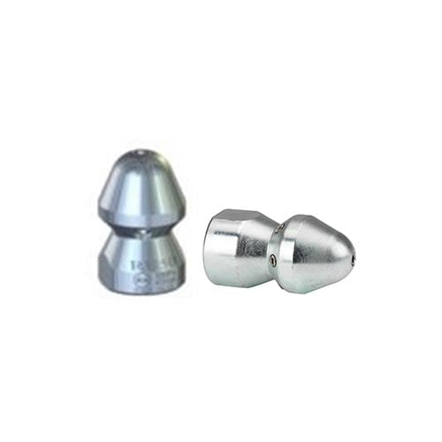

Use the right tools for the right job. Get a drain and sewer nozzle like this one:

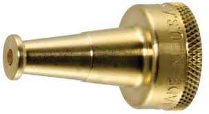

A lot of plumbers just use a regular sweeper nozzle and a garden hose. I had a bad clog over the winter and it worked like a charm. We couldn’t even use the shower because the water would back up that fast. I’m on a septic but I don’t see why it wouldn’t work the same. Mine was clogged right near the baffle because I could feel the nozzle hitting. It’s worth a shot.

You dont need to know anything about plumbing, get a sewer/drain tip, fish your hose until you feel the blockage, then pull your trigger. There is an extremely small hole at the tip to break through the blockage and once you are through it the back facing holes blast the rest of the blockage away. It works much better than a mechanical rooter.
