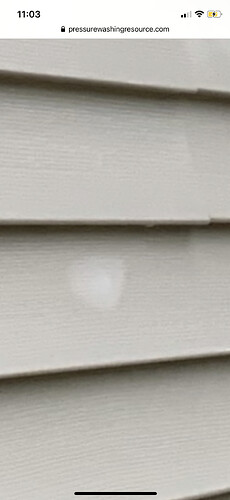

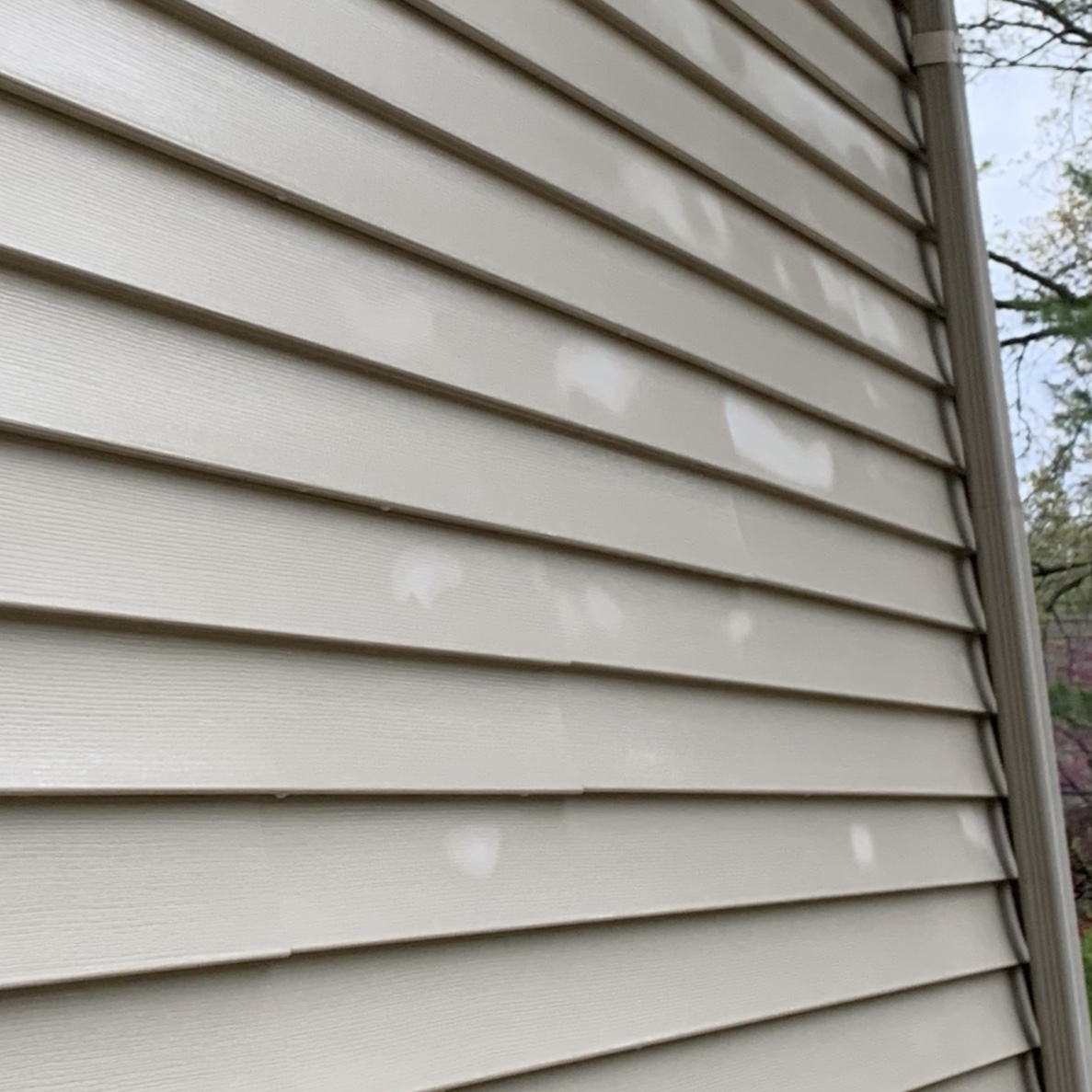

Reviving this thread. Swiped the house, no oxidation on fingers, I softwashed using garden hose pressure on the siding to apply soap and rinse and I have what appears to be oxidation spots. Any products out there or advice to get rid of this stuff ? !

Is the siding still wet the first few feet to the left of the downspout? Those blotches sure look bright.
Gutter Grenade will get rid of oxidation but it takes a little scrubbing. Some degreasers work too. If you don’t have one go ahead and get one of those green multi directional brushes when you place your order.
Siding was still wet and in the angle the pic was taken the sun was glaring off of those spots so y’all could see it better.

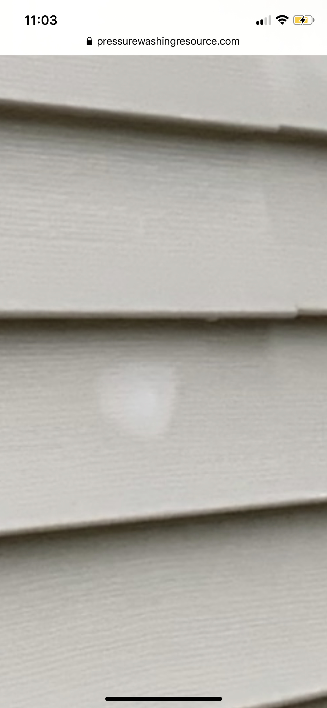

Either you removed all the oxidation off the siding and that is whats left, or thats not oxidation.
The picture makes no sense and the spots would be darker not lighter if you removed the oxidation.
Was that area covered in green algae prior to cleaning and you didn’t see those spots? Or were the spots visible prior to you cleaning?
Cleaning doesnt cause oxidation, it removes or disturbs it.
Need more pics.
I agree with 100% with @KMP . You didn’t do that unless you sprayed something weird on there. If you had disturbed the oxidation, it would look cleaner, not like that at all and it wouldn’t be just those few spots, tends to look blotchy, not definite marks. Did you try rubbing those spots or anything. Almost looks like where someone tried to smear something over where the siding may have been face nailed or patched. That is 100% not you.
It almost looks like finished sheet rock mud, sort of as if someone painted over a nail to cover it up, but I’ve seen nothing like that on siding, and check my early posts you’ll see that I’ve made about every mistake there is to make. That ain’t you, bro!
That’s what I thought! I told the customer it didn’t look like oxidation to me but maybe like heat caused it to shrink there or something cause discoloration. Idk I couldn’t wrap my head around it. The customer hasn’t called back so I guess I’m in the clear ! For now lol
