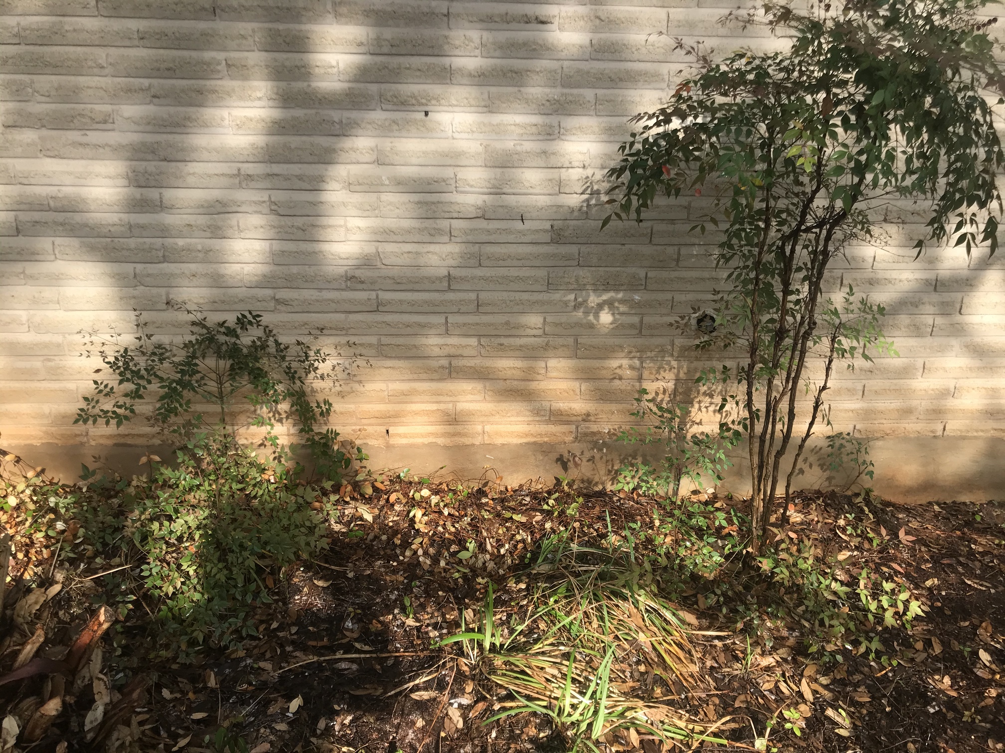

Hi, I’ve got a customer that lost some vines that covered his house this winter. They left behind slime brown/rusty colored stains. The rest of the house cleaned up nice, but I would really like to get these off. I tried 4-5% SH and a little pressure with no luck. I’ve got some F9 Efflo I could try and I’m open to other suggestions.
F9 Efflo, f9 barc, one restore. A good acid will clean that up. Let dwell. Wet any areas around it that you don’t want the chem on. Wash off. May need more than one application.
Thanks! I’ll report back in a few hours.
Thank you so much for the advice. Here’s a picture of the test area (it’s not the best). I treated the bottom two rows of bricks. I can tell a huge difference. My customer so far is really impressed with our work so I’m happy to be able to solve this as well. Ran out of time today, but we’ll get this done.
