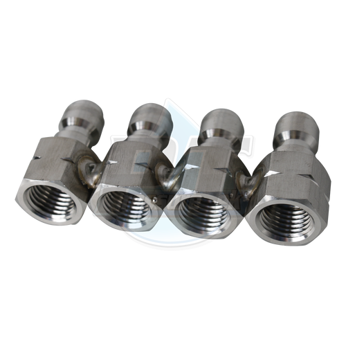

To “soft wash” you use a downstream injector
https://windowcleaner.com/pressure-washing-supplies/pressure-washing-injectors/injectors
And a jrod
Low pressure, high volume is soft wash
