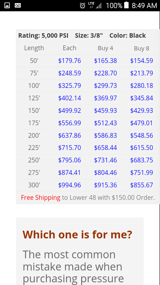

I did. 1 wire $2 a foot ,2 wire $3 a foot. 3 wire $6 a foot
Dang… that’s bonkers. Do you have Eaton, Parker, or Engineered Sales near you? Engineered is where I get mine. Eaton and Parker shops will be cheaper than yours.
