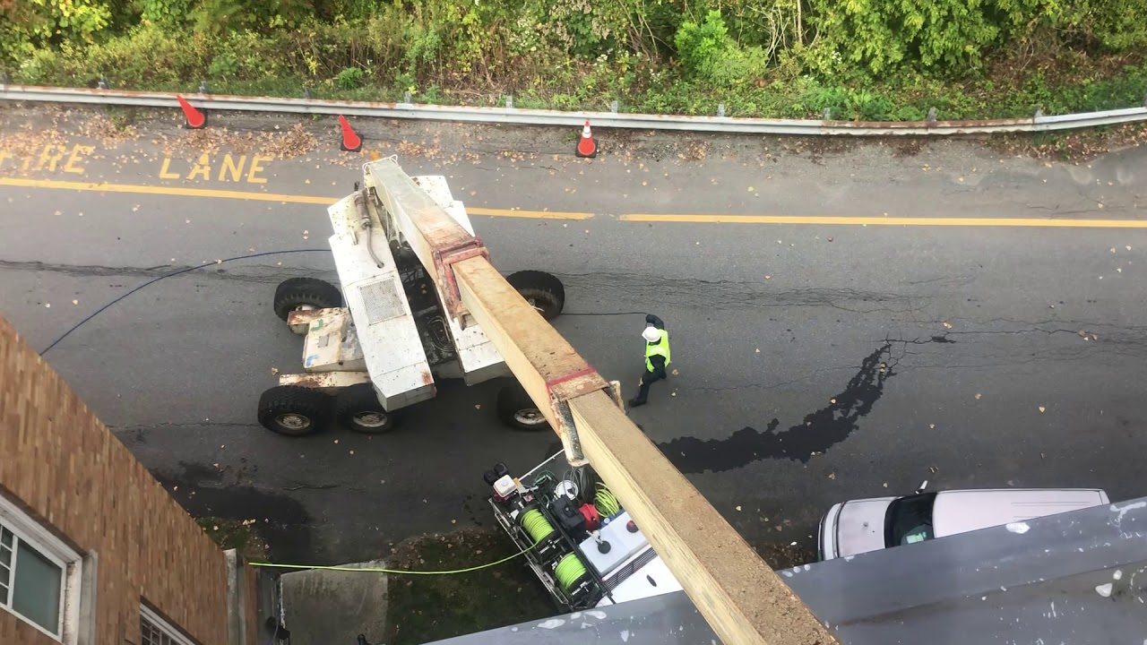

Here’s a little snippet of my first time up in the lift. That’s my dad on the ground in the hi-viz, managing my hose. This kind of project would be nearly impossible without a ground guy doing that.
The view here really is something else.
Good deal man, I’m glad to see your project coming to a close out there. I swear if you run over Dad, Mom’s going to have your butt. What caused the reason to run hose crossing the lifts path? I’m just imaging hose length between the lift and the building and everything between the two. I’m sure there was a reason for that???
Poor planning. We had worked in the other direction first, and when we turned the boom around, we realized the hose was in the wrong spot. We got it straightened out after we finished that section.
Once we got our bearings, all my dad really had to do was try and keep the hose from snagging on trees and corners of walls.
