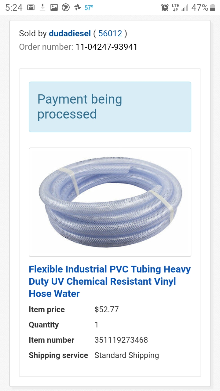

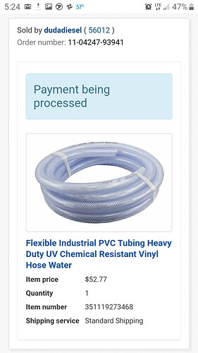

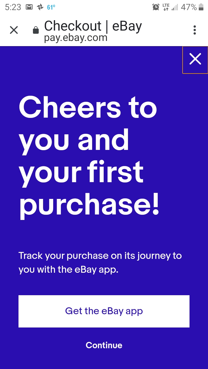

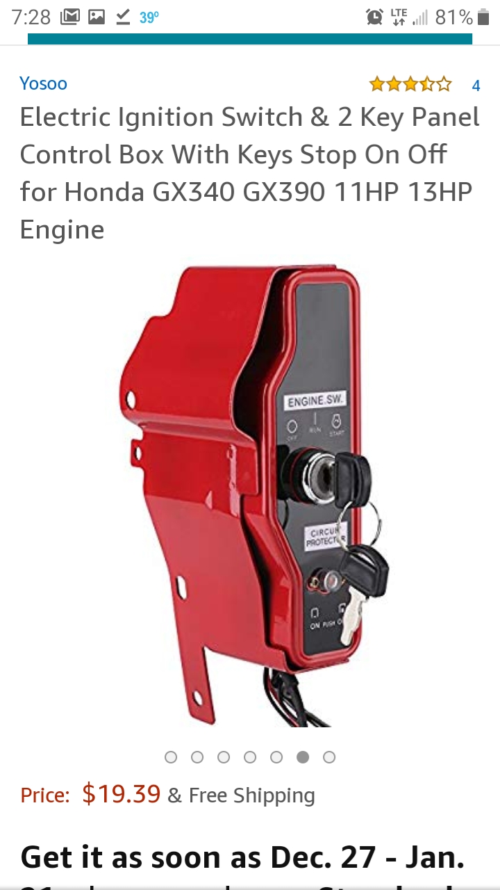

I’m an EBAY user as of today …
I’m pimpin now ! :rofl::joy:
Had to get that to, the 1 wire coil isn’t making the motor run right, so I’m going back to the 4 pin coil and new key switch.

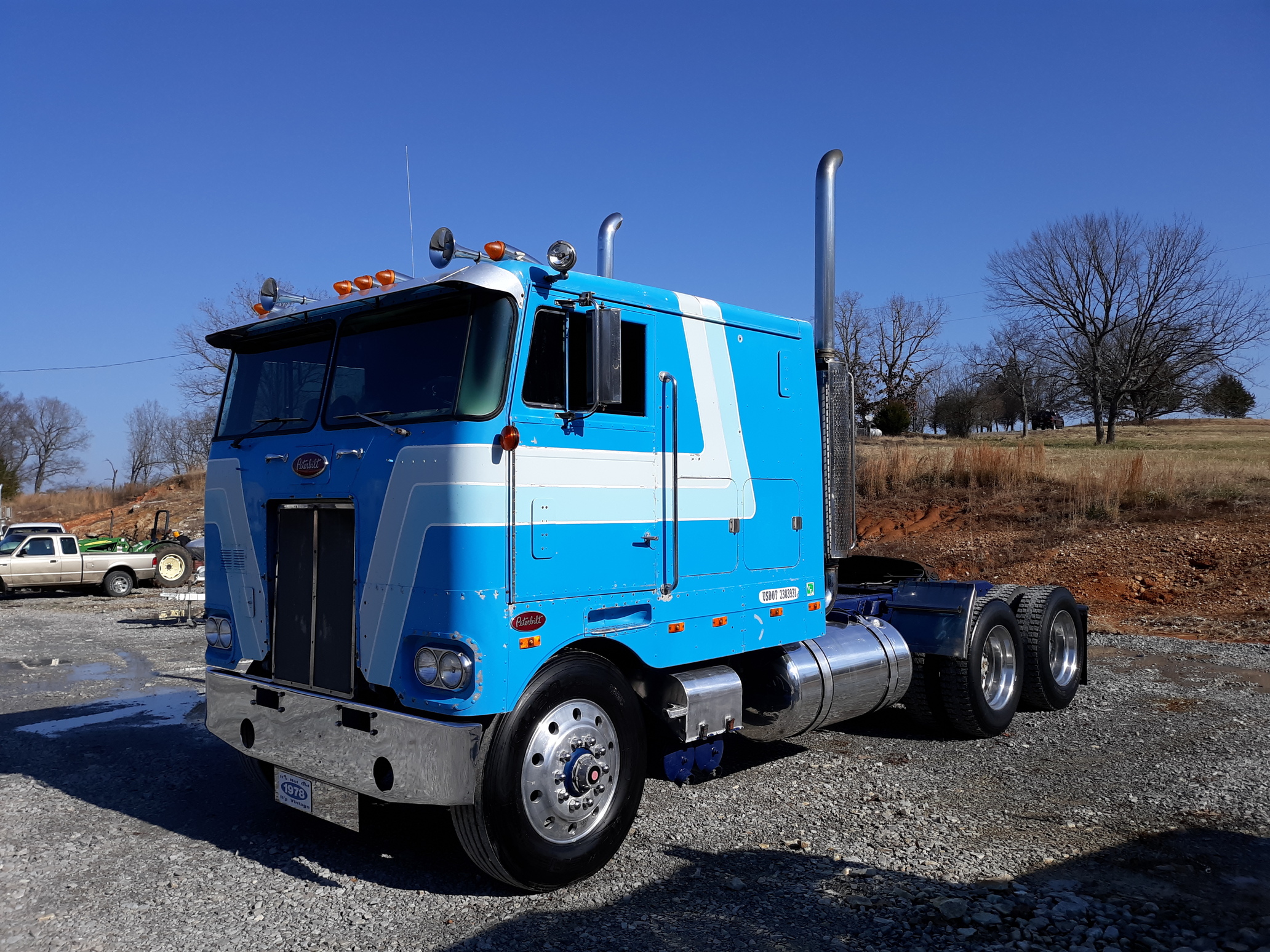

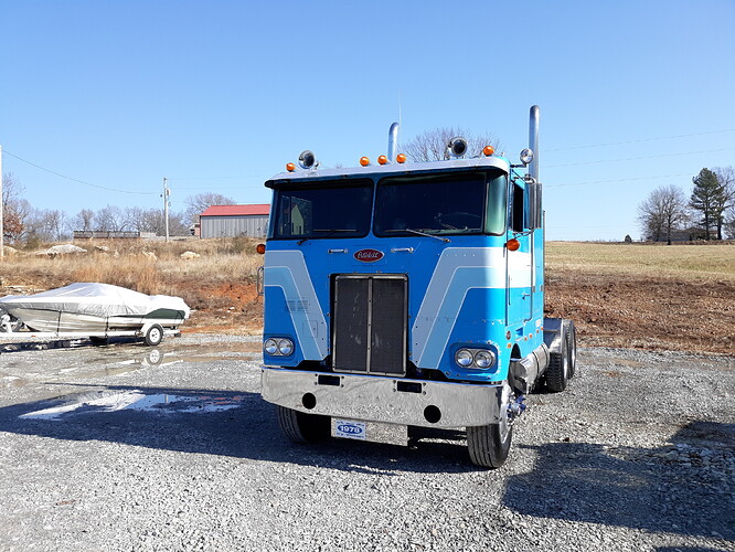

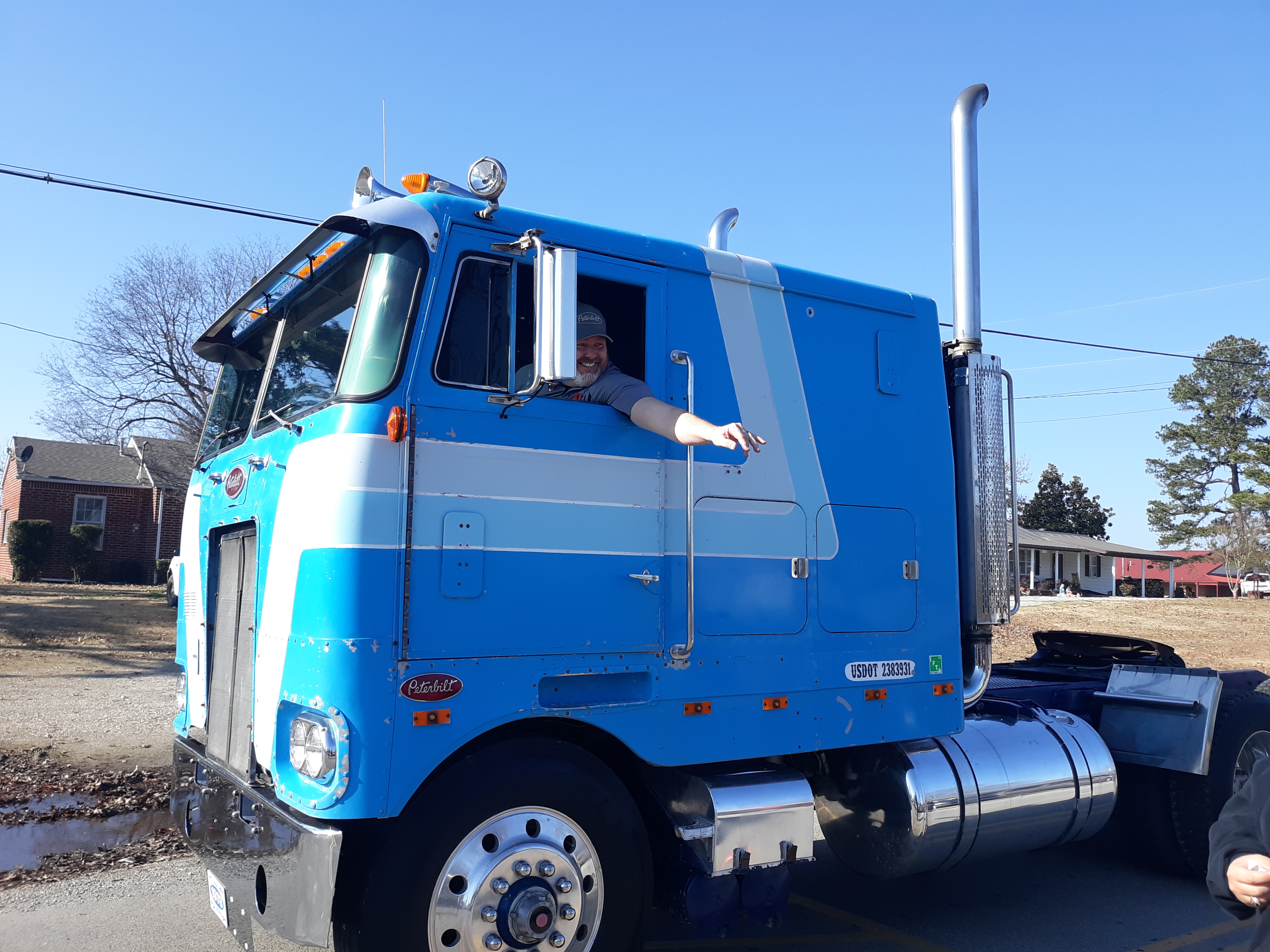

Gotter shined up for the Christmas parade today, Old turd still looks good.
That truck is awesome. I want it.
Uploading: 20191207_131201.jpg…
Me to! I’m just the hired hand to wash his plunder every week. He’s got all kinds of cool machines.
I love the old cabovers. I’ve been following a guy on YouTube that is restoring an old International cabover right now. He uploads almost every day too so it’s cool to see his progress.
Me as well, what I don’t like is jacking the cab up to wash the motor. lol
