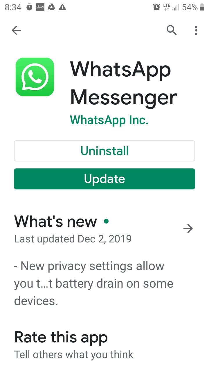

I’ll do a video test for you on what HCS 400 or Dyna clean will do to aluminum, Then I’ll show you how I remedy that in less than 60 seconds, but you gotta get the Whatts App. That’s the only way I can video without pulling my hair out lol.
@Hotshot what is this app you speak of? I wanna watch.

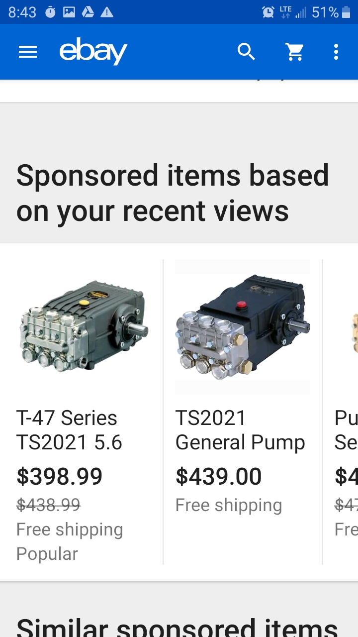

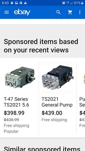

Hey @dperez what’s the difference in the 2 ? Other than appearance
@Hotshot I think the only difference is the roller bearings it’s just the new model. I could be wrong
I think your right, I do recall @dperez mentioning that a while back.
