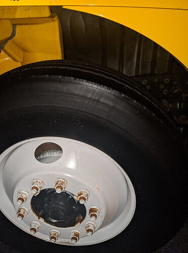

Went out and cleaned one of my moving company trucks tonight. 9 trucks in total. I wanted to experiment tonight with the tires tonight. So here is what I did and the results:
Mixed equal parts Dyana-Clean and Bright and Water - 3/4 gallon each
Threw in ~2 cups of HSC-400
Cleaned my trucks as normal and when we got done we used our pump up sprayer with our new mix and wetted each tire with zero scrubbing.
Here is the results:

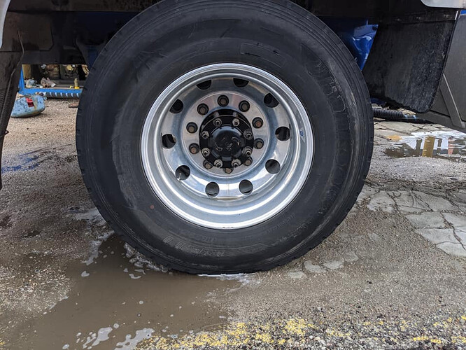

This is from an earlier post in the thread with just 2 stepping the wheels:
HUGE Difference!
They look great man, exactly like mine but you just keep adding up the steps don’t you?
