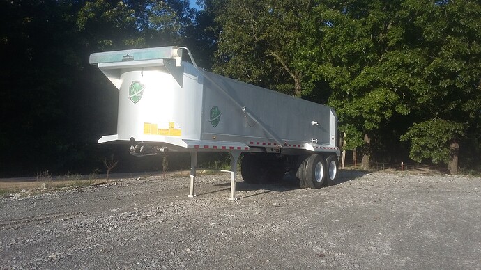

Iā€™m doing a truck tomorrow for a local mechanic, he wonā€™t work on them till there clean. Hear is a pic he sent me today ,said it hasnā€™t been washed in over 9 weeks,Iā€™m gonna do it all in HF and Dyna clean, including the motor bay,the only brush Iā€™ll use is a stack brush, send you a pic when done.

Sorry,They dropped the trailer and put the truck in the shop before I could take an after pic. Anyways, no brushing except stacks, 9 weeks without wash ,frac sand hauler on dirt roads ,7 loads a day.
Looks good!
Thatā€™s weird that they donā€™t have a belly dump on that trailer.
They do @DisplacedTexan . You know the save $9000 a year on insurance running them belly dumps ? Wow.
Man I bet. Those things make a load so much faster.
And way safer.
Iā€™m just letting you know ,those propane trucks can be brushless, even after a month on nasty roads. Hence the pics
