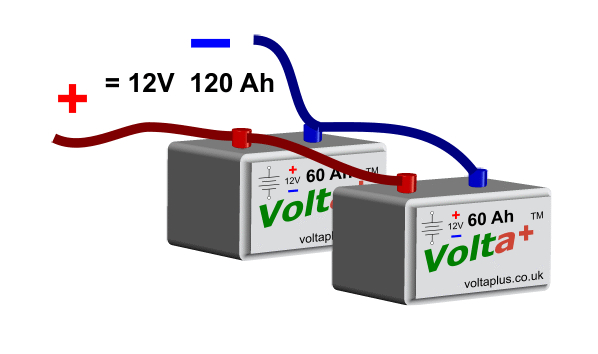

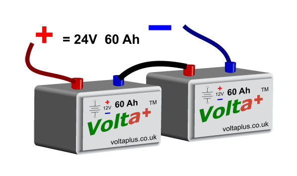

You have to hook the grounds of the two batteries together or you’re not in parallel. Just google and you can see an image of how to hook batteries up in parallel and in series.
Here you go Sean you can see how hooking them up differently gives you different results. You want the same 12v while increasing AH depending on how many batteries you want, you can add as many as you want.image image
The first one is parallel while the second is hooked up in a series.
