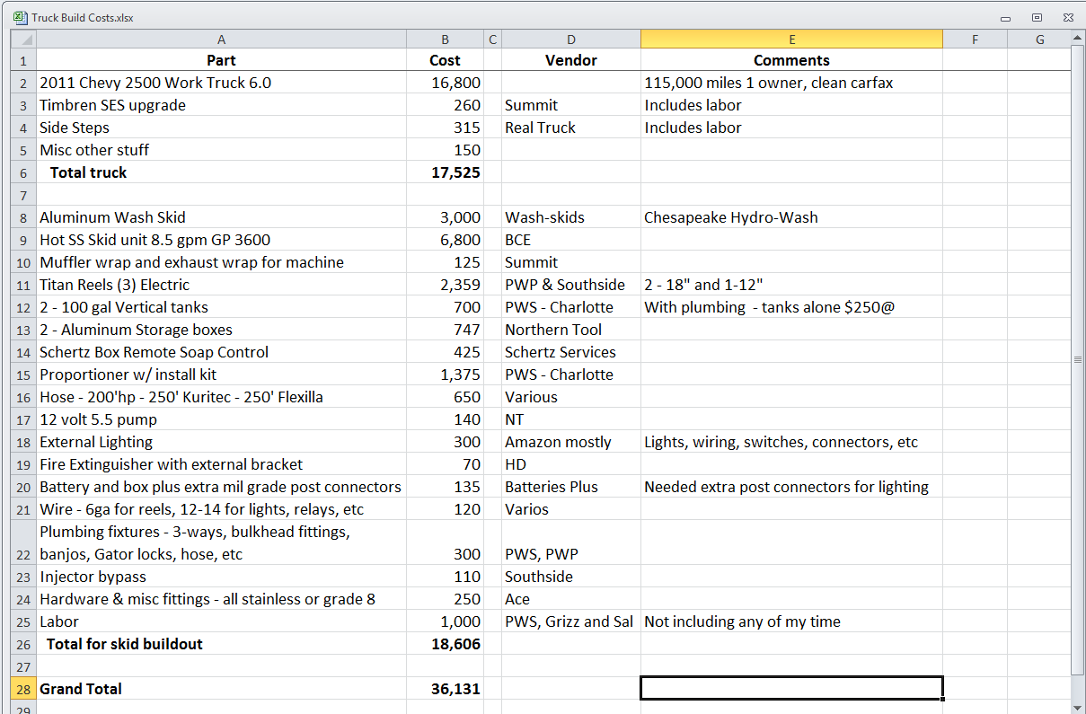

Ok guys, truck build is officially finished. Final lighting got finished today. Few teaser photos and complete cost breakdown. @Infinity - we’re still waiting, lol.

@Racer That’s a really nice rig, judging from the breakdown. Thanks for posting your build list…so helpful!
The breakdown shows Timbren SES bags for $260.

I dont know the brand names lol. That’s a great price though. All the ones I’ve looked at are 400 plus.
They’re like $215 plus tax, then my car shop guy charged me about $30-40 to put on.

Nice! Can’t wait to see the whole thing. What’s that 5.5 gpm NT pump, are you trying out the bleach pump they’re selling?
