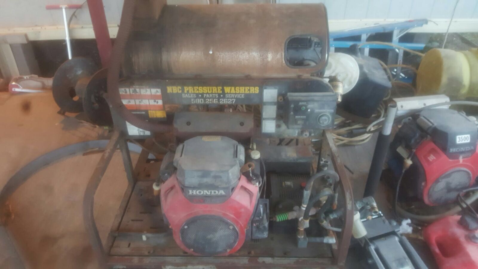

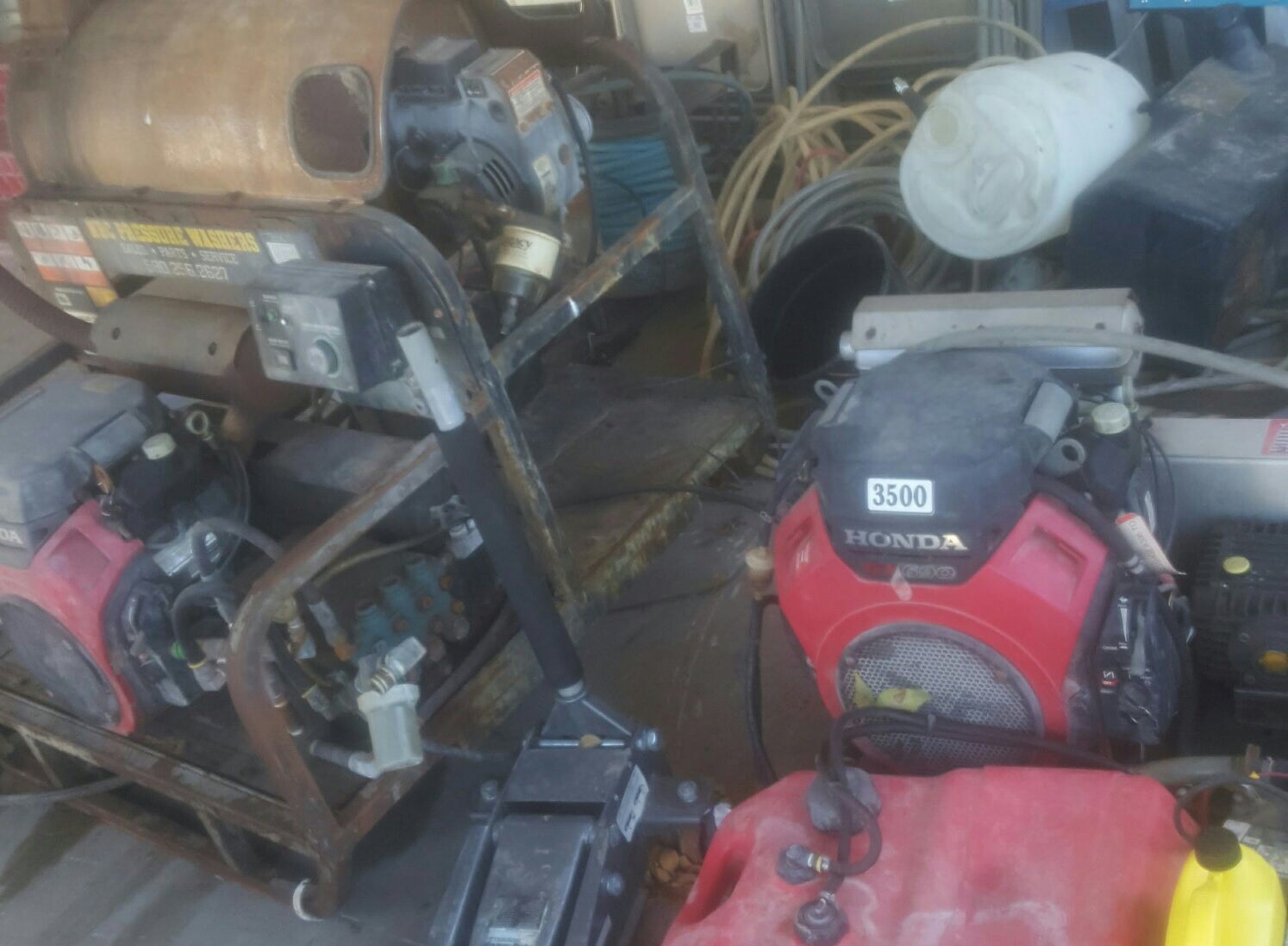

I’m excited to get this rig set up. Some of the stuff I’m not real excited about but it’ll work for now. I was mainly interested in the machines but I threw him an offer on all of it and he took it. Everything works awesome. I’m excited to make some money with them.
The cold water is 8.5gpm and the hot is 6.0

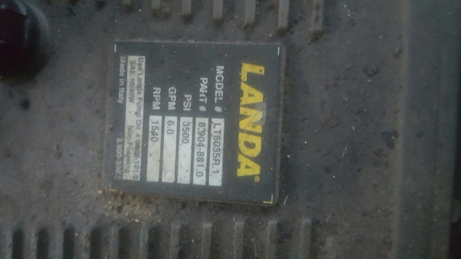

My 8.5 is cold 3500
6.0 is hot 3500
I don’t have the system set up yet, I bought it from a guy who did oil field fleet washing primarily so I don’t have a surface cleaner yet. I was looking for recommendations. I’ve heard with the big guy sc you have to walk slowly with 8gpm.

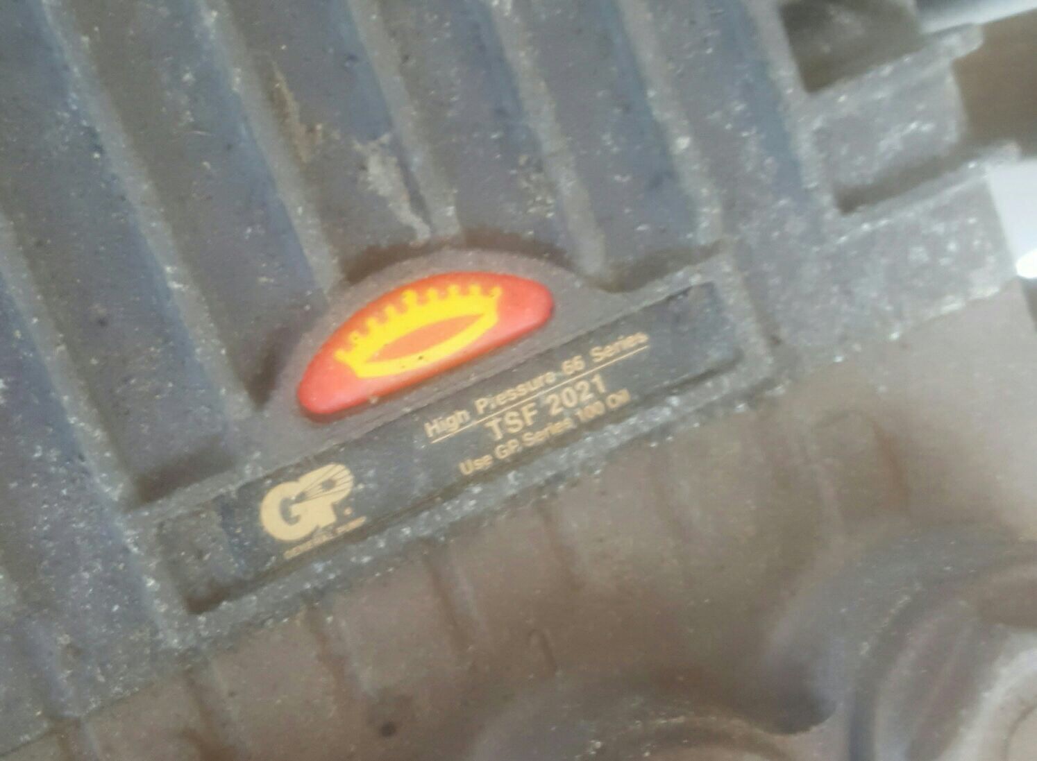

Oh… I’m following you now! You have the TSF2021 and it is spec’d at 8 gpm at 3500 psi. You need to always use one 8.5 nozzle or larger at the gun. If using a surface cleaner, 2 nozzle spray bar, use 25 degree 4.5 orifice nozzles and if using a 4 nozzle spray bar, 25 degree 2.5 orifice nozzles. Those are important numbers to know.
The 6.0 at 3500 is calling for a 6.5 orifice nozzle at the gun. That’s an odd one. We would suggest two 25 degree 3.5 nozzles on a two nozzle spray bar. Don’t use a four nozzle bar on that unit.

The TSF2021 has a 3/4”’port. We have a barb is 1.5” x 3/4” (part 5049). Cat Pump suggests in the literature to move up in hose ID sizes. When the 8gpm units first became popular we had guys coming in with constant problems until we perfected the plumbing. We upsized the plumbing and stopped seeing guys in for repairs. It was even worse with hot water units plumbed with 1” suction and 3/8” outlet hoses.

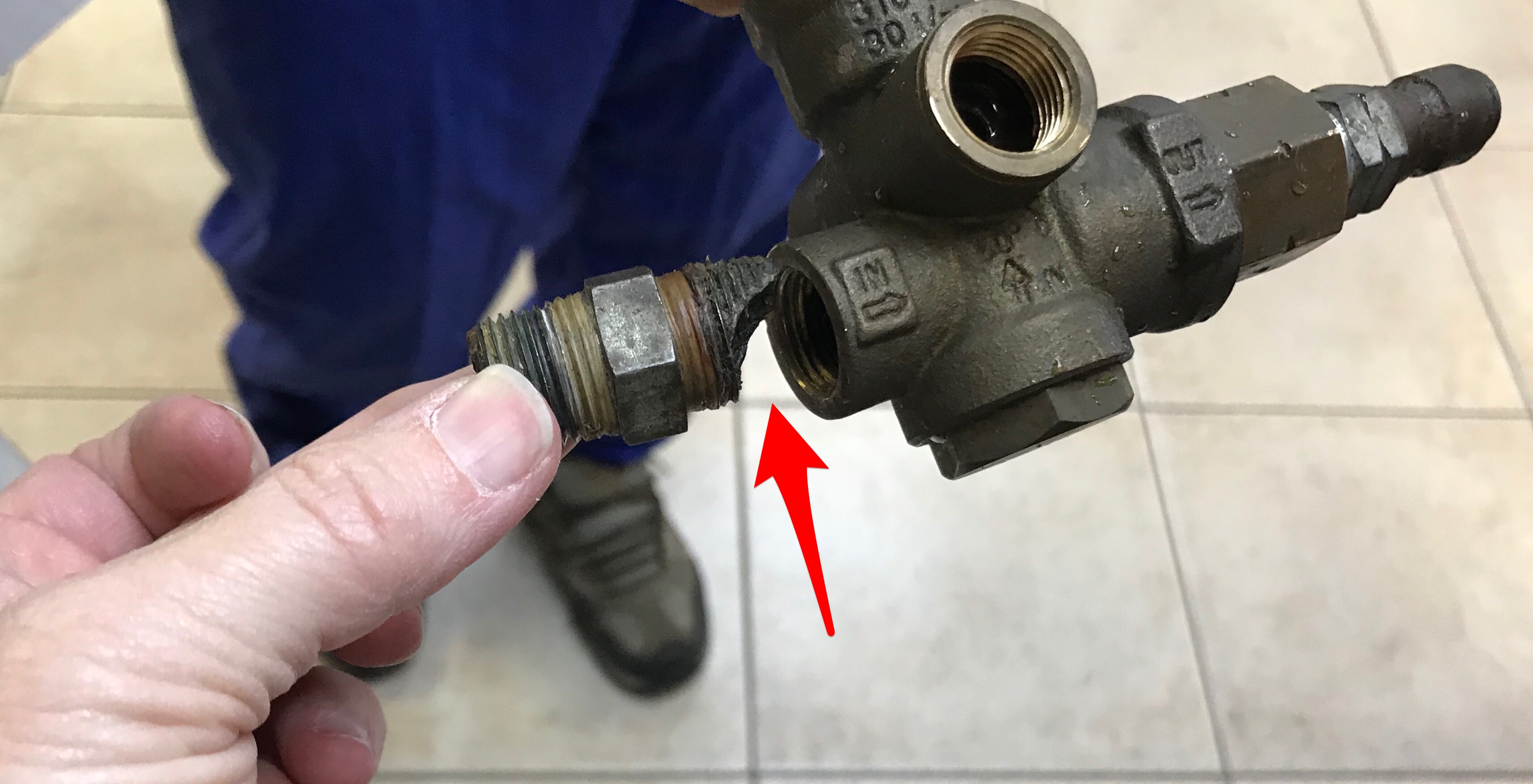

Always remove the injector when not in use. Always install the injector closer to the reel than the pump. Look at the pic of the hex nipple. The customer wondered why the unloader stopped working…
We’ve had a few people call the office to tell us about the pump specs. The TSF2021 has a 3/4” inlet on both bottom ports of the pump, I promise. :slightly_smiling_face:
Please see the pump spec sheet below from the General Pump site.TSF2021 Pump Breakdown
The TS2021 has two 1/2” inlets and should be supplied with a 1” non-collapsible suction hose. Pressure Pro privately labels the TS2021 as the HP5535 (brass head). If you are proactively maintain your pump and want to save bucks, you can choose the brass head over the nickel plated head of the TS2021.
TS2021 Pump
