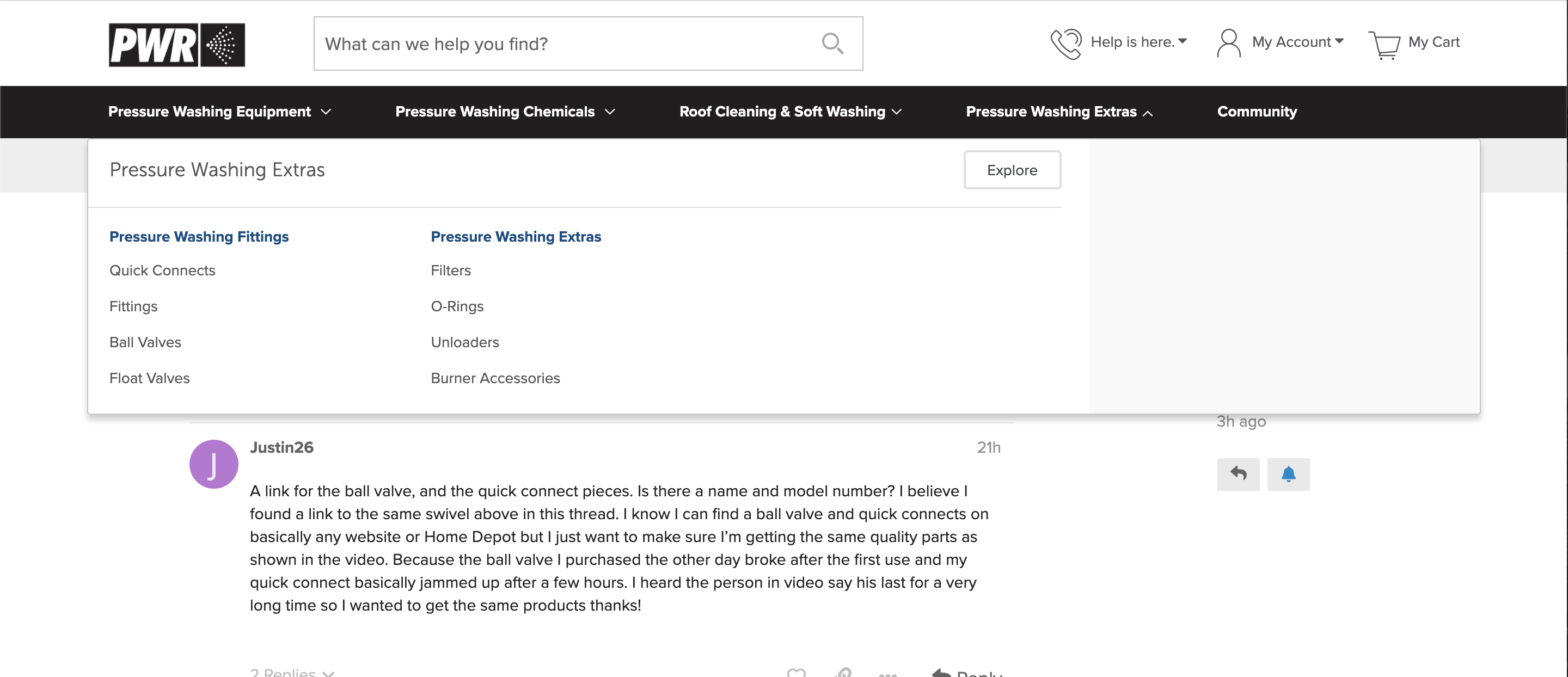

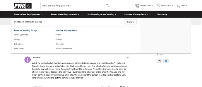

Don’t buy junk from HD. I showed what you needed in the video including the prices and also told you to call a pressure washing distributor. All you had to do was tell them you wanted a ball valve assembly and they would have hooked you. So be glad that there is someone on here nice enough to take the time to look up the items that you could have done. That wouldn’t be me. I’m working about 80 hours/week right now.
This website that you are currently on literally has drop down menus with equipment and chems for purchase.
