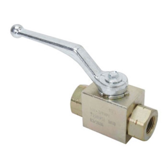

Just seen this thread and wished i seen it earlier. Just got a raptor blast high pressure ball valve today in mail and out the box the valve wont open. Cant turn it. Do they need to be under pressure to turn?
If it looks like this then you bought the cheapest hp ball valve you could have possibly found. If so it’s rated to 7,500 psi and I would venture to say that’s why you can’t turn it lol
I run 2k psi valves for my machines not yours with no issues
Get the black handled high pressure ball valve. It’s a lot more compact which is nice.
This is the ball valve you need period
I run that 1, right of my unloader for making adding ds inj easier when needed. Under load it is tight to turn.

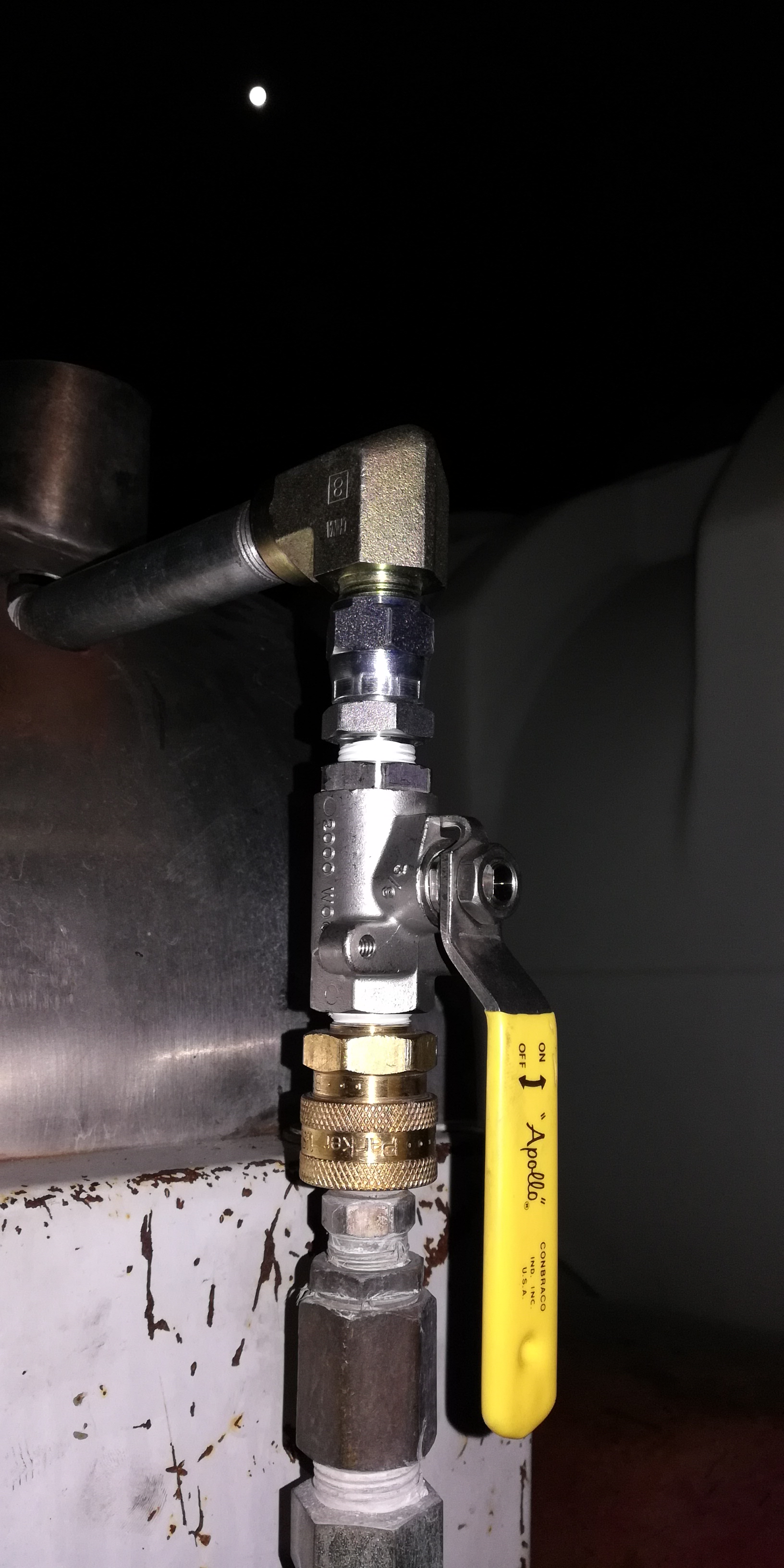

I feel for you! I can turn mine with a pinkie. I run Milwaukee, Apollo and Sharpe 2k SS valves
I take comfort in the fact that it won’t get turned on accidentally, but maybe over time ill chsnce my mind. Plus I’m running about 3k psi
3k on a 2k valve is no big deal

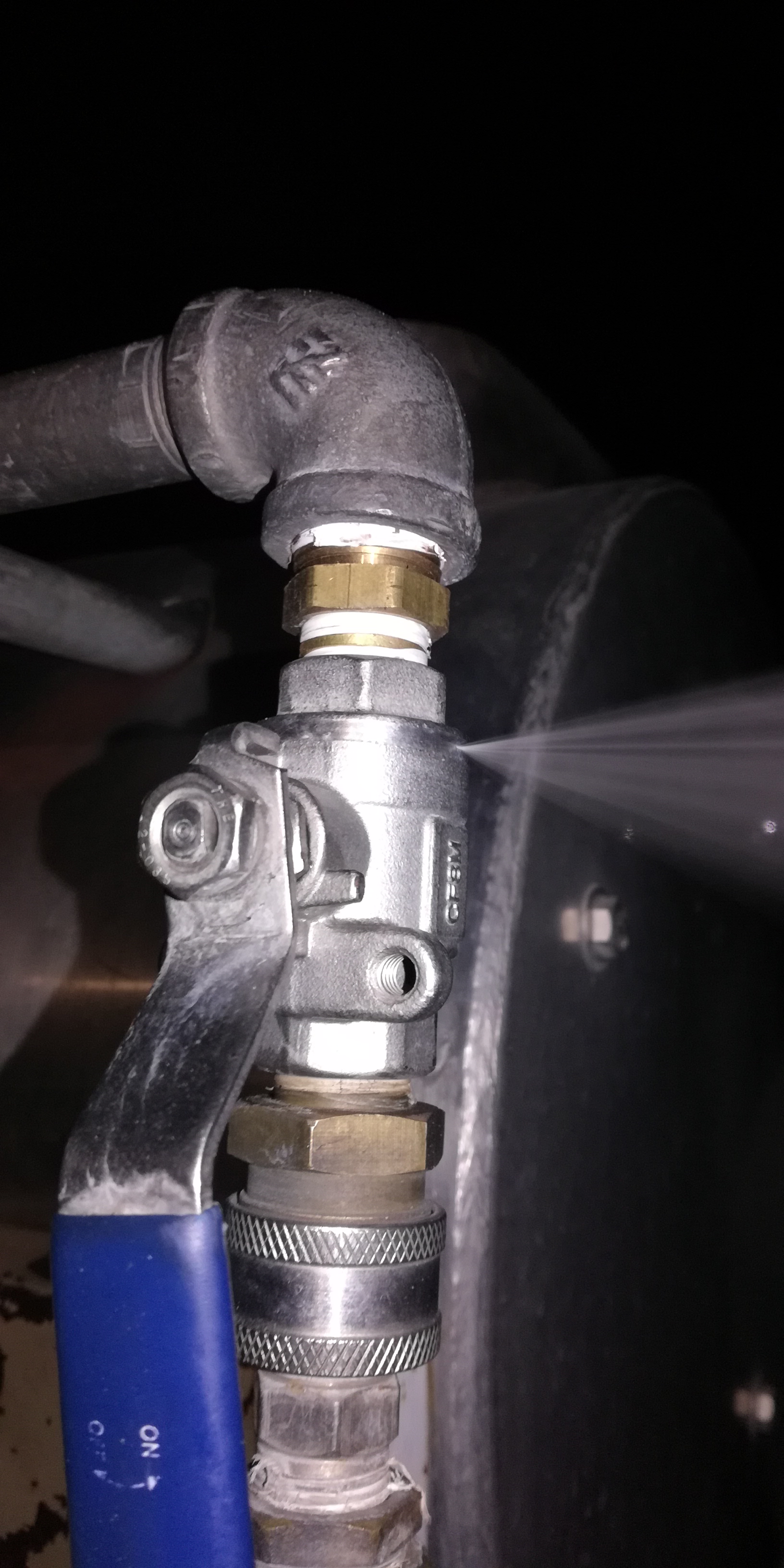

How on earth you get a leak there? Crap casting? Looks like a vertical crack.
There was a parting line there. They spun it and friction welded it so you can’t replace the seats. It got really thin there.
