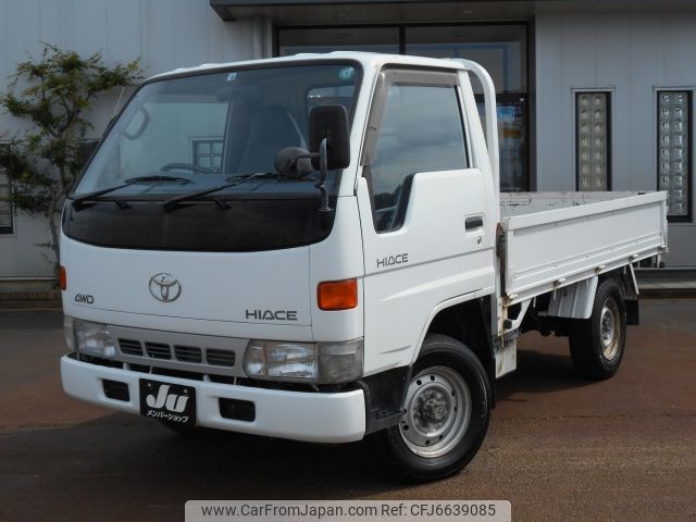

This is probably more my speed (granted, one tonne won’t get me much further in terms of water hauling capacity, but I’ve always wanted one of these):
A Toyota Dyna would probably make (slightly) more sense. Restricted to importing only 25+ year old vehicles here in the States, though.

If I rebadged it with Isuzu NPR emblems, think anyone would notice? … @MuscleMyHustle :laughing::laughing::laughing:
Side tilt as well, I can’t say I’ve seen that before, pretty cool. I can’t get behind your rebadging of a Toyota Alex! It needs to be the other way around can’t mess with Toyota’s lol. Wife panicked and made me sell both of mine when Covid hit, I’m salty about it. She called it unnecessary transport, I call them Toyota’s.
