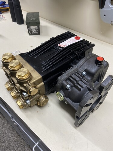

I have read you singing the praises of udor pumps for awhile now, are they that much better than a general pump? I was looking at buying a 6gpm hot water unit, SS skid, big fuel tanks, honda engine and gen pump for 5450, but I wonder if the general is junk (ier?) now.
Lol what’s general pump??
Yes, the Udor pumps are better. No, General pumps are not junk. Either will serve you just fine. When you get to a point where you’re too busy to deal with minor pump repairs then you can slap an Udor on essentially forget about it.
I’m a firm believer in buying the absolute best. There are guys that believe that general is a decent pump. They are guys that believe that general and udor are built in the same factory. I know it isn’t and they aren’t. But, I don’t buy their equipment and they don’t buy mine, so I guess it doesn’t matter. I have never heard of a general pump with 5k hours and no rebuild though.

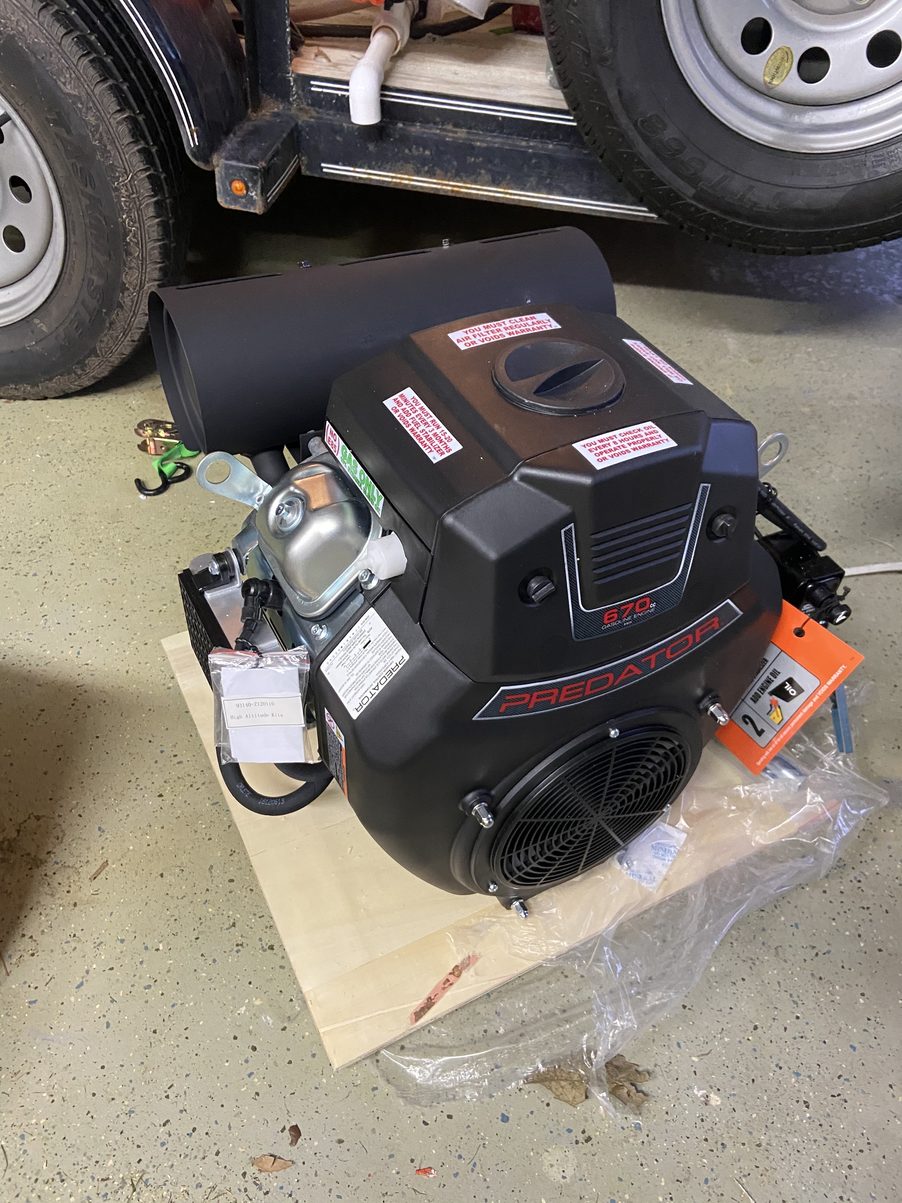

The grump is pretty persuasive yes ? Good purchase dude, congrats !
Well grump would say 1 outta 2 ain’t bad lol. Get with @SchertzServicesLLC if you already haven’t heard about the fuel pump. Again congratulations man !
I’m diggin it , did the muffler come with it ?
Yes the muffler comes with it. Unlike most hondas lol
@bluewave18ft i want to say @SchertzServicesLLC used a briggs and stratton fuel pump on his predator. Im sure if you search predator fuel pump it will pop up. Or just pm him
