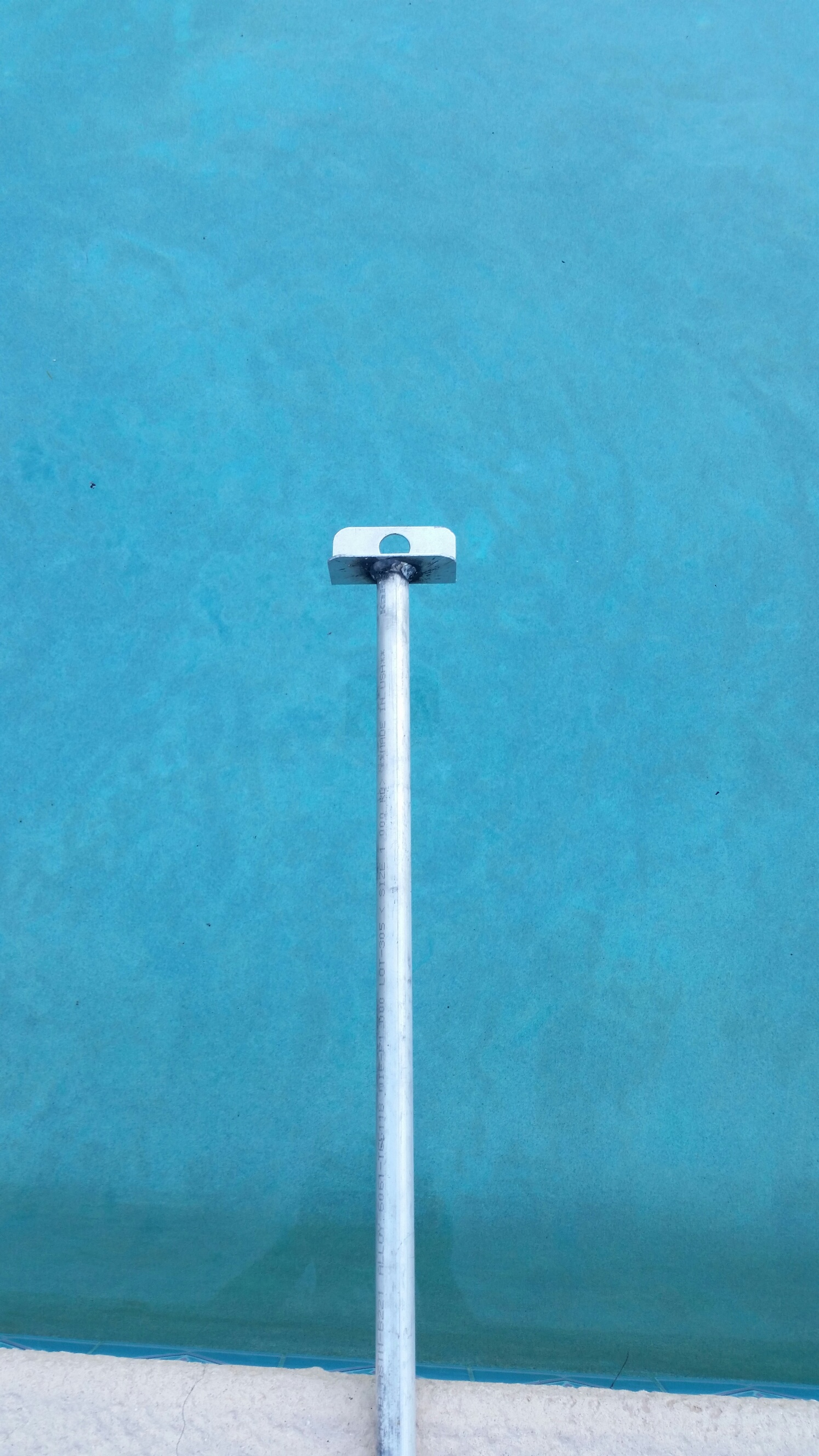

I drop 3ft aluminum pipes down vents. But I don’t consider it much of a safety thing. I do it because our contract requires us to be tethered to the roof with a harness. And that satisfies them.

I put these on my roof.
I pulled back the ridge cap and nailed them right into the rafters with 4 nails on each side. With 4 opposing nails on each side they aren’t going anywhere. It’s been about 4 years and no rust either.
