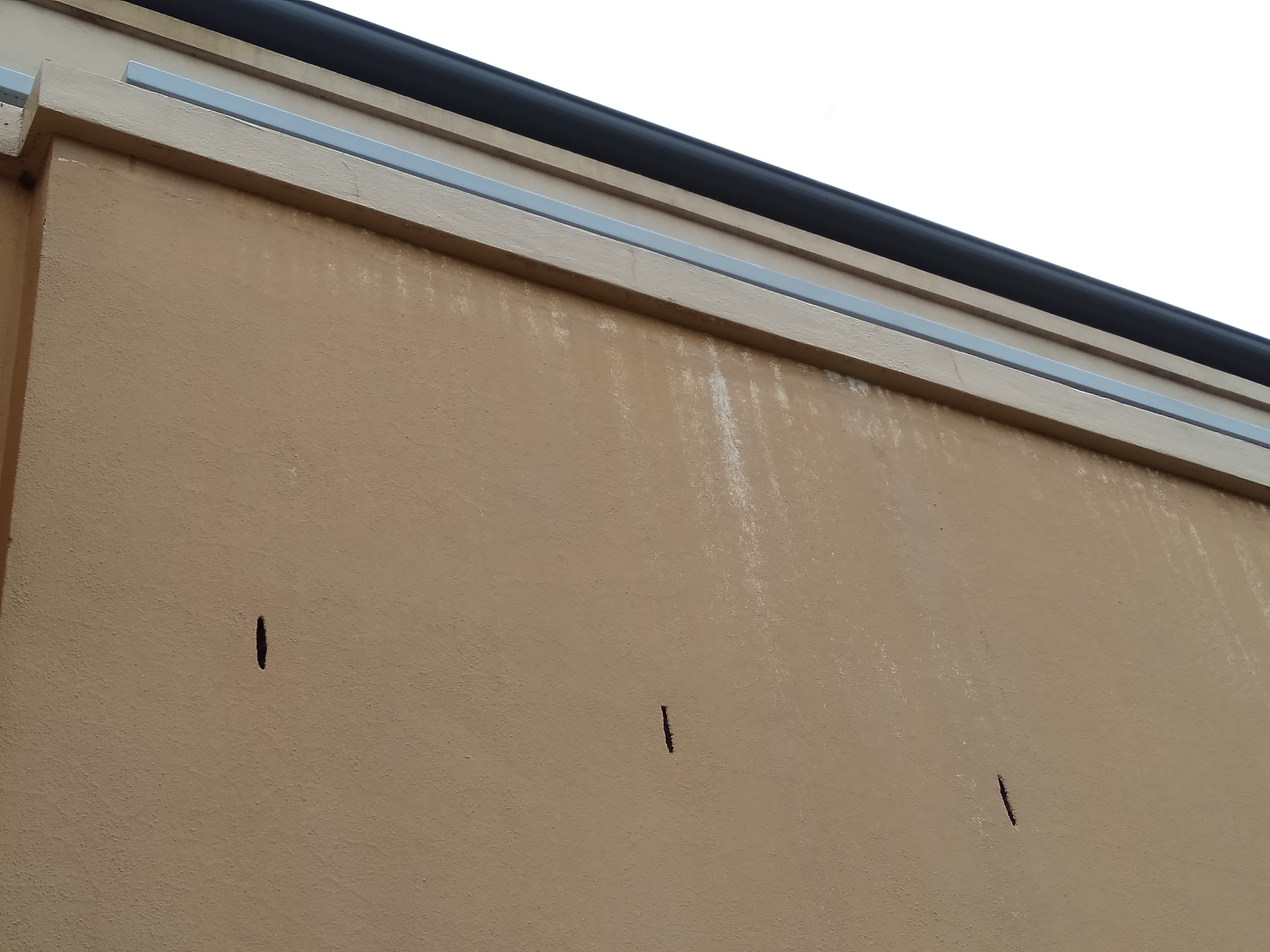

Streaks on Stucco, thoughts?

You typically should not need a brush

So I did the job today with the help of a friend. Pre treated it with around a 3-4% mix, let it dwell, agitated it with a stiff bristled brush and then rinsed it. My friend was on the hose keeping the plants wet throughout. Some of the paint was removed in the process. I don’t know if that was because the mix may have been too hot or possibly me agitating it with the brush. Anyway I showed the owner and told her there had been the some paint removed in the process (when I quoted she did say they were likely going to repaint and wanted it clean for that) so she didn’t appear to be concerned. What can I do to avoid this next time? Or does this happen from time to time? Could it have been something to do with the paint?
Some paints aren’t designed to handle bleach, they can soften and run. Using the brush on the softened surface surely didn’t help it adhere. Why did you agitate it? Did it not come off with dwell time or were you ā€œhelping it alongā€ by scrubbing?
I was a bit gung-ho, just the classic thought process of ā€œI’ll hit it with my chem and then agitate to help it alongā€
Depending on what they painted it with and how much the coating has degraded over time it might have done that with just the wash… BUT in future I’d probably refrain from scrubbing unless absolutely necessary. … like after a few applications with appropriate dwell time and still not seeing the results.
Yeah I was too focused on getting it removed asap. Hopefully she pays up and there are no issues.
