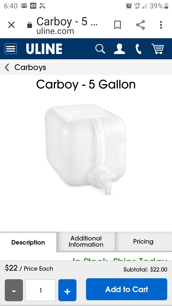

also what kind of tank is that?
They call it a carboy @wap2dem
