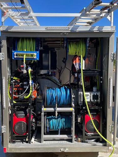

Built this from scratch and tried to absorb all the good advice and some of the not so good on this forum. It’s at least paid for itself multiple times in the last 12 months. Never let the fear of being bad at something stop you from trying it
