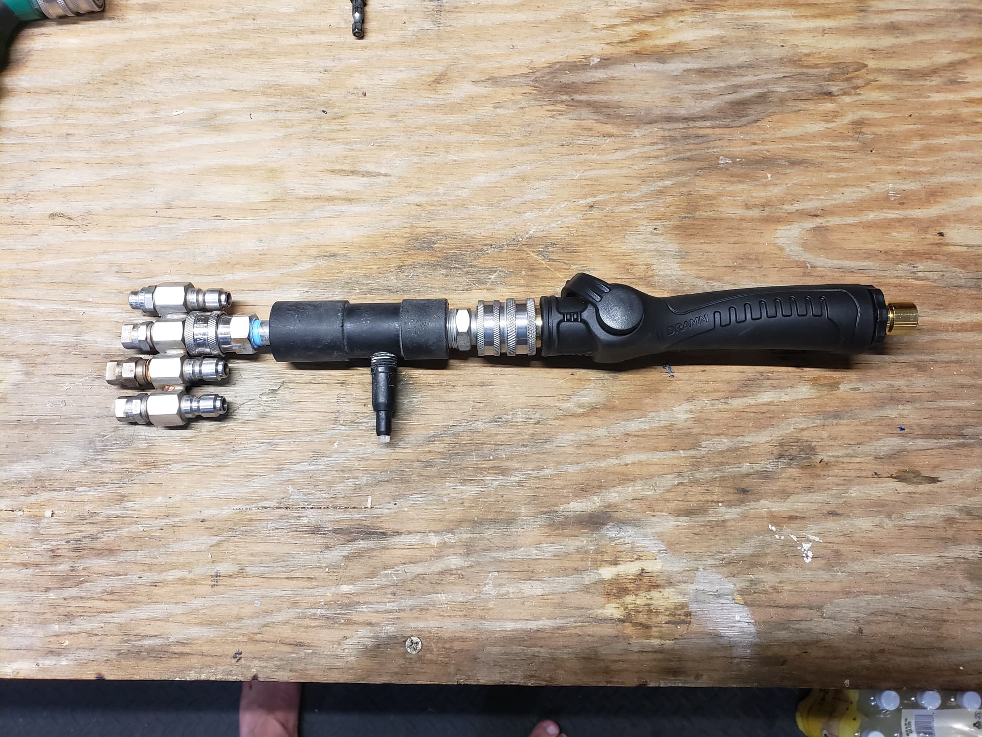

No foam cannon for me, I use this gun that connects to a gallon jug and I downstream it this way. For only doing residential is very efficient since I don’t need to carry a pressure washer or tanks. Just my homemade booster system to spray this gun at about 90-100 psi.

Ok then I was misinformed I thought the foam canon was like an attachment that just made foam come out instead of a steady stream. See this is why I ask these questions
Ok perfect so that gun that connects to a gallon jug how can I replicate this build? If i’m not having to carry around a pressure washer or tanks this is exactly the sort of starter information that could get me off the ground and running!
